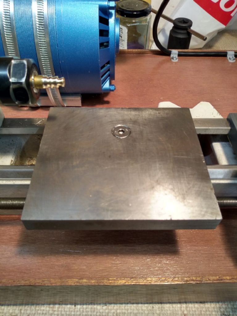

        Well I was really interested by this thread and thought it would be nice to have something like this for my little Unimat. I didn't want to fit it on the Myford because the toolpost doesn't get moved off that unless I really can't avoid it since all the tool calibration would be wrong. Unfortunately the official versio won't fit such a small lathe, and having just made a tangential toolpost/holder I thought it might be neat to make my own miniature version.
        I found this nice steel plate with the two faces turned flat and parallel in the material I inherited from my dad – very dirty and a few dings but cleaned up nicely. Clamps to a bar under the bed with a csk M6 bolt. I thought that I'd need to mill a vee slot on the underside but found that the small flat on the top of the "prism" of the front bedway is co-planar with the real way.

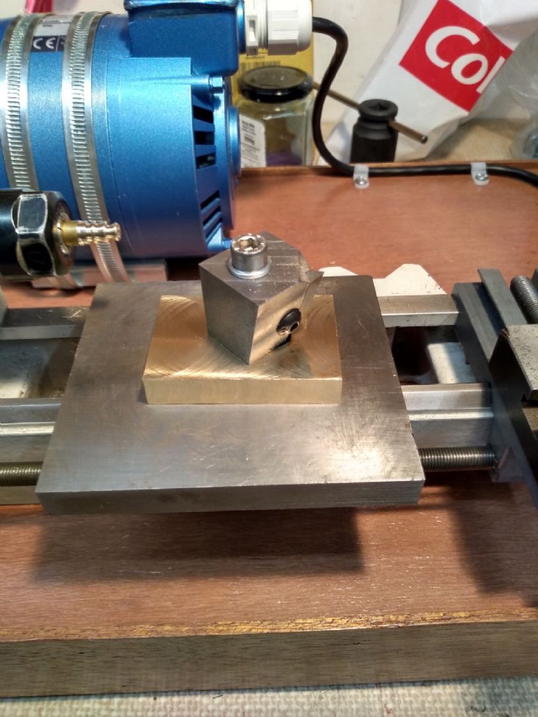

        This is the tangential holder bolted down to a 1/2" brass block, also found lurking in the scrap box and machined all over, and down to a thickness to bring the tool tip easily to centre height. Brass slides easily on the steel plate. Note that the block projects under the tool tip so there's no tendency for it to tip when cutting.
        First attempt at turning a bit of brass rod (after sucking up all the swarf).
        So I feel slightly bad about copying at least the principle of Gary's design but couldn't have bought one to fit anyway. I can feel a pen coming on…

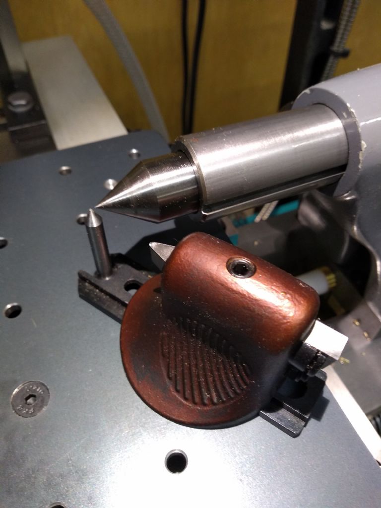

                            Just read this thread as I'm just setting up mine, particularly interested in Andrew Moyes post (I've send you a PM Andrew) regarding an alignment tool I quote… I also turned up a vertical pin to fit in the holes in the bedplate. That enables the tool to be aligned with the centreline of the lathe when ball turning and allows the tool to be set to the radius of the ball.

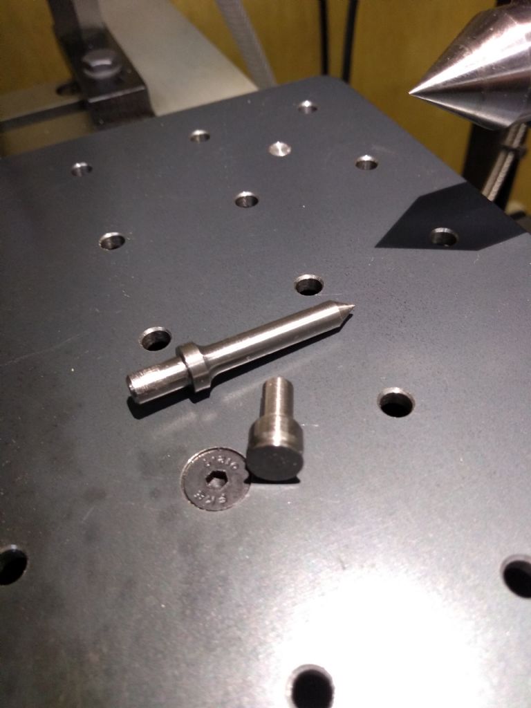

                              img_20200405_112518924.jpgimg_20200405_112415097.jpgHere are some photos of the centring pin.

                                So you align your vertical pin with the tail stock centre. Then measure between your pin tip and the tool tip for the required radius, adjusting as necessary the sliding shoe screwed to the base of the tool holder right?
                                Cheers
                                Chris.
                                #462491
                                Andrew Moyes 1
                                  @andrewmoyes1
                                  Yes, that's right. When you have aligned the centres, if you want, rather than advancing the cut freehand, you can use the crosslide feed. Align the centres, set the crosslide dial to zero and wind out the tool. Then you can start turning the ball and advance the tool using the crosslide until the dial goes back to zero. I found it’s important to lock the crosslide before each cut because you are pushing the tool into the workpiece and against the pivot pin. Otherwise the backlash in the crosslide feedscrew will catch you out.
