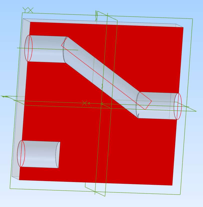

              Jason –
              It was that disappearing trick that was driving me up the wall.
              I’ve just used some of my smaller drawings to examine these toggle tools more closely – and to try to work out how I created one or two of the models.
              Then took this one and nearly improved it. It’s not intended as a part design but is among several created as system diagram elements; this one representing a change-over valve. The inclined passage (the switch itself) is a bit mis-matched because I could not quite visualise the result, but at least it’s the right shape. A sweep might be tidier. Screenshot 2026-09-10 001835
              Incidentally this symbolic valve and its companions are intended for documenting vacuum-brake work I am installing on my club’s loco driving-truck. The system is not quite as straightforwards as first seemed.
              #864365
                A sweep would give a tidier junction where the diagonal hole meets the one sfrom the ends.
                Good job it is only symbolic otherwise I would be asking how you drill the diagonal hole. 😁
                But good to see you have got the hang of it and its another tool you can use, just don’t leave it too long between sessions and forget how it works. Good tool for the drilled steam passages in a cylinder block.

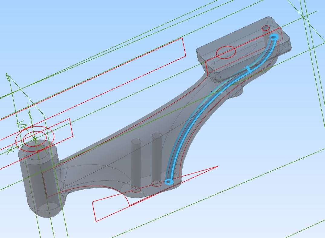

                I’ve just had a part 3D metal printed that has a long snaking air/steam passage that was created using a swept cut that you would have had difficulty casting using a core a sit is only 2mm dia.

                  Thank you!
                  If I was to make that valve physically, without 3D printing I’d have to drill the diagonal passage from the side of the block then plug the opening. An old technique, and I think a lot of the older miniature engine designs simplify it further by making all the passages at right-angles, although that reduces the efficiency in steam and i.c. engines.
                  The other way of course is to make the block in halves rather like the illustration, but this introduces the problem of making a reliably leak-proof joint over a large area.
                  It is too easy to draw something that is too difficult to make as drawn, whether draughted manually or by CAD…

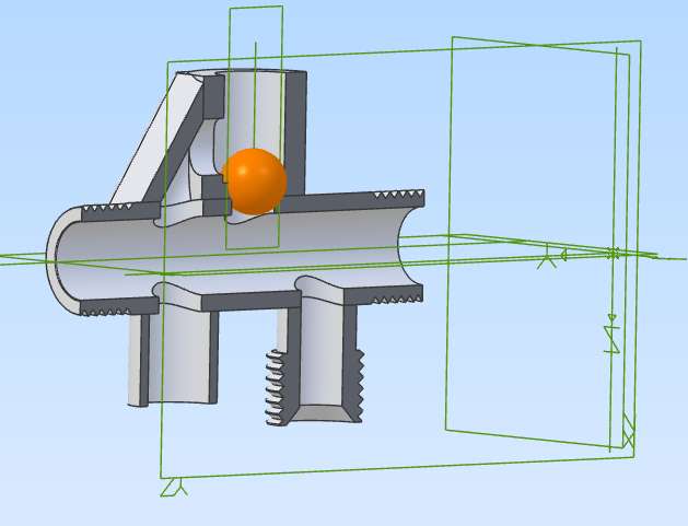

                  Nigel Graham 2
                    @nigelgraham2
                    I’ve had another go at drawing the entire injector body, on the strength of the above.
                    I must admit I am very impressed by D.A.G. Brown’s ability to fabricate these things to his design: the overflow channel is a tiny piece of brass tube with a slot along its length, and its upper port a needlessly awkward “oval” .
                    I worked from an enlarged photocopy of the page in the book, as the original drawings are very small and hard to read in places.
                    As well as an Alibre exercise this investigates a slightly less elegant version potentially easier to make (should the Muse take me). The sloping overflow conduit is now machined from thick brass plate, and the port is an ordinary drilled hole of similar cross-sectional area. It’s all still five bits of brass soldered together but it may be feasible to make the complete overflow body in one piece.
                    The “threads” are not helices; just patterns of an annular groove prettified with tiny fillets. They are though, very close in scale to the specified 5/16″ X 32TPI thread. Eventually I twigged using the Mirror tool and an auxiliary plane to copy them from one end to the other, to save plotting them again. (I decided to omit the internal threads in the overflow outlet and valve body, for now anyway.)
                    I’ve not yet drawn the screwed cap. The original drawing is difficult to interpret and like the rest of the set, a mix of binary and vulgar fractions. (As were my words, at times.) Nor the cones I would expect would “simply” be rotary extrusions.
                    I still find it hard to choose the most appropriate plane for starting the part sketches, making the assembly stages a lot more awkward, which is why they all upside down here.
                    Screenshot 2026-09-24 225947
