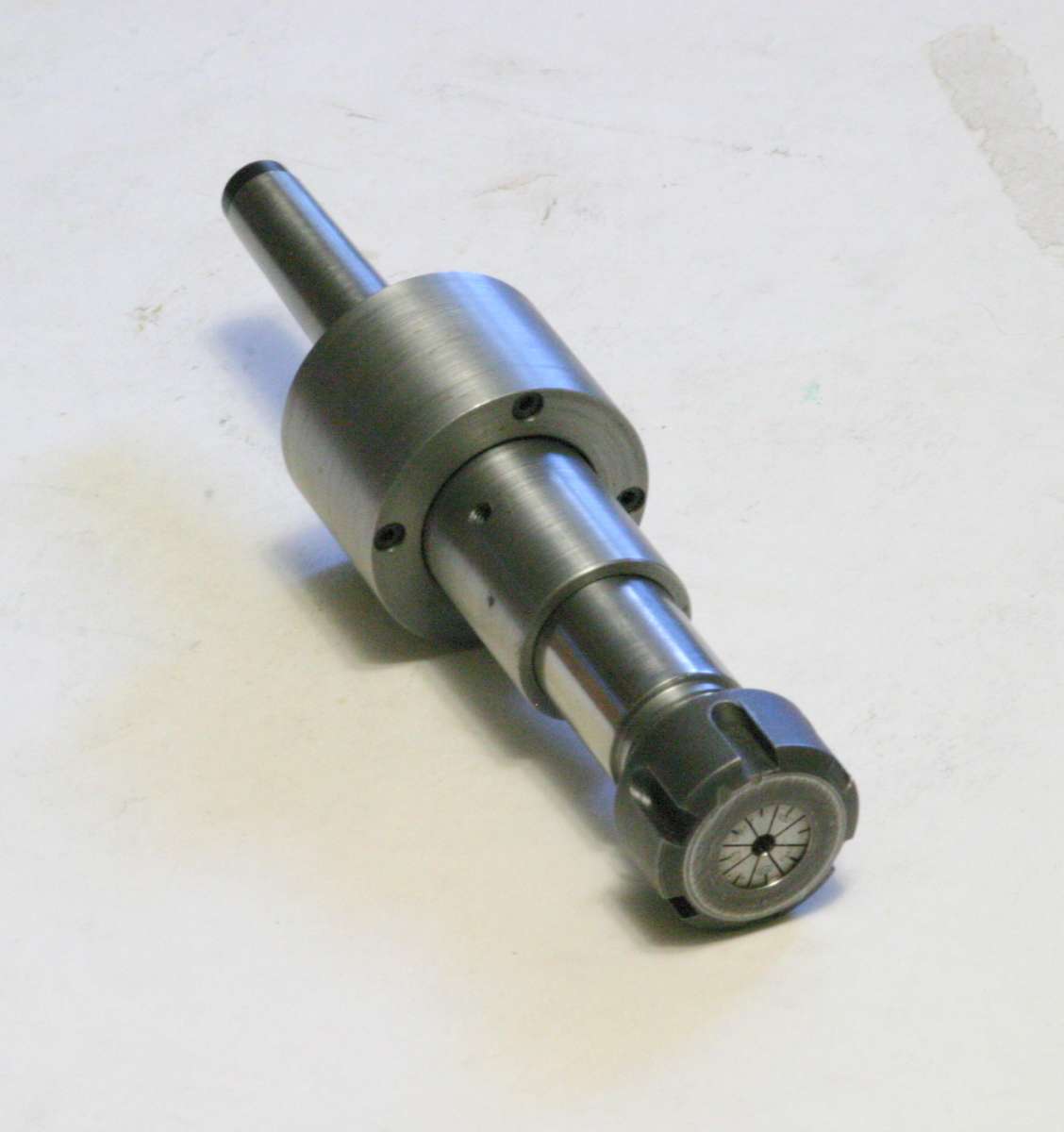

                                      #863709
                                      John Purdy
                                        @johnpurdy78347
                                        Roy
                                        I made the Hemingway one a good many years ago and use it every time I ream a hole in the lathe that is within its capacity and find it perfectly satisfactory. I did make a modification to it to use  ER 20 collets as the shanks of chucking reamers are all of odd sizes (at least mine are). It’s actually the tool holder from my Quorn.
                                        One point on using it, because it droops due to the floating nature, to start reaming you have to move the end of the reamer up to, and register in the start of the hole before starting the work rotating. Then as the work starts rotating immediately feed the reamer in quickly.
                                        reamer

                                            #863894
                                            Roy Vaughn
                                              @royvaughn26060
                                              Thanks for the replies on the floating reamer holders.  The Hemingway design with ER25 chuck seems OK then but John, your warning about floppy-ness got me thinking about inertia and the effect it and friction might have on the small reamers I use, down to 3mm in aluminium and CI. A smaller ER11 version might be more appropriate, will have a think about that.
                                              Roy
                                              #863904

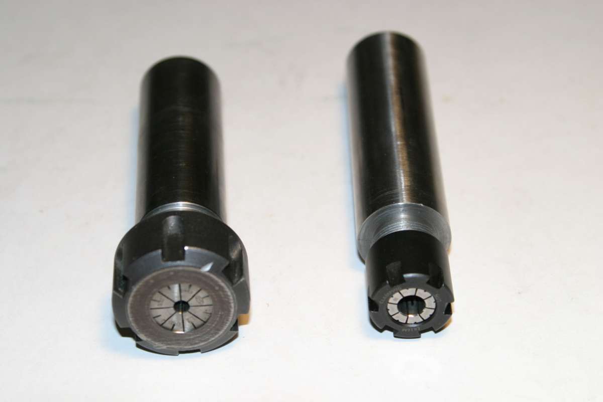

                                              John Purdy
                                                @johnpurdy78347
                                                Roy
                                                I have used mine with reamers down to 3/32″ with no problem, that’s with the ER20 collet. I have since made an ER16 collet holder for the Quorn which would probably be more appropriate for the smaller reamers, definitely weigh less. I would also shorten it so it didn’t hang out so far, no need for it to be so long with the shorter reamers.
                                                You can see the difference in the mass between the ER20 and ER16 holders, ER11 would be lighter still.

                                                  Roy Vaughn
                                                    @royvaughn26060
                                                    Thanks for the pictures John.  I’m convinced, I have to make one.
