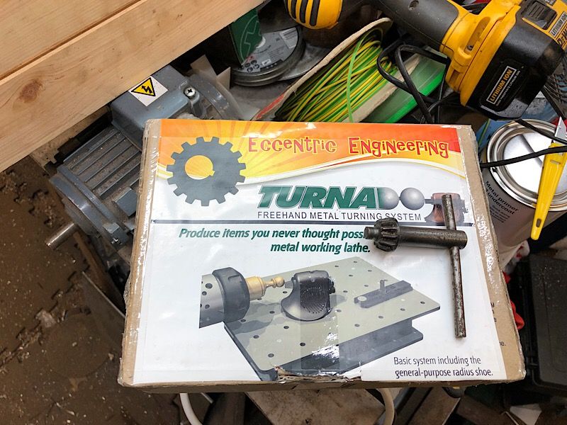

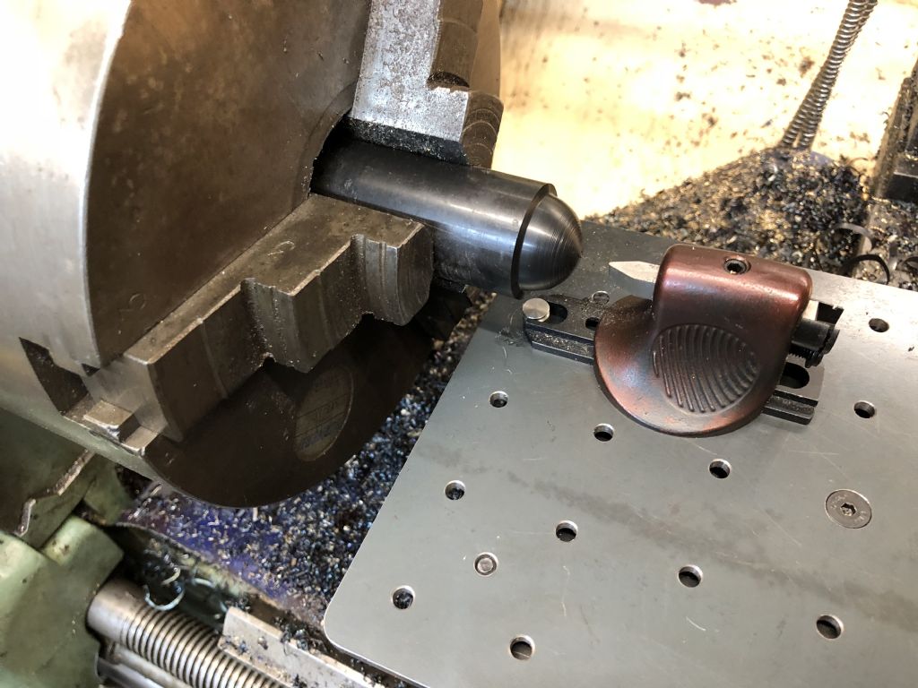

                                              My Turnado arrived today and what a great piece of kit it is
                                              The toolholder is indeed a thing of beauty

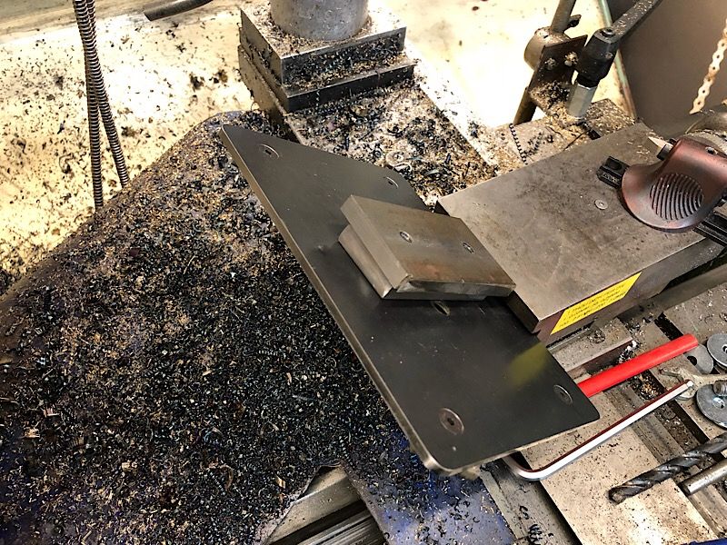

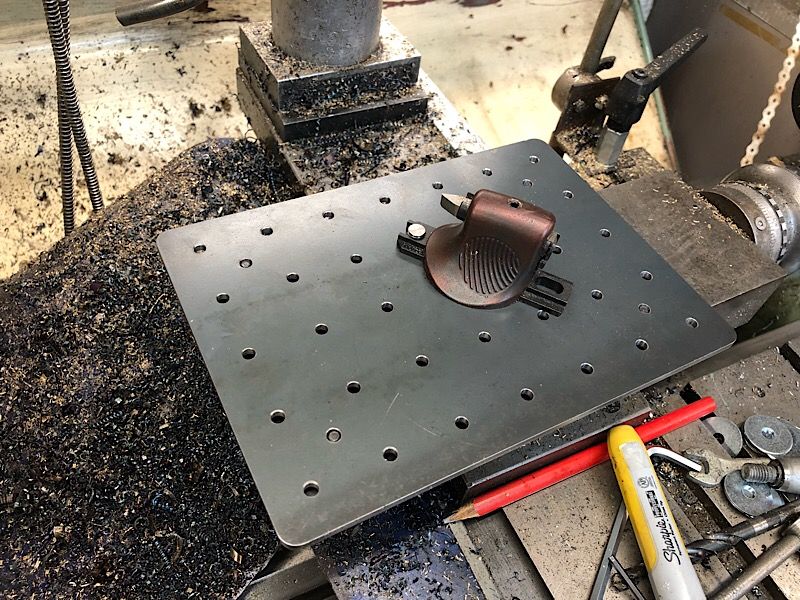

                                              My lathe is a colchester 6.5 inch CH so to fit it i made a flange like the toolpost has so its really quick to fit just 2 bolts to tighten and its on.
                                              Then the pillars wanted shortening to only 6.5mm so a rethink was called for …i replaced the pillars with 25mm squares of GFS 6.5mm thick tapped a central 5mm hole and used the original bolts …bolt 4 of these on and the bolts protrude just enough to locate the top on
                                              The central one i made a 6.5mm plate bolted on the bottom plate and the original screw screws into the plate
                                              First quick tests worked well on some 30mm dia black nylon

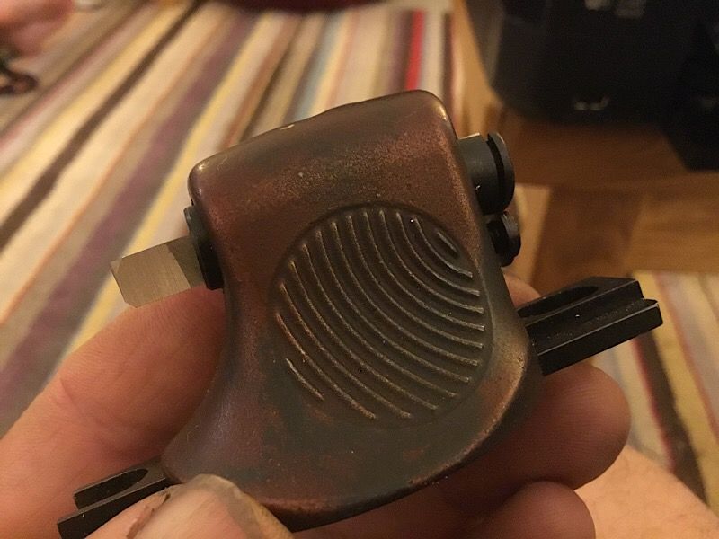

                                                I complemented Gary on the choice of colour, and he confided in me that they just came out like that!
                                                It is a lovely example of the patternmaker's/foundryman's art.

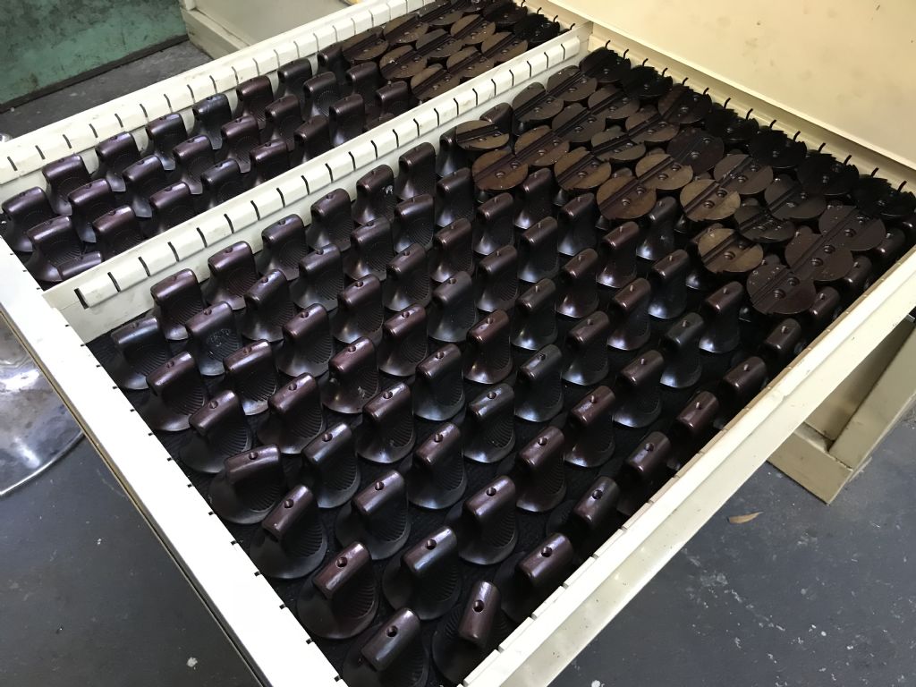

                                                  Posted by Neil Wyatt on 19/07/2018 19:33:45:
                                                  I have no objection to the colour, but I'm a little bewildered: The toolpost block is said to be made from investment cast Ductile Cast Iron. … So, why is it not grey ? [glazed by residue from the burnt 'wax' perhaps ?]

                                                    I had never realised that cast iron would come out of the mound looking like this …die cast yes but not cast iron…I cant imagine what causes the colour

                                                      Just thought I'd clear up a slight misunderstanding about the brown colour of the Turnado tool posts.
                                                      They don't come from the casting plant like that; after I machine them I send them for a black oxide surface treatment and that's how they come back.
                                                      Steel turns jet black in a few minutes but for some reason cast iron only goes a deep brown, and that's only after they leave it in the bath for up to an hour.
                                                      I suspect it might be the lack of carbon in the cast iron that causes it but that's only a guess.
                                                      I really like the finish, it's almost an oxblood/ aged bronze colour.
                                                      Here's a few I prepared earlier smiley
