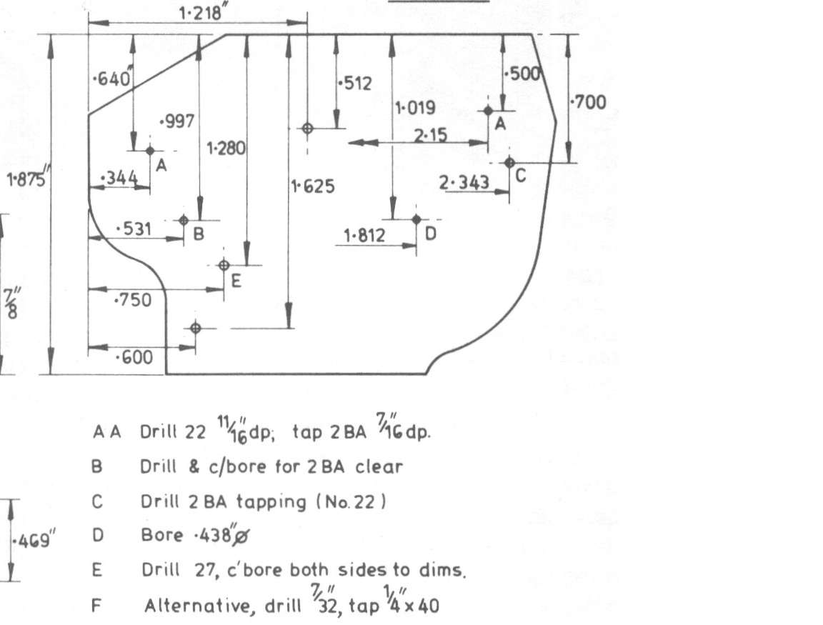

    ega
      @ega
      I bought the kit from the late Neil Hemingway but have only recently plucked up the courage to start the build. In his Workshop Manual (1992 edition) GHT said that, apart from the gears and leadscrew which come with the kit, the parts are not difficult to make, but I think I took fright when I saw the Double Elephant size drawing! I know that one or two members have successfully completed the RTS and hope for some help with the drawing of the body as shown in the extract below:Untitled
      Holes A to E are shown and listed in the table but two holes on the drawing appear not to be listed and I am not clear about hole F. The unlisted holes have coordinates of 1.218/.512″ and .600/1.625″; one of them may be F.
      Can anyone who made the RTS throw any light on this? I am reluctant to think that GHT slipped up and appreciate that I may be misunderstanding the drawing.
      Incidentally, apart from Neil Hemingway’s business being taken over on his death, it now appears to have passed to Messrs Reeves and I don’t suppose they could help at this remove.

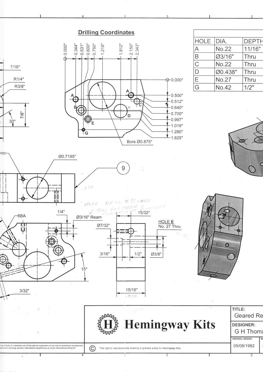

      #862726
        A lot of the Hemmingway stuff was redrawn in CAD, Reeves may be able to help with a more upto date drawing. You can see the CAD drawing here https://www.hemingwaykits.com/HK1240
        Failing that what mates with the two unlisted holes?
        #862727
        ega
          @ega
          JasonB:
          Thank you for your advice and for the link which, however, seems to show only drawing 1 of 6, the GA; I will try Reeves – happily, they are still with us!
          I did consider your fallback suggestion and may have to have another go at this route. I also thought about just diving in but am reluctant to start cutting metal without having a clear path to the finished product.

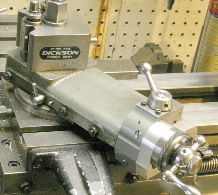

          John Purdy
            @johnpurdy78347
            I made mine about 15 years ago and looking at my drawings they appear to be different. On mine your hole .6/1.625 is listed as “G” and the other is the centre of the large .875 dia hole. see the attached drawing. Hole”F” would appear to be the one on the curved surface as shown on the drawing below at the botom left.
            IMG_0004
            IMG_0005
            IMG_0003

            bernard towers
              @bernardtowers37738
              my drawings are the same as Johns and the RTS has been working fine for the same period, I would suggest you use the drawing John has scanned. Dont forget that the drawing keeps getting inverted and rotated this can be awkward as there are quite a few dims in a small space. Well worth the trouble though IMHO

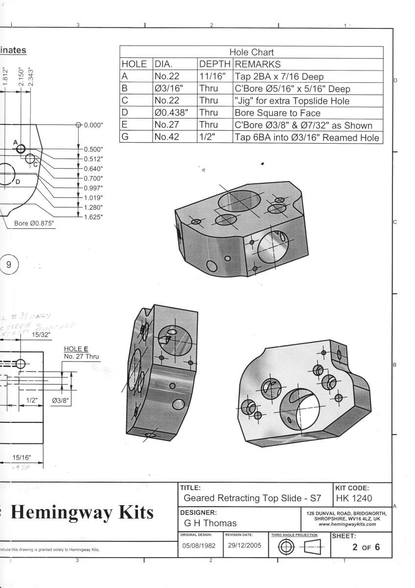

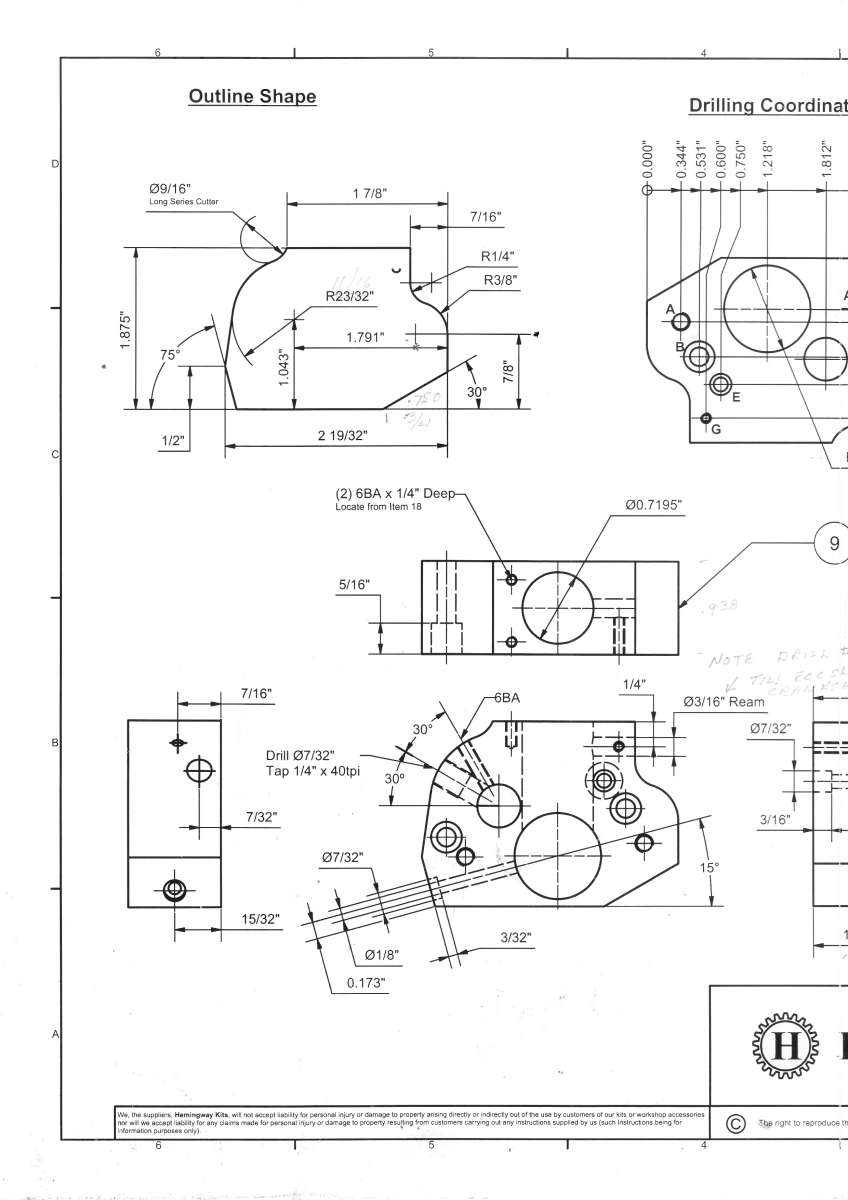

              ega
                @ega
                Gentlemen:
                Many thanks indeed for your help. It looks as though I shan’t have to trouble Reeves and can now start cutting metal.
                My large drawing is no WE23 from MAP Ltd and appears to be identical as to content to the drawings in GHT’s book. Interesting to see how the CAD dimensioning method differs from the traditional. I was initially puzzled by the double headed arrow of the latter.
                Jason pointed me to Reeves’ website where there is a photo of the finished RTS; whoever made it seems to have set the bar rather high! I shall be happy if I can get mine to work.

                John Purdy
                  @johnpurdy78347
                  Hole “F” by the way is to allow access to the eccentric bush that one of the gears run in to, using a small pin, to rotate it to adjust the backlash in the gear train. After adjustment the bush is locked with the 6BA set screw just above hole”F”. I agree with Bernard, it is well worth making, makes screw cutting so much easier and faster. One thing I have noticed on mine ( which may be my manufacture) is that the over lock on the forward motion of the slide is not sufficient and it tends to move back if bumped. The use of GHT’s slide lock mod to the top slide works to stop it from moving.

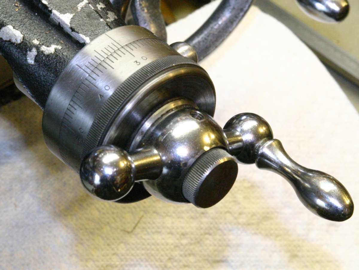

                    John Purdy
                      @johnpurdy78347

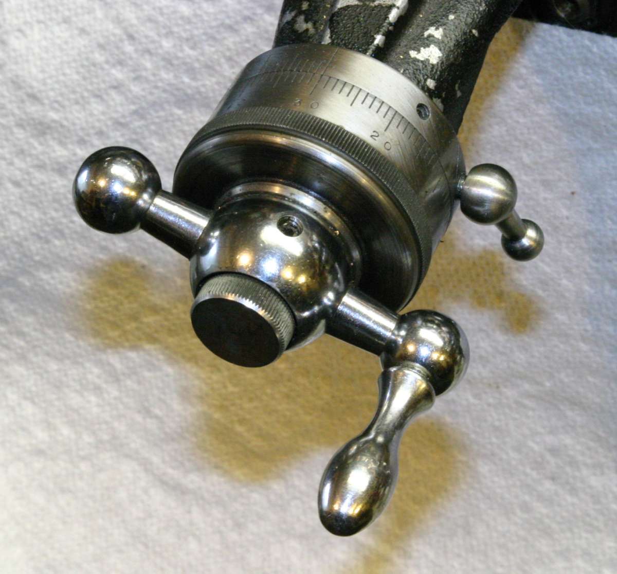

                      Another advantage is the much larger feed screw dial, now graduated in thous instead of 2 thous, with its ability to be unlocked and reset easily without fear of the the top slide moving.

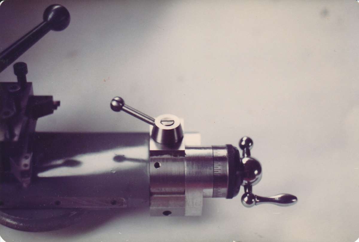

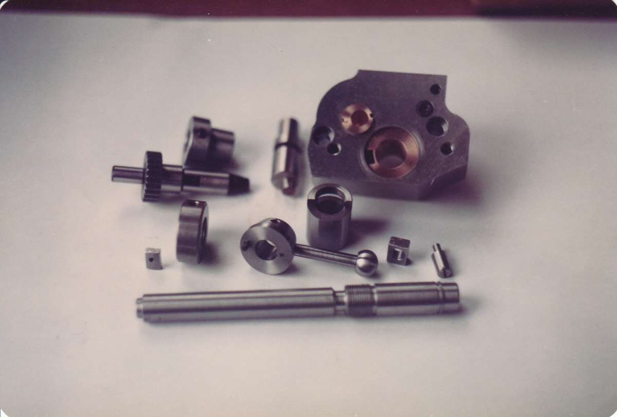

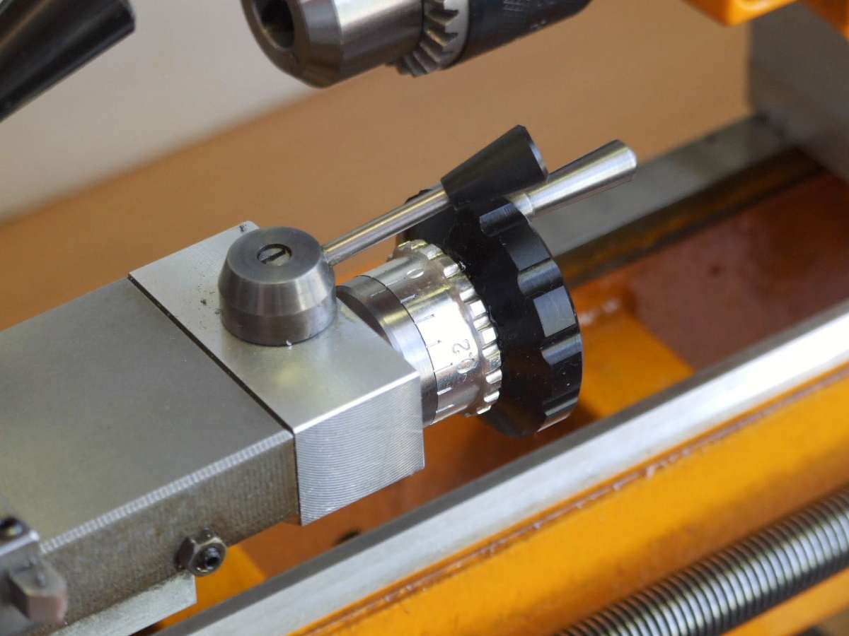

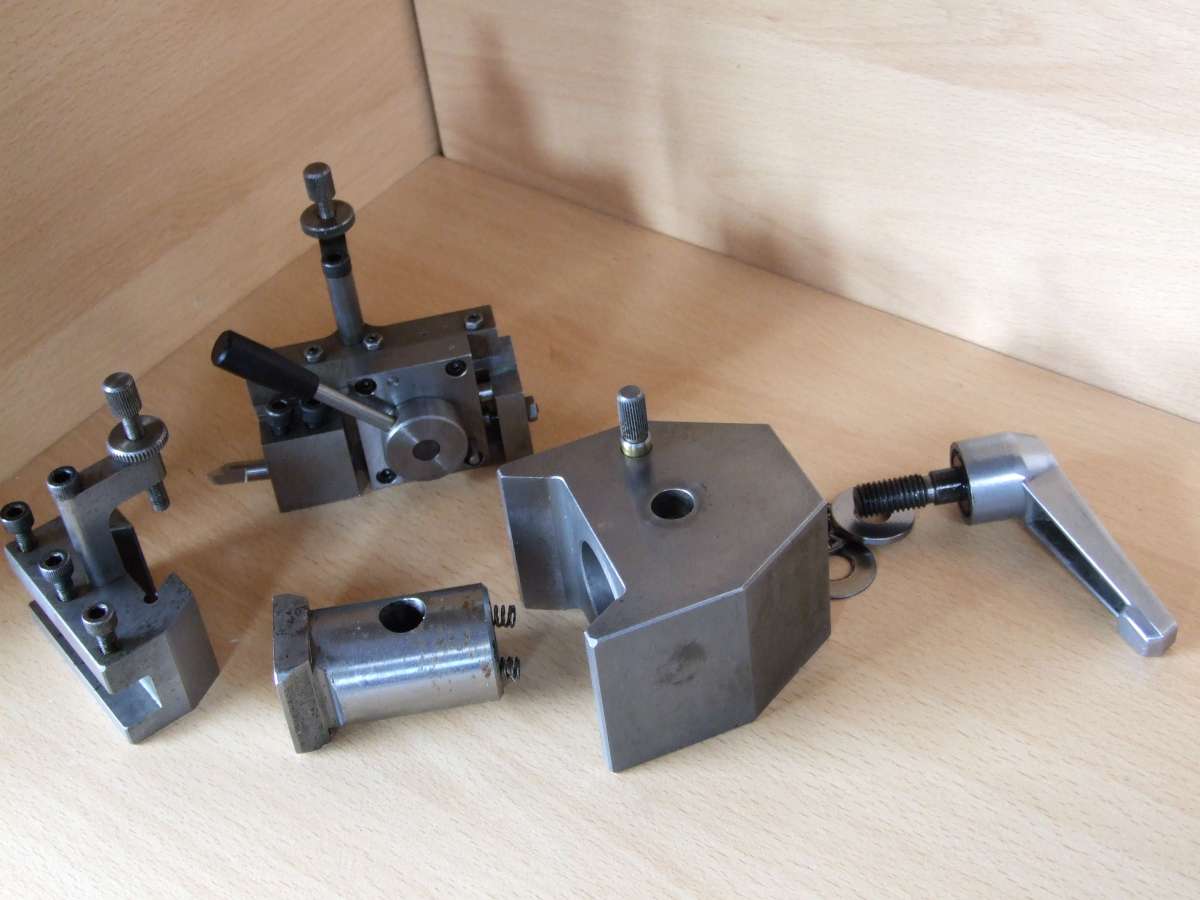

                                      I remembered I took some photographs of the finished slide and the parts,
                                      RT Finished
                                      RT Component parts
                                      They are not very good photographs, this was early days for me when it came to Photography.
                                      Regards
                                      Gray,

                                        Thanks for the photos. It does look neater without the stop plate. GHT was also one for improving the designs of others.

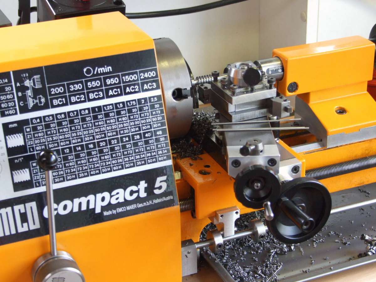

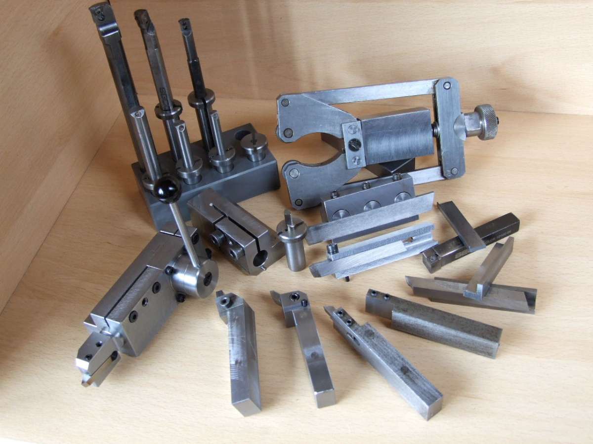

                                          I did make a version of GHT’s RT Toolholder for use on my Emco Maximat Super 11, but the proximity of the chuck jaws when working close to the chuck, caused me to have a rethink.
                                          Fig 8 Dis-assembled Interchangeable tooling
                                          Fig 7 Associated Maximat tooling
                                          I now use another version of GHT’s RT,
                                          c5 retract John Slater Fig 1Attachment fitted, note larger Dial Photo 1
                                          The RT in action 10 TPI LH Photo 8
                                            I notice that your knurling tool also seems designed to save fingers from the chuck. Does it have the same sort  of range as the more conventional variety?
                                            What would you say is the current equivalent of the Emco?

                                              @johnpurdy78347
                                              Ega
                                              Yes, the top slide is unlocked to use the retract feature and any time the top slide is used to put on a cut. At all other times I keep the top slide locked.
                                              When it does move if bumped it is a positive direction, ie. the tool moves away from the work so is not a real problem, just a nuisance. One of these days I will take it apart and see if I can make the over centre lock more positive.
                                              Shortly after making it and seeing how good the dial resetting was, I made the mod to the cross slide dial according to GHT’s words and music ( to quote LBSC). Didn’t use a Hemingway kit for this one just material I had using GHt’s workshop book and his original write ups in ME back in Nov. ’77. Bought the thrust bearings from a local supplier. Resetting the dial here is even easier and more positive than on the top slide as the lead screw itself can be locked with the small lever on the right side preventing any movement of the cross slide
                                              Cslide1
                                              Cslide3

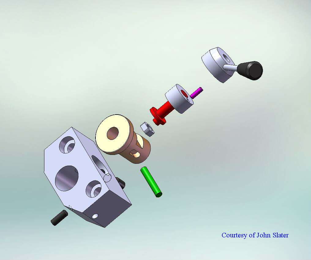

                                                    Hi Ega,
                                                    I am sorry to say the 3D views of the Knurling tool from John will not be possible. John died just before last Christmas. Although he and I never met we corresponded regularly for over 20 years. His passing has left a big hole in my life. He very often helped me out on projects, for ME&W as well as Home Shop Machinist. He would often send me down numerous “Rabbit Holes”, all of which added to the learning and design.

                                                      I can understand your regret at losing a long-term friend and collaborator; for years I corresponded with a fellow Willson lathe user in New Zealand and miss his wisdom.
                                                      3D views were a feature of Hemingway Kits under their last owner and I wonder whether Reeves will take the same approach to new additions to their catalogue.
