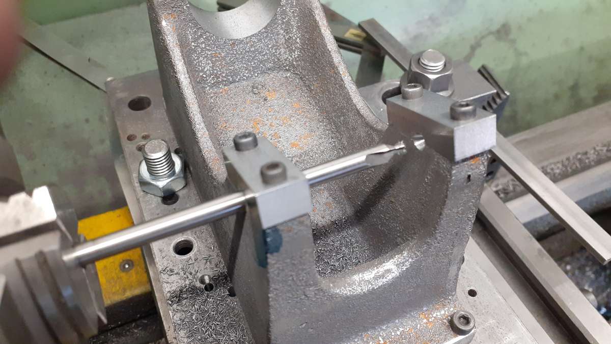

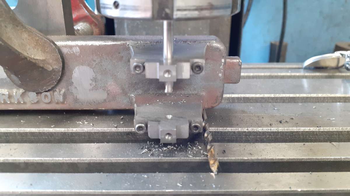

                                                    #830460
                                                      The picture I could not lay my hands on yesterday. Long spot drill in this case. Note I have also cleaned up the inside face of the bearing support so I am not drilling into a cast surface or have a step where the cap is a different width to the bed casting.
                                                      Photo 10
                                                      20240303_150040
