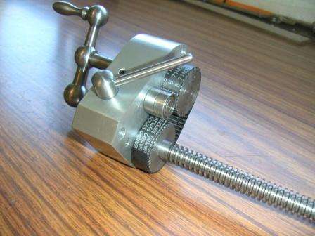

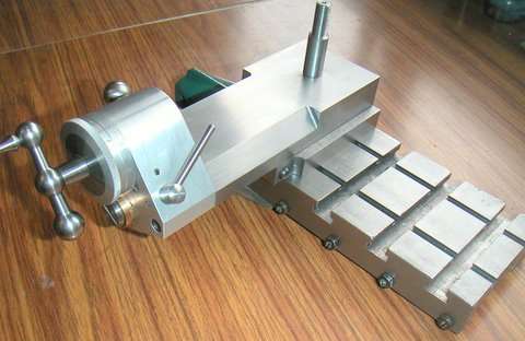

        Here is my version of a retractable topslide for a Myford lathe. It uses a 9mm wide toothed belt drive and can be retracted from zero for internal or extenal screwcutting.  Its operation is very smooth and backlash free. Twin ball races are used to adjust the belt tension for zero slack.
        Alan
        Toothed belt retract 2
        Toothed belt retract 1

          Alan Jackson:
          An ingenious solution to backlash ans direction of travel problems!
          I recall the Stepperhead being described in MEW (?); did you go into details about the retraction mechanism which is presumably eccentric-based?
          I am now committed to GHT’s design but you never know what might come along in the next life!
