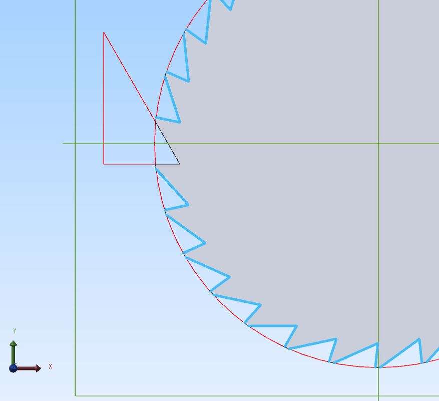

      I call them teeth as it is not a gear. I need to cut what I best describe as a saw tooth to make a ratchet wheel which I will cut using a 60deg cutter, My question is if the drawing states that the diameter of the PCD needs to be 7/16″ would my calculations be right that I need a 15/32″ diameter piece to start with.

        I think ratchet wheels take the PCD at the crest of the teeth so 7/16 blank.

          #864172
            Did you see my edit. as they take the pcd as teh OD tooth count won’t matter.

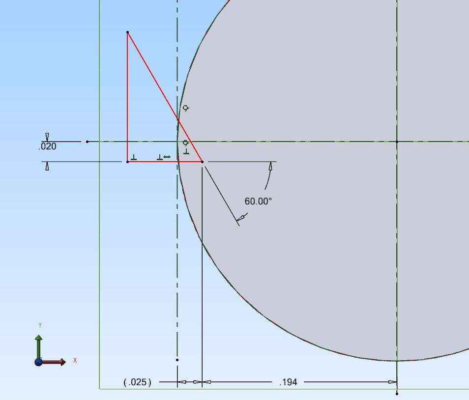

              #864174
                If it helps I get 0.025″ cut depth which leaves a very small flat top to the tooth when I set the cutter 0.020″ below ctr line

                  I did wonder if I should leave a small flat on top of each tooth, and you answered that before I had chance to ask it. Thank you for the other info on depth of cut and the 0.020″ below centre height. Will be getting the devviding head out and set up tomorrow hopefully.

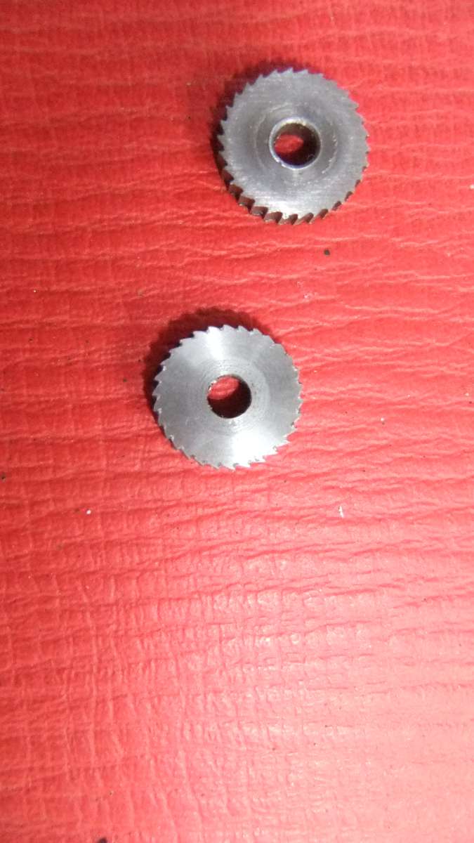

                      Managed to cut 2 ratchets I think the top one is the one I will go with. I had to cut them a little over the 0.025″ depth
