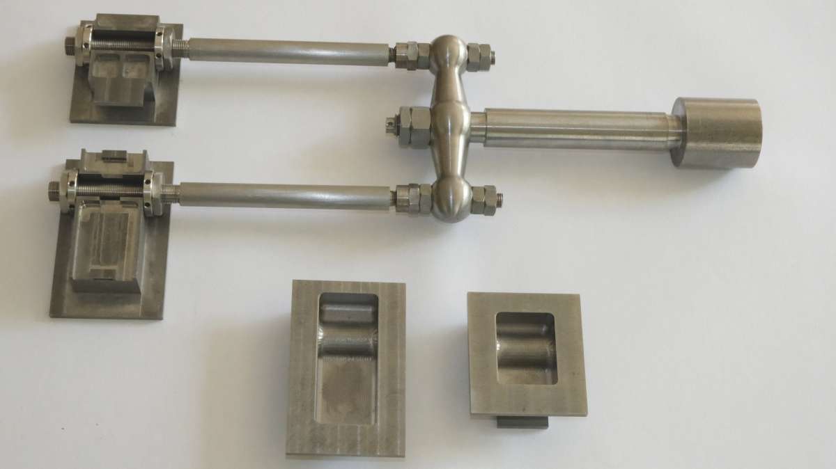

                    Julie Ann
                      @julieann
                      I recently had issues screwcutting a 2″ long 5/16″ x 32 ME thread on 303 stainless steel for slide valve rods. First rod screwcut fine but the second rod was a disaster. In the end I bought a new die and mounted it in a sliding die holder in the tailstock. The die cut a lovely thread under power at about 40rpm. Given the stainless steel I used Rocol for lubrication. Before threading I machined the stock to 5/16″ diameter with no concious effort to be undersize. The die came from Avon Engineering Supplies:
                      https://www.avontapdie.co.uk/me-5-16×32-split-die
                      The valve rods and slide valves assembled:
                      Slide Valves and Rods
                      Julie

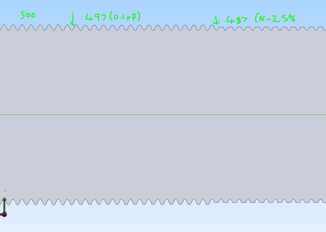

                                Do be very careful if taking Dave’s advice to reduce Nominal by 2-2.5% as that does not take into account thread pitch so is a bit Duff. Although his suggested dia is correct it bears no relation to the percentages he mentions.
                                Most manufacturers suggest a reduction based on the pitch, typically 0.1 x thread pitch. This becomes more critical as the pitch becomes smaller and/or diameter increases as you will end up with a very weak thread as it will not be full depth. Also be aware that a lot of round rod can be undersize to start with so may not need reducing.
                                See bottom of page 258
                                So for your given thread of 5/16 x 32 the pitch is 0.031″ so diameter should be reduced by 0.003″ giving 0.310 as your starting dia.
                                Useful chart with the reduction done for you but not listing ME though you can interpolate other threads with similar pitches.
                                See page 267.
                                #821112
                                  As an example this is a section through a 1/2″ x 40 TPI ME thread.
                                  Nominal dia on the left, reduced by 0.1 x p in the middle which is hardly any loss of depth. But on the right we have Dave’s  (SOD) reduction of 2.5% off nominal.
                                  I’ll leave the  reader to work out the consequences of applying the suggested 2.5% of Nominal reduction to some of the constant pitch thread, anyone for M40x1.0 😯
                                  The situation can be made even worse if you start using larger tapping size holes for the mating female thread as the combined lower engagement percentages can give very little engagement.
                                  duff
                                      To be pedantic, the advice is Tubal Cain’s not mine!
                                      I submit the approximation is a reasonable Rule of Thumb, and Jason is fussing over a minority case!    Though adjusting diameter by percentage becomes dubious for extremes like 40TPI, it works well enough on common thread sizes, metric and imperial.  Calculating from pitch is more work, especially with Imperial threads.
                                      The following pitch example is ⁵⁄₁₆” X 32ME.
                                      • Imperial threads are specified by TPI, making it necessary to first calculate the pitch.   Not difficult when you know how: 1/TPI (pitch in inches).  1/32tpi = 0.03125″
                                      • Calculate diameter reduction from pitch × 0.1  Here 0.03125″ × 0.1 = 0.003125.   Practically, 3 thou
                                      • Convert the imperial fraction size into the decimal equivalent:  5×16″ = 0.3125″
                                      • Therefore, target diameter is 0.3125″ – 0.003″ = 0.3095″
                                      The pitch arithmetic suggests reducing to 0.3095, whereas 2.5% rule of thumb is 0.30469″ or 0.30625″ at 2%.  If tweaked to 1% when cutting fine threads, % reduction suggests  0.309375″, which is the same as Dormer.
                                      Practical note – when guesstimating the reduction, the start diameter should be as specified for the thread.  Imperial and Metric stock is often ‘nominal’, so measure it first!  That ⁵⁄₁₆” rod might be 8mm metric.  Or vice versa.
                                      A practical factor favours percentage reduction slightly.  Cutting tends to raise burrs and squidge the thread so they’re a shade bigger than expected.  This is probably why John got a good result from 2.5%, even though as Jason says the advice is a bit duff for 32tpi.  Oversize shows up mostly in malleable alloys like mild-steel and the softer Brasses, and is most obvious when making tight fitting threads for maximum strength.   Whilst the maths is good, you can’t ignore the real world!
                                      What the workshop is for makes a difference.  I’m into experimental work with occasional repair, not models.  I rarely make close tolerance threads because home-made cut threads are significantly weaker than rolled screws.  When strength matters, I buy in. My main application is bespoke fasteners, where the thread can be down to 60% engagement without causing problems.     Others take far more trouble, routinely adjusting split dies to get more accurate threads.  Possibly unnecessarily.
                                      Always good to ask, “how good does it need to be?”   My training emphasised that mindlessly pursuing ‘quality’ is an egregious sin.  Professional engineering is about meeting requirements at minimum cost.  The specification and what’s ‘fit for purpose’ and ‘value for money’ are defined in advance. The requirement determines where a product sits between too cheap and high-end, not the builder.  Part of this avoiding ‘paralysis by analysis’, including not wasting time on unnecessarily laborious calculations,   An irony!  We Model Engineers are more likely to commit the opposite error, which is avoiding maths at all costs!  It’s true: I have to overcome my own laziness and stupidity.
                                      However, Model Engineering is a hobby, and we might pursue making the best of all possible objects, time and cost irrelevant.  If the goal is producing a Gold Medal winning exhibition model, then the builder must work to a consistently high standard.  I think most of us have lower requirements, and need not fuss.  But the choice is personal! It’s fun get jobs ‘spot on’ and learning how to excel when needed.  Next time I cut a 40TPI thread, I shall remember Jason!  Next time I cut M10, I won’t!
                                      #821166
                                        Well Dave I don’t know where you read that but I’ll see your pedantry and double it.
                                        My Model Engineers Handbook by Tubal Cain it says “The Bar diameter should always be to size or preferably a few thou smaller”
                                        In the Workshop Series on Drills, taps & Dies he says” 5-10% OF THREAD HEIGHT which may be 2-4 thou” this take sinto account the pitch
                                        And as you say yourself Dave the percentage of nominal is dubious for fine threads that is why both of those when applied to 5/32″ x 32 would give a diameter of say 0.310″ in the first instance and as thread height is less than pitch maybe 0.311 to 0.312 for the second” Both far from the 0.008″ reduction that percentage of diameter gives.
                                        Yes handy that it equals Dormers numbersbut only at that diameter, Dormer would still be 0.003″ at 5/8″ or 1″ OD but 1% would be 6 and 10 thou!
                                        There may be a bit of extrusion but as most ME supplers sell hard brass not that likely. “Perfect” is probably judged by eye and if the perfect thread has fully formed crests then that could also have been obtaine dby excessively closing teh split die which will result in a far from Perfect fit unless you like a rattling good fit. If the OP is using a hole threaded with an equally bad quality tap a sa gauge to the “perfect fit” then all bets are off.
                                        The use of the thread is probably more important than wanting a medal or what size it is. ME threads are commonly used on steam fittings and you don’t want one of those popping out or simply stripping when you come to tighten the joint which will invariably be in soft metals. Daft going into long discussions about 1 thou difference in boiler thickness calculations if all the screwed plugs blow out on first hydro test. Or the big end studs fail when you try and start that IC engine that took you X years to build.
