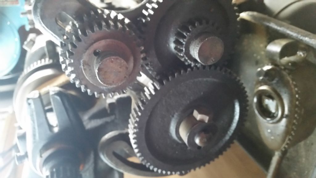

                I have managed to get the lead screw working just fine it was me that was the problem. Only issue with that part of it is that one of the change wheels manages to slowly work its self out. The sort of pin that holds it in place just seems to slide out with change wheel.

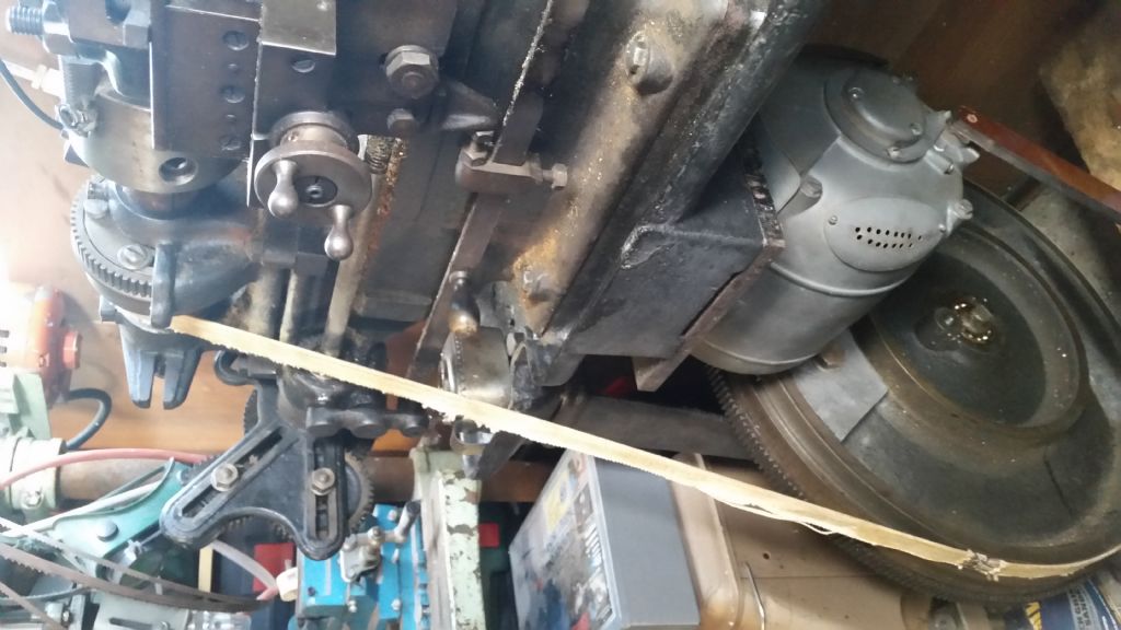

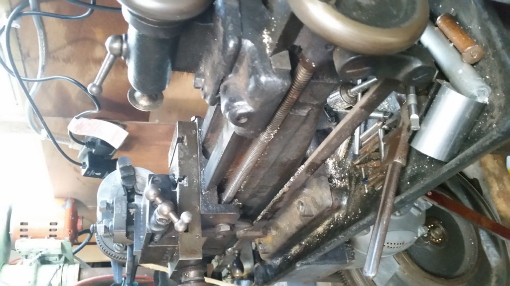

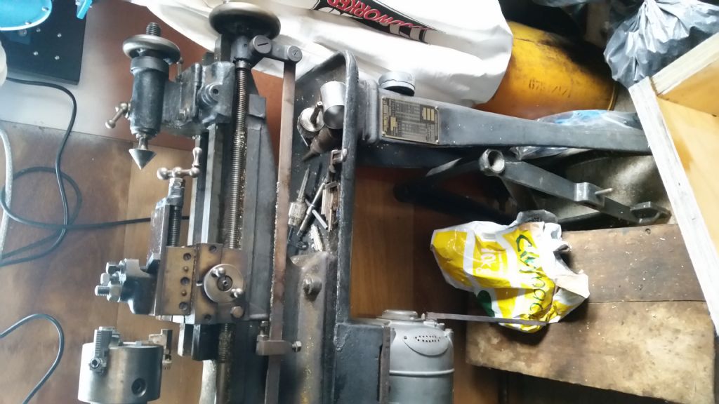

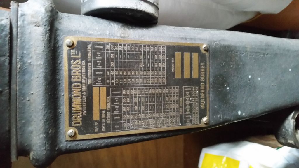

                    Sorry if pics are too big as this is my first time posting pics. Oh and please excuse the state of my shed.

                      Bazyle,
                      I think it's the exposed gear teeth on the treadle flywheel that makes it a "knee grater" when under power.
                      Andy,
                      Really nice, interesting lathe. Those M types are very attractive.

                                  Maybe a bit dumb, but why the gear teeth on the flywheel? Maybe this is not the original FW, but one from an IC engine with a starter ring gear!

                                    The gear teeth are original, if you check out this link on the lathes.co.uk website you'll see about half way down the page the "knee planer". The drive from the motor to the flywheel was by way of the gear teeth rather than a belt, the motor drove through the treadle drive flywheel while keeping all the mechanism in place. I think the "knee planer" idea came from the likelyhood of belting your knee on the motor or it's bracket while you were treadling. Make sure you send Tony pictures of your lathe as it looks to be a rarity being complete.

                                          That's an interesting drive for the motor, I didn't see it that way. Today IF you were to design something similar, you would use a much lighter, modern motor sticking out the other side of the flywheel if you had to do it that way.
