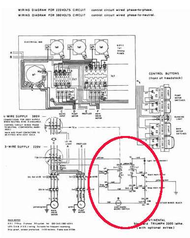

      you have to click into the white space to oopen the wiring diagram

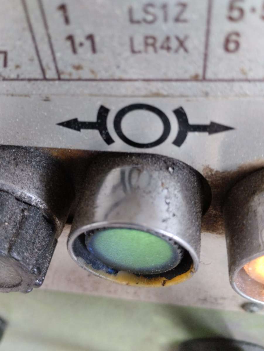

            I think the question of the brake could be clarified here – this button on this lathe, does activate or deactivate the brake:WhatsApp Image 2026-01-10 at 16.08.59
            #832053
            danielcv
              @danielcv
              And here is the diagram where you can see that button as the STOP switchScreenshot 2026-01-11 at 12.03.26

              Pete Rimmer
                @peterimmer30576
                That seems to indicate that when activated it holds the brake off and though it might simply be a handy pictograph the image implies a physical brake.

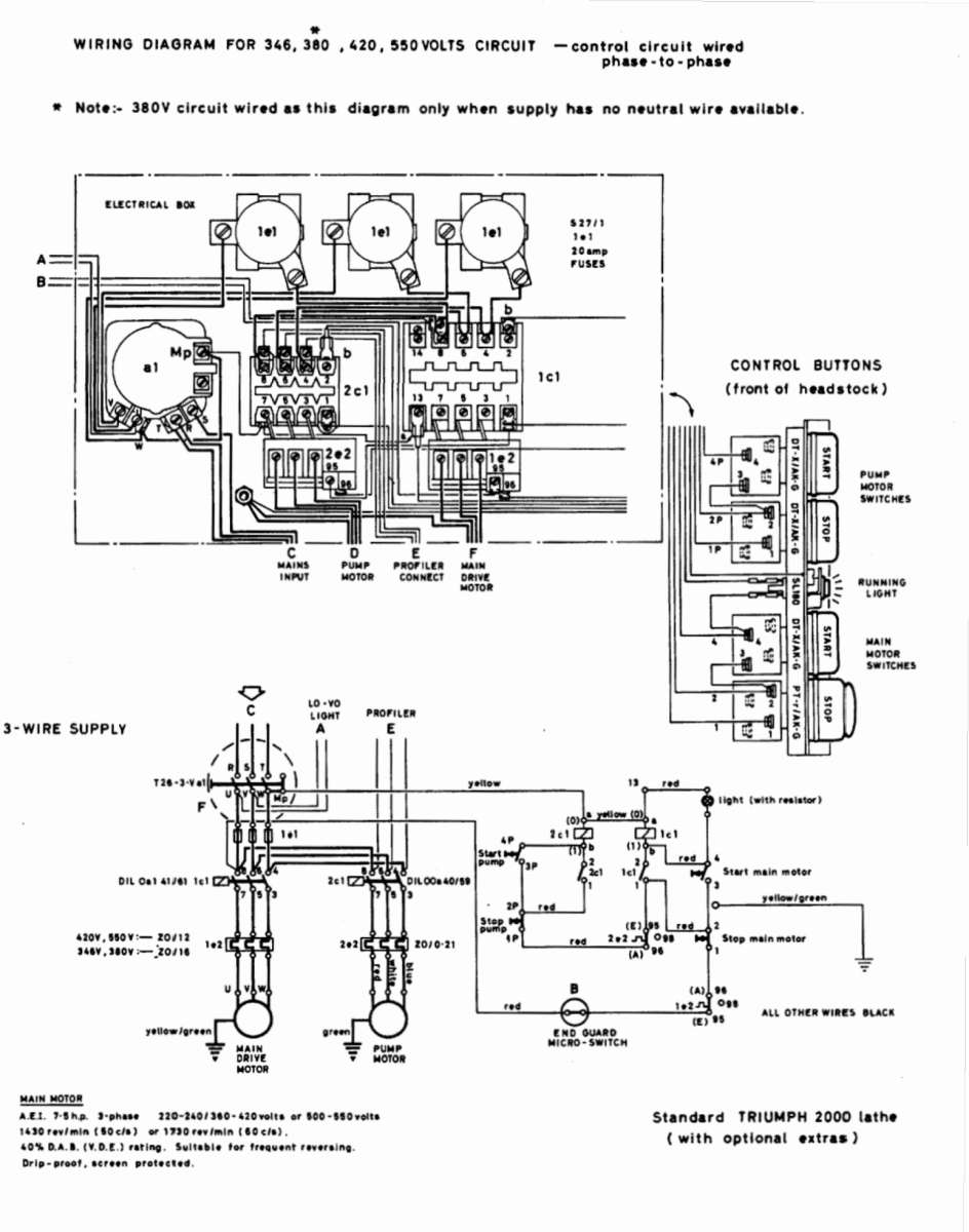

                  The schematics posted by the OP come in two flavours. Both 3-phase power in, but one with a neutral line and one without. For the lathe in question it would be useful to know which variant. How many wires enter the control box from the incoming mains? Mostly likely four wires for no neutral and five wires if the neutral is present.
                  Given that the DC brake circuit has an input of 220VAC I’d hazard a guess that the lathe has a neutral connection.
                  Julie

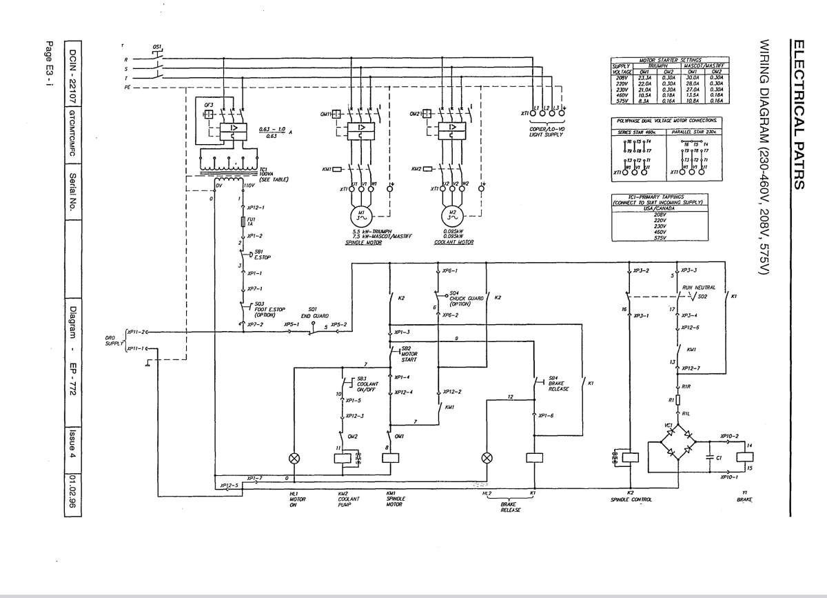

                    There is a wiring diagram here on PDF page 154 (document page E3-i):
                    http://vintagemachinery.org/pubs/182/6092.pdf
                    There is a diode bridge rectifier at bottom right. I looks like there may be a resistor and capacitor also within that item.
                    Has it been tested with a multimeter?

                        The Tony Pete refers to is at lathes.co.uk.    Wonderful source of information and he sells manuals and stuff.
                        Unfortunately the circuit diagrams have been compressed by the internet and most of the text is unreadable.  Can you post the bottom page only, which might solve the problem. or zoom in on the area ringed in red?
                        colchester
                        No sign of a rectifier, but the circuit inside the ring appears to show two single pole relays, purpose unknown because I can’t read the text.  Relays might well be marked 1,2 for the 220vac coil and 3,4 for the switch contact.    If necessary draw the ringed area by hand?
                        I’d wait to see what others make of the circuit diagram and other information.   But, leaping ahead, if the broken part is a relay, it explains why no heat-sink, and why the part doesn’t look like a typical rectifier. (Though it might be.)
                        If we become confident it is a relay then a resistance test with a multimeter should show a highish resistance, say 15000 ohms, across the coil (1&2) and an open circuit between 3 and 4.  Also open circuit between 1 and 3 & 4 and 2 and 3 and 4. These tests are safe.
                        If the safe tests are all good, relay operation can be tested.   DANGEROUS so don’t risk it unless the tester is competent.   I’d wire everything up securely on a bench and apply fused power via a switch to make sure I don’t get electrocuted or burn the house down.    Anyway, applying 220vac to the coil (1&2) should cause a slight audible click and a multimeter between 3 and 4 should go from open circuit to zero ohms.
                        Good news:  relays and rectifiers of the size pictured are both common as muck and inexpensive.  Relay more expensive, about £10.  The problem is identifying what the thing is.
                        Bad news: might be difficult to find an exact swap making it necessary to adapt one.  How to do that is the next issue.
                        Be warned, I’m armchair engineering here.  Never been inside a Colchester, and might be joining the dots wrongly, especially as this one is mysterious.   Wait for those who know the actual lathe to comment.

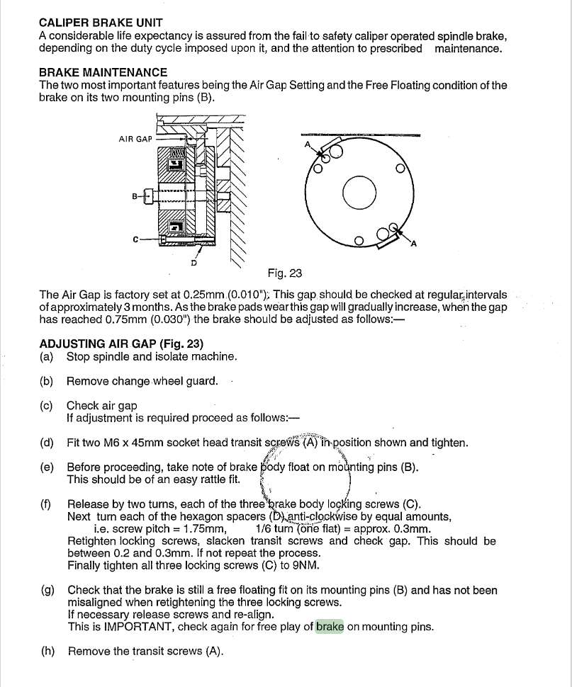

                          Ok so thanks to the manual found by peter1972 above (which thankfully has searchable text) the brake appears to be an electromagnet operating against a spring-loaded brake caliper on a mechanical disk brake.
                          What’s concerning is that it’s said that the brake should be automatically applied when the machine is powered off yet Daniel says that the spindle turns freely. I would suggest following the service procedure on the braking system on page 42 of the PDF and verify that the mechanicals are in good order. It may be that there’s nothing wrong with that diode and it’s simply a matter of the braking system required an overhaul.
                          triumph brake servicing
                          At least we now know that the recifier simply supplies DC current to the brake electromagnet.

                            well, taking the Diagram Mark brought, it shows the rectifier, see picture below, at the bottom right.
                            The other thing is, that the friend told me that: When the part is not connected, the lathe works and turns freely, no brake. When he connects the part, the circuit braker pops.Screenshot 2026-01-11 at 12.41.33

                              The above diagram does not seem to reflect the lathe in question. First, there is no incoming neutral line and second, the control voltage, including the brake circuit, is shown as 110VAC with one side connected to the protective earth. This is a common arrangement, at least on the 3-phase machines I have in the UK. None of them have an incoming neutral line.
                              Until we have a definitive answer as to what configuration the incoming supply is, and what the control voltage is, everything else is speculation.
