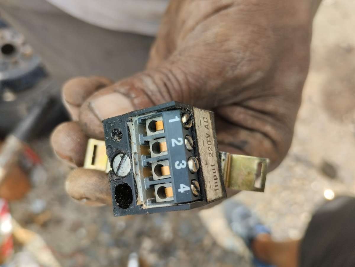

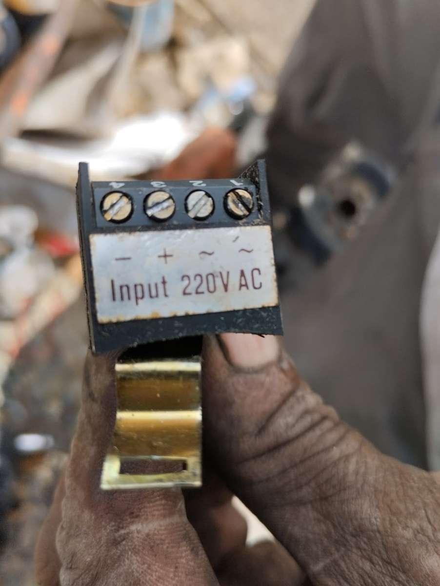

      Hello,
      anyone knows where I can get this, or a compatible bridge rectifier for my Colchester Triumph 2000?
      Thanks in advance,
      DanielWhatsApp Image 2025-12-17 at 12.47.46WhatsApp Image 2025-12-17 at 12.47.43

                    It’s an odd looking package for a bridge rectifier. It’s not clear if the writing means that the input is 220VAC or that the +/- terminals are the input, in which case it probably isn’t a bridge rectifier.
                    Julie
                    #831990
                    Fulmen
                      @fulmen
                      It’s either a rectifier or the world smallest VFD 🙂

                        It certainly doe not look like a 35A bridge rectifier. I’d expect a heatsink for a start. As Pete has said 35A at 220V is a lot of power. Also none of the wiring diagrams in Colchester Triumph 2000 manuals i can find online show any bridge rectifier.
                        We need more information:
                        What type of motor is fitted to your lathe?
                        What is this item connected to?
                        What colour if any are the wires connecting it?
                        Can you post a picture showing it’s clocation and more of the electrics?
                        Why do you think it’s faulty? (I can see one terminal looks a bit over heated).
                        I looks more like a terminal block that has been broken off something else. Maybe a contactor or solid state relay.
                        Robert.

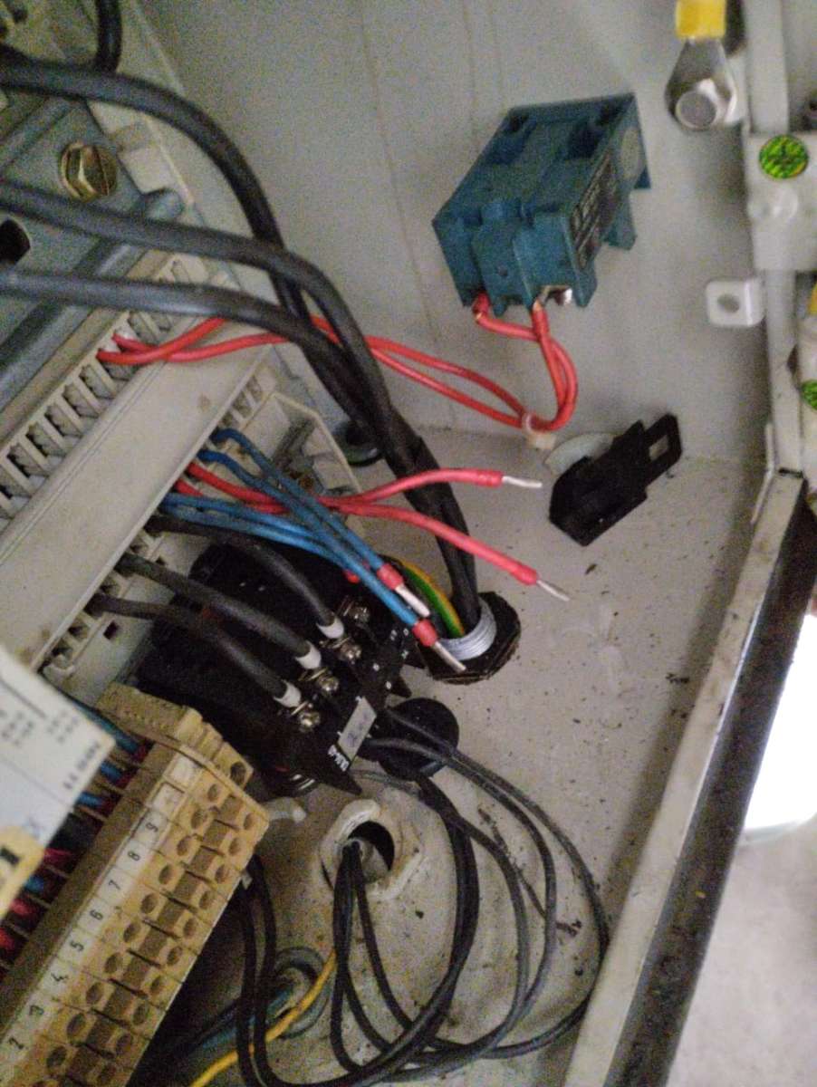

                            Thanks a lot. On monday I will get pictures of the specs and electrics. The machine is in Africa and I am trying to help some friends there.

                              These are the photos I have now, but on monday I get better onesWhatsApp Image 2026-01-10 at 16.05.48
                              WhatsApp Image 2026-01-10 at 16.05.41

                                I think you will find that a 220v supply is switched by the motor contactor so that the dc brake is powered via the diode block. That dc supply energises that brake release coil, opening the brake allowing the motor and lathe to rotate.
                                When stop is selected the contactor contact opens, removing the brake power, applying the brake.
                                Hope this description helps.

                                        Just another note  if it is a brake pack they can often be just a single diode or diode pair not a full bridge. The brake coil just needs some lumpy DC ish power to operate, not a perfect stabilised DC!

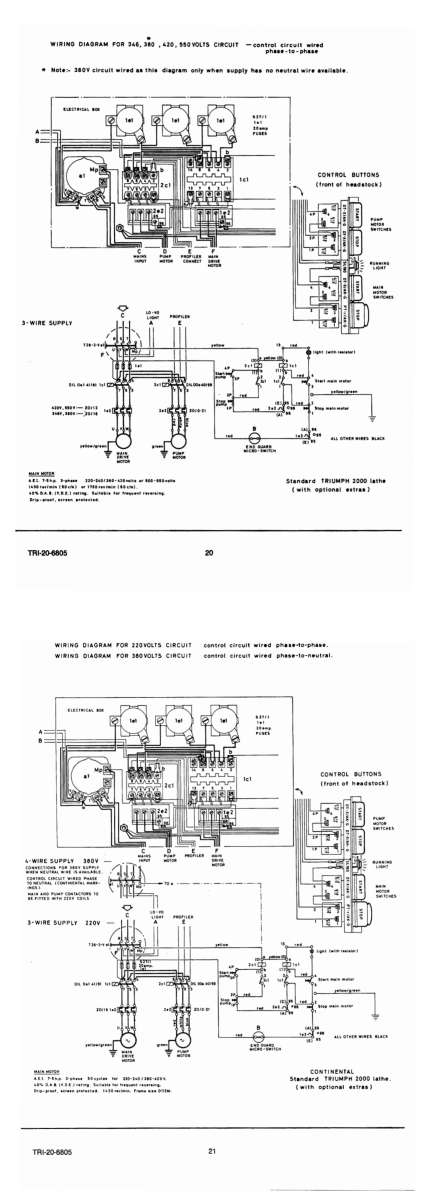

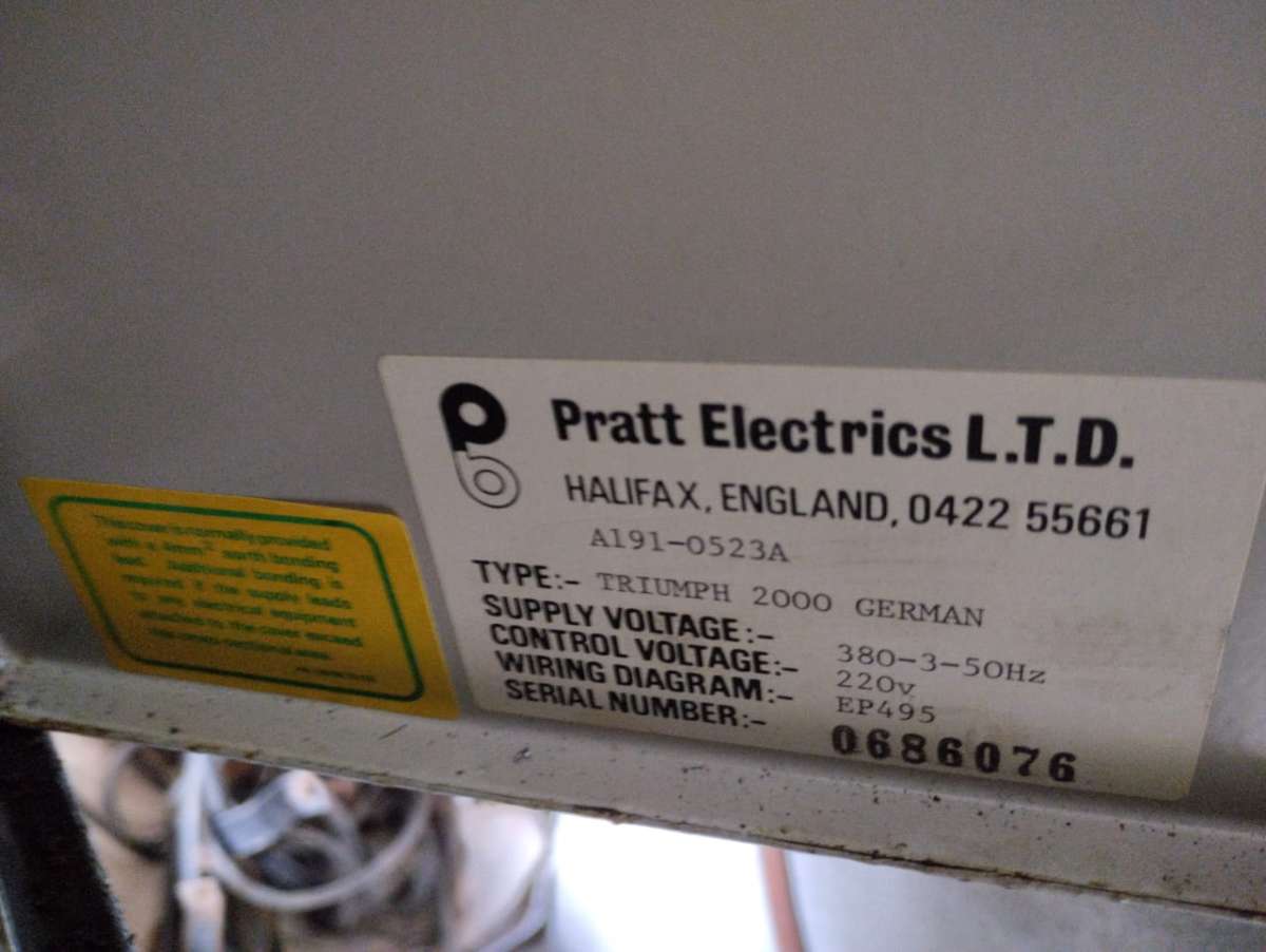

                                                Really it’s all guesswork until someone with knowledge comes along. One benefit you have is that you have the wiring schematic code right there in the picture. It might pay you to message Tony at lathes with that code and see if he has the diagram within his vast library.

                                                      I found the manual and here is the wiring diagram. But I do notUntitled understand it.
