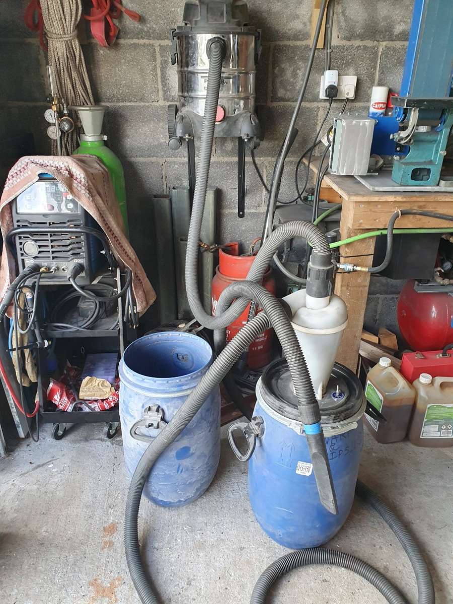

                                          #820167
                                          Taf_Pembs
                                            @taf_pembs
                                            A good while ago I bought a Dust Commander cyclone and a couple of 30L barrels. 1 barrel for chips and swarf and 1 for general stuff. It works fantastic, coupled up to my old Sealey wet n dry shop vac anything that will fit up the pipe it will suck up. It works that well I hardly sweep up any more, just run round with the vac as it gets more up.
                                            I also have it on a remote control socket adapter so I can have the hose near me at the machine (it’s about 5m long) and start and stop the vac with the remote (not that I’m too lazy to walk to the hoover to turn it on! 😁)
                                            In the last – about 8 years – I have just bought my 2nd filter for the vac. It only gets a bit clogged when sucking up lots of building dust or saw dust but a quick blow out with the air line and it’s almost good as new.
                                            It was the best addition to my workshop ever I think!
                                            It is perfect for brass and proper chips and makes cleaning up the machines really quick and easy and it doesn’t mind oily or coolant soaked chips (I leave them drain out for a good while first) but I use one of those Evolution Cyclone Magnets for all the noodles and the bulk stuff. All then goes for recycling.
