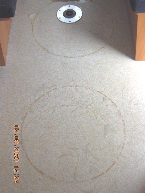

        Hi fonts-of-all-knowledge, I have a bit of challenge. I placed some new tyres directly on the floor of my campervan a couple of weeks ago. When I removed them recently, to the other halves consternation they had left brown rings. I said "don't worry dear, they'll be a piece of cake to remove" …. and I genuinely believed myself.
        I'm packing it today and was given strict orders to remove the rings first. To say its not going well would be an understatement. In fact they aren't going at all !!! I've tried acetone, white spirit, bleach, toilet cleaner, all with and without scotchbrite pads. There is no change.
        The fact that mild abrasion wont shift them suggests the discolouration in the material (which must be a kind of vinyl) rather than on its surface.
        From my school days I recall the chemistry teacher talking about oxidising agents as stain-killers. Is this the secret ?
        Any thoughts chaps as to what I can try next ?

            Meths, or paint thinners. After that try weak hydrogen peroxide as a last resort. Don’t mix these together.
            Then a peace pipe and replace the floor surface later,

                  The rubber feet on a table-top power supply reacted here with a vinyl tablecloth in the same way. Not a surface mark, a stain deep into the material like a burn. So far nothing I've tried touches it, all the chemicals mentioned in the thread plus Sulphuric Acid. As the feet don't stain anything else, I think it's a chemical incompatibility.
                  New tablecloth needed.

                      If the stain has become part of the material then it may be possible to draw it out with a poultice with disclaimers that it damages the vinyl. Klingstrip is sold as a painstripper but I've used the stuff to renovate a filthy marble fire surround (sucked th dirt right out from deep in the marble and came up like new)and i use it to clean the kitchen grout. A small trial-size pack goes a long way if mean with it.. as in trowelling a thin layer along grout lines rather than the whole tile. Cover with clingfilm or old placky bags for12hrs+ (can be a day or two for stubborn stuff) and the wash off. I think it's a clay/alkali mix but it really does draw cr@p out

                            Rubber does wierd things to some materials. Rubber grommets in clear plastic drawer units eat into the drawers. No idea of the chemistry involved but rubber and plastic polymers don't get on.

                                    The stain may be caused by sulphur in the rubber.

                                              Try Googling "Plasticiser migration". I think you're stuffed.
                                              When manufacturing electronic products we used to have to be carefull how they were packaged to prevent the plasticiser from the power cable ruining the plastic case of the unit.

                                                  Thanks all for your thoughts and suggestions. I have tried a few more concoctions without even a hint of success so I'm not hopeful, especially after reading about plasticiser migration !
                                                  Looks like it might have to be a new floor or a large carpet. Look out for my next post where I ask for advice on how to break the bad news
