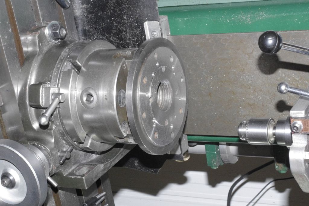

                                  #535099

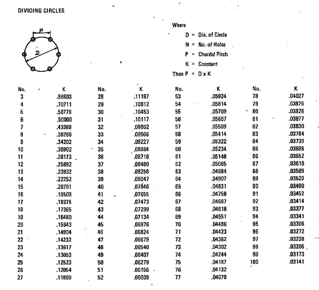

                                          Hi William, you can calculate up to 100 holes with this chart assuming your holes are equispaced, but you need to do a bit of trig.
                                          The one illustrated on the chart is fairly easy, as shown in the sketch above and you could start from any hole, but if you start with hole 0 and then move right 30mm and 51.961mm up to hole 1 and then move right a further 60mm to hole 2, then move back down 51.961 and a further 30mm right to hole 3, then just repeat going down and moving left to get holes 4 and 5. As has been said though, you will need to take into account the backlash in your screws and bearing in mined that the 51.961 is only correct to three places in this example.
                                          Regards Nick.

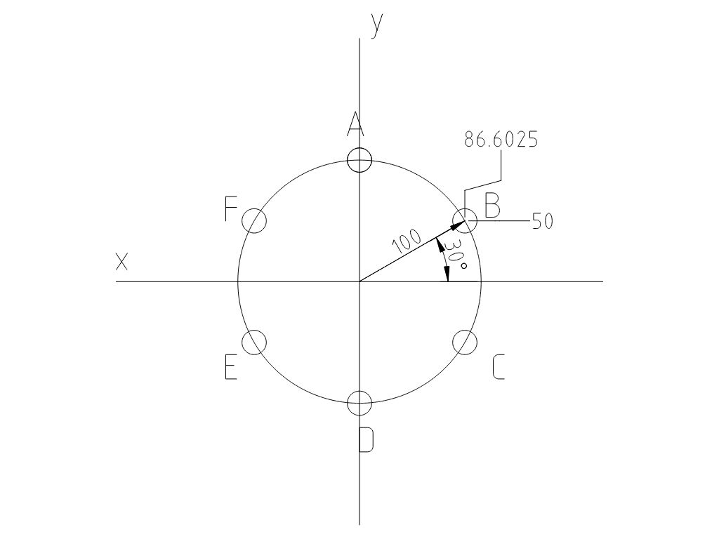

                                              Further to Nick's answer, a little maths goes a long way.
                                              Imagine you have six holes to drill on a 100mm radius. With a rotary table this is easy. Centre the mill on the centre of the table, then move X or Y by 100mm, and drill the first hole. As there are six holes, turn the rotary table by 360/6 holes = 60°, and drill the next hole, repeat turns of 60° until all six holes are drilled job done.
                                              The rotary table makes it easy, but note the coordinates of each hole are determined only by the radius and an angle. This is called a polar coordinate.
                                              What if you don't have a rotary table? One way is to blue the job up, ding the centre point, scribe a 100mm radiis circle, centre pop the position of the first hole 0°, and then use a protractor to identify and centre-pop the position of the other holes, at 60°, 120°, 180°, 240° and 300°. Then centre the mill spindle over each centre-pop with a wiggler needle, clamp, and drill. Same method works with a pillar drill.
                                              Another is to calculate Cartesian coordinates from the Polar Coordinates, as described by Nick. Cartesian coordinates are expressed as a pair of X and Y measurements from 0,0, which in this case will be made the centre of the Pitch Circle Diameter. Mill tables work in X,Y, so the answer is to convert polar into cartesian coordinates which is easy with a computer, scientific calculator or 4-figure tables.
                                              Given a polar coordinate consisting of a radius and angle θ,
                                              X = radius x cos( θ ), and
                                              Y = radius x sin( θ )
                                              In the example below, Hole B is Polar 100<30°, which is Cartesian 50, 86.60
                                              Drilling the holes it's good practice to take advantage of any symmetry in their placement to minimise changing X or Y. For example, as B is aligned horizontally with F and vertically with C, it's less dial twirling to drill those next rather than A, D, or E. Less likely to make mistakes and accumulating error is avoided if the holes aren't drilled A,B,C,D,E, F in order.
                                              Although the method works with dials, a basic DRO that doesn't calculate PCDs makes the job easier because you don't have to keep count of dial revolutions.
                                              Cartesian can be converted into polar coordinates if needed, but I've never had to do it in my workshop.

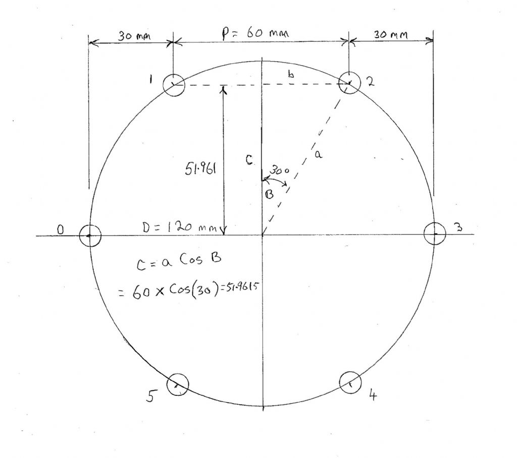

                                                  Just a general observation on the cussedness of things, I have three books with Chord Tables and none of them mentions PCD or Circle Spacing in the index. You have to know to look for 'chords', which isn't exactly user-friendly!
                                                  Tubal Cain's excellent 'Model Engineer's Handbook', 3rd Edn is guilty of this, but the book covers the maths behind chords rather well and provides a Circle Spacing Table on pages 2.34 / 2.35. It's another reason to buy a copy!
