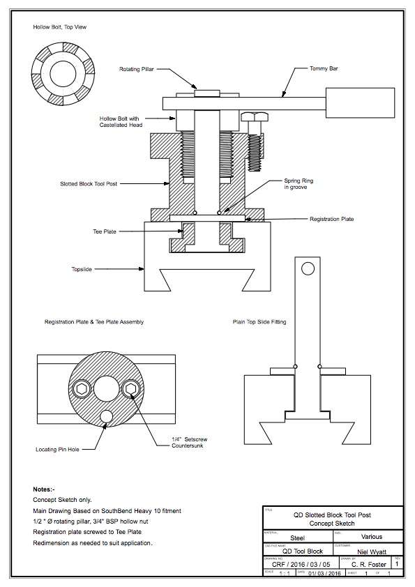

                          Here is a copy of the concept drawings for my stillborn rotating post fixing system as provided for Neil almost a decade ago and over twice that since the original conception. Originally intended for a SouthBend Heavy 10 with a T-slot topside the flange at the base of the post easily sits in a special T-nut locked into the slide by suitable pressure screws. For a conventional screwed in stud type cross slide the slide itself could be modified as shown or a suitable retaining boss fitted on top of the slide with a matching recess is the post base. Indexing to the users choice.
                          The castellated nut remains with the tool-post so, once initially adjusted, only a fraction of a turn will be needed to release the tommy bar allowing the post to be lifted away. I imagine something from the plumbing department could be modified to make the nut if you don’t want to take it all your self (lazy man remember).
                          QD Tool Block
                          Obviously you also need an off machine gauge to set the tools to height using shims before putting on the machine. Off the machine direct measurement is easy. Sorting your shim stock and keeping it sorted is probably harder! Perhaps the colour coded plastic breed would be easier than simple steel.
                          Clive

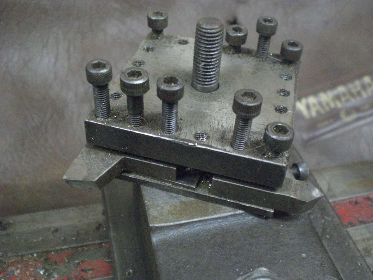

                                                      Hi, I made a four way one, from a slice of 2 1/2″ square bar, about a month or so before MEW 27 came out. It was for my father’s RandA lathe, and I held an end mill in the lathe chuck to cut the slots. Had I’d made one when it was published, I probably would have made a three way one, as I soon realised the problems of other tools getting in the way of the work, and or the tailstock.
                                                      CIMG3478
                                                      As has been said, malible cast iron would be plenty strong enough.
