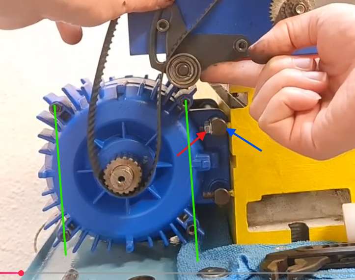

            I made a video just to show how ineffective is the tensioner in both positions in which it can be mounted. Then at the end I put the belt in a different way, as suggested. It is almost working. But the teeth are rubbing each other. It doesn’t make any sense to try to fix this issue in other way than ordering another belt. A new one is 4 euro. The question was why the belt is no longer tensioned when everything is (presumably) assembled in the same way.
            I put a string around both pulleys and the resulting length is 510mm. Without the tensioner touching the string.

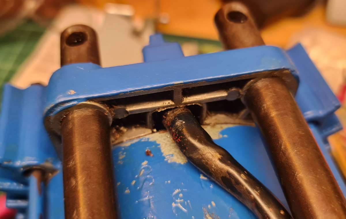

                        Not withstanding the issue regarding belt tension, which can be cured with a new belt; a couple of observations.
                        I’ve been having a look at as many Emco machines as I can spot to view different types of motors.
                        Neil’s Machines, amongst others, show photos of the motor ID plates; They appear to point to a frame size/shape of Elin motors Austria “LCY-308” sometimes with a suffix of R01 & S01; all have a conventional foot mount as shown in various photos on this thread, along with the square vented pulley guard.
                        I wonder if in a previous life, one of more of the feet on Sonic’s motor were broken and the sliding bar arrangement bored through the end plates as an alternative mount, with the angled part machined off.
                        One hole at each end appears to be sleeved, but it’s hard to tell from the photos. It would be the same hole in each of the castings, but top at one end and bottom the other.
                        It’s possible that there is a subtle difference in the centring of those pairs of holes with respect to the motor spindle, which isn’t immediately obvious.
                        As Nick, the previous poster, mentioned, turn the motor over and do comparative measurements using the same mounting studs on the lathe bed. I did suggest this a while ago.
                        Regarding the originality of the vertical spacer block and the deeper mounting block for the tailstock, Sonic seems to feel that they are original due to the Hammerite style painting.

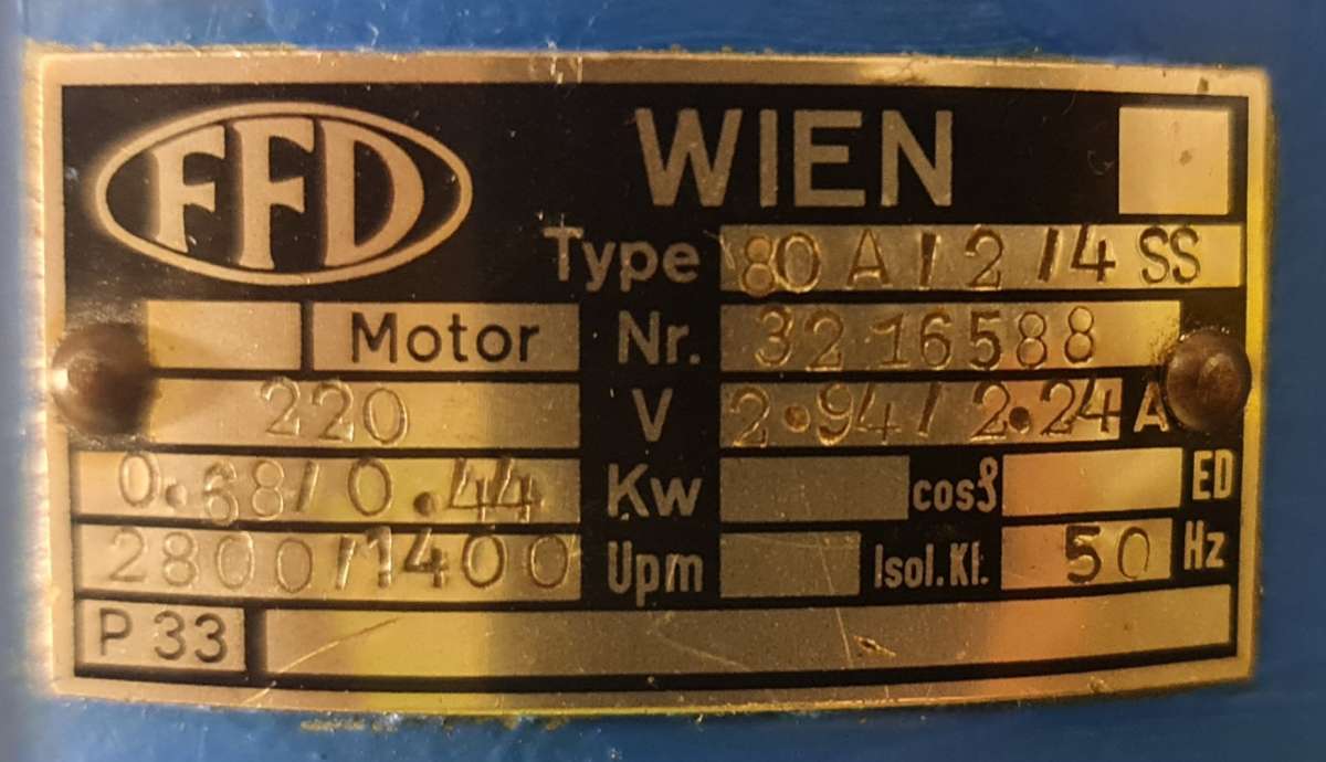

                          No, the motor was designed from the start with that sliding bar mount. Just look at this picture. It looks like a mounting system that allow a wide range of axial adjustment. Useless in this case.
                          20260206_005823
                          Here is the motor type:
                          20260206_005358

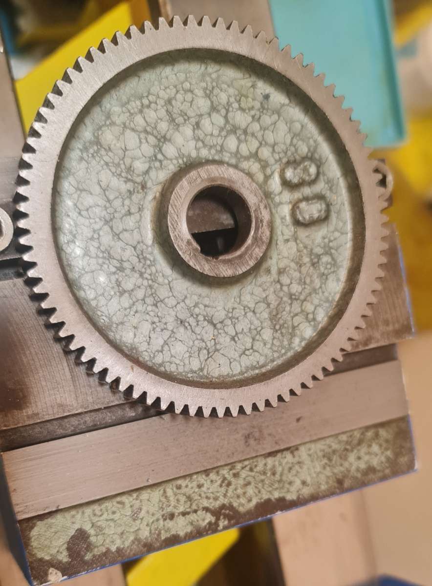

                          The color on the bottom of the tailstock is the same like on the rest of the lathe before repainting it. Here is an original change wheel together with the tailstock:
                          20260206_011110

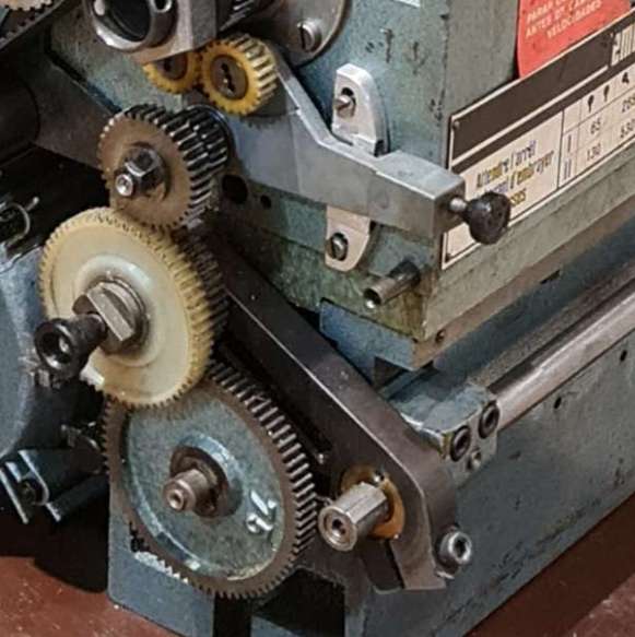

                            It gets curiouser and curiouser; The only reason I can think of for a longer cross-slide would be to allow longer pieces to be milled with a cutter in the main spindle.
                            It must just be a trick of the light and maybe different cameras with varying colour temperatures
                            This photo made me think that the 75 tooth gear was the same colour as the bed, but the spacer plate looked more green
                            image_2026-02-06_014903959

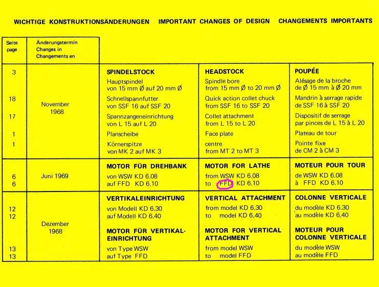

                                          One of the links I posted earlier shows there was a change in motor at one time. FFD are listed as the later manufacturer.
                                          Thousands of Myfords with the longer top slide so easy to see why one may be fitted as well as milling it allows the fitting of a rear toolpost
                                          I’m kind of wondering if this was a factory machine that fell between the Emcomat/maximat 7 and the compact 8 where they used spacers before using a new casting like I had on my Emcomat 8.6
                                          Paint on mine varied and was infact the hammered early finish under the later green, I suspect a smine was a ex demo machine from the importers that it was just given the latest colour when they changed the factory colour.

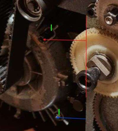

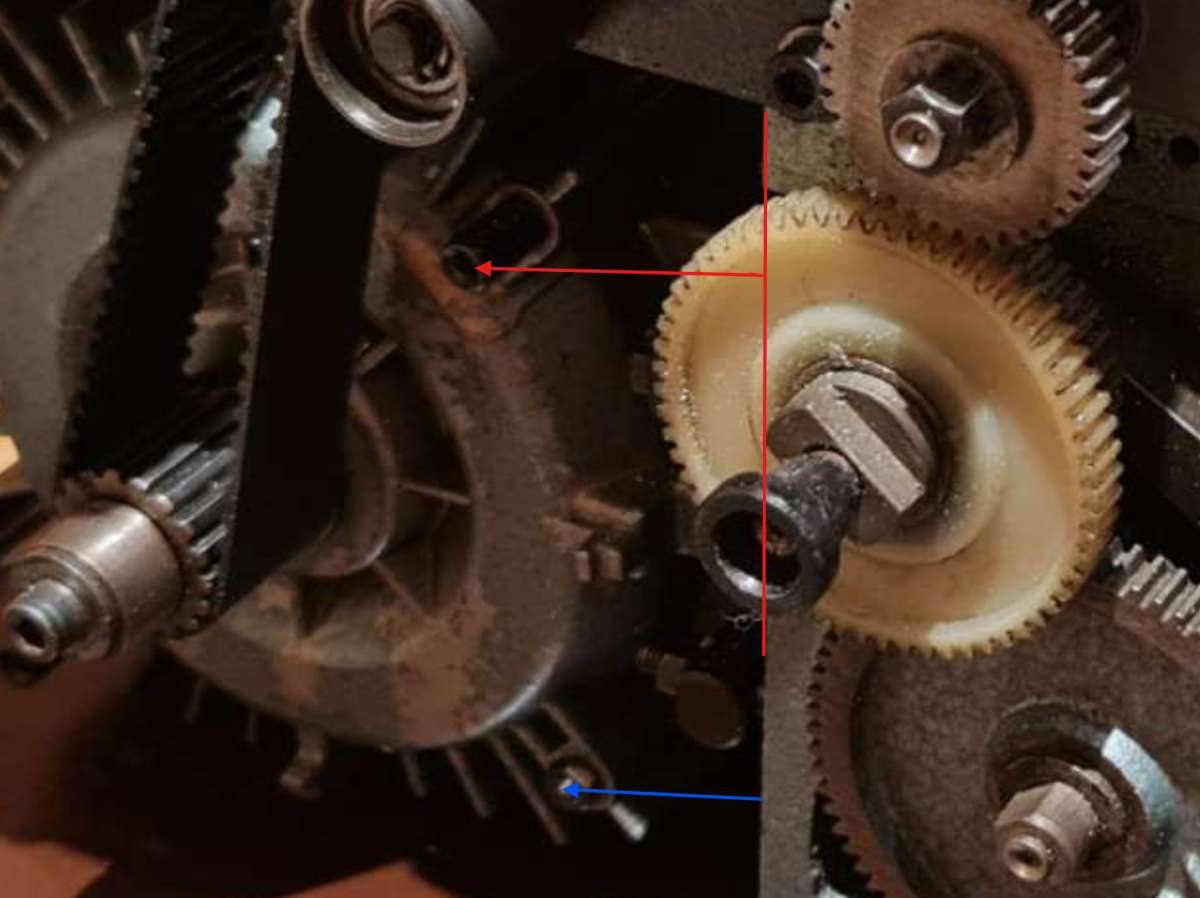

                                                    Another passing thought on re-assembly, since Sonic is pretty sure all parts are present and correct, regardless of whether they originate from the factory or elsewhere.
                                                    From the photos, this hypothesis isn’t obvious to confirm, due to parallax effects etc.
                                                    We have all been assuming (I think) that the two horizontal bars should be bolted against the bed of the lathe, as shown in the second screenshot, taken from Sonic’s video.
                                                    However, since the bars pivot, unlike rigid feet seen on other motors, how about having the bottom bar bolted to the bed as shown, but with the motor pivoting away from the bed at the top, with the top nut(s) pushing it away from the bed. Effectively the lower bar becomes a hinge.
                                                    To my eye, trying to take the perspective into account, the long studs which hold the end caps onto the motor don’t look vertically above one another. That is, the red arrow distance to the rear of the lathe bed looks longer than the blue. Hard to tell when viewed from this angle.
                                                    image_2026-02-06_182256242
                                                    That is, in the photo below, bolt the bottom up fully, and move the top right facing nut with the red arrow, to where the blue arrow points and have the nut facing left.
                                                    This would have the effect of moving the motor’s centre, both out and downwards.
                                                    I’m not suggesting this as a final good engineering solution, but is this how the lathe arrived from the previous owner?
                                                    Sonic could, if this works, replace the top studs with longer ones and then bolt the motor up fully.
                                                    I’m not sure if this would push the motor too far down and have it foul the bench.
                                                    image_2026-02-06_183855761
                                                    The green lines above are nominally vertical, and parallel to the read of the bed, but were they when the lathe arrived ??
                                                    Bill
                                                    #836571
                                                      Peak, in your first photo you are comparing the end of the long hex nut that takes the cover screw with a short standard nut on the lower tie rod. If you take the same point top and bottom there is not such a difference.
                                                      The spacer plate also projects further back than the bed so your vertical red line is also not right.
                                                      long nut
