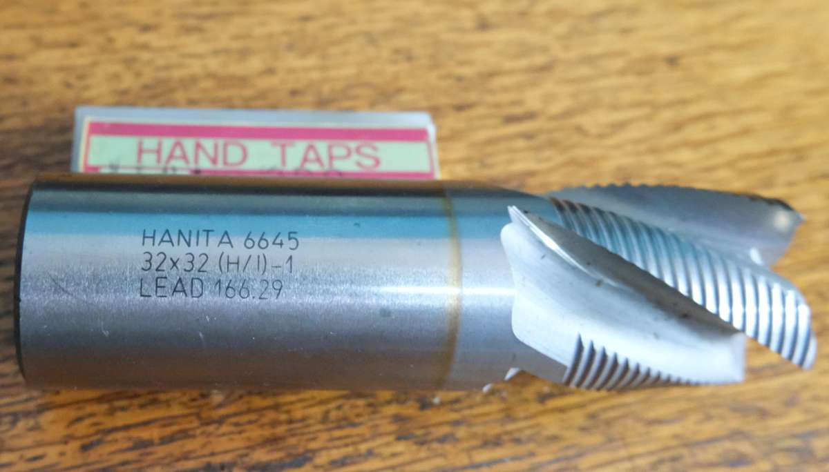

                          How does one sharpen a roughing cutter?

                            I would imagine the cutter needs to move in a helical path against the grinder so the leading edge of each flute can be sharpened which would maintain the serrated OD

                              JasonB is correct, roughing endmills are sharpened by grinding the inside edge of the flute, not on the outside as with conventional endmills. The ideal is a spiral grinding attachment as made by Clarkson and others. It is one of the Clarkson accessories I don’t have. Alternatively a finger can be used on another flute to guide the operation.
                              Roughing endmills have the lead engraved on the shank to aid in setting up the grinding process:
                              Roughing Endmill Lead
                              Julie

                                “Roughing endmills have the lead engraved on the shank to aid in setting up the grinding process:”
                                eeeek. I would expect the lead to be something I could easily set up with change wheels. Where would one start with a number like 166.29?
                                #859385
                                  You could work it back as you know the diameter so easy enough to work out thehelix angle, some cutters have the angle  rather than the lead.
                                  Stick that into your CAD and produce a sleeve with the helix, 3D print it out and use that to rotate the cutter holder as it is advanced against the grinder. Simples. Similar methods are used to cut helical gears.
                                  Or just use some simple maths which will get you quite close. Say you have a leadscrew of 0.100″ pitch. 166.29/2.54 = 65.35 so for every turn of the cutter you need 65.35 turns of the lead screw.

                                      The lead the grinder uses won’t have to exactly match the original lead on the endmill. It’ll just mean that you grind a bit more of at one end or another. After that, you can use the same lead again for further sharpening
