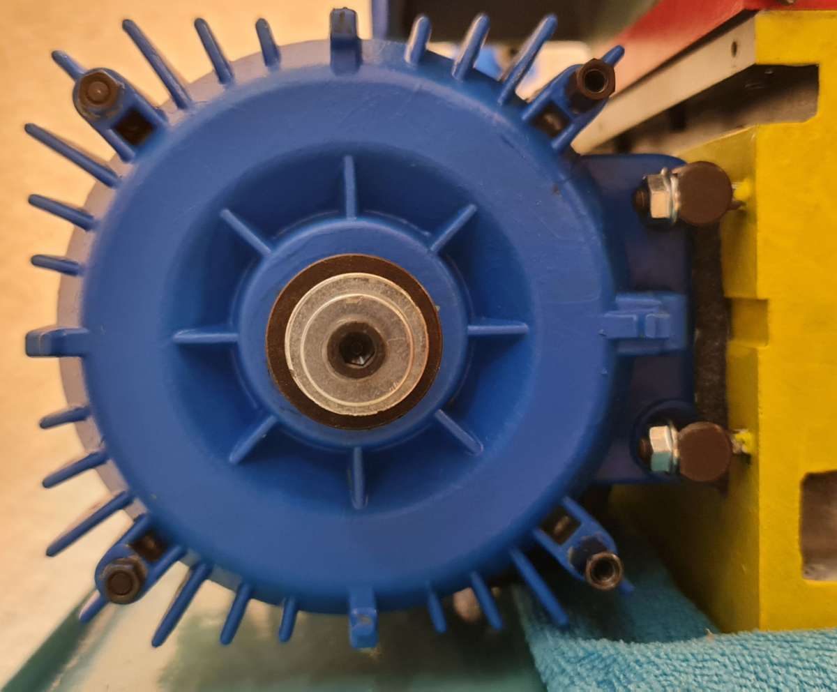

            I don’t think it will affect things as the motor end castings “look” symmetrical but we are running out of ideas. Looking at the two videos before and after the motor bearings were replaced the output end has either lost a lot of paint or it has been put back together with the end castings swapped over. Could this be something to do with the problem?

              A clear photo taken straight on to the end of the motor should show if the mountings are offset from the centreline. As Sherlock Holmes used to say (or something very close to) “Once you eliminate the impossible, whatever remains, no matter how improbable, must be the solution”.

              Phil P
                @philp
                I think the photo we have already seen rules out any ofset in the motor mountings.

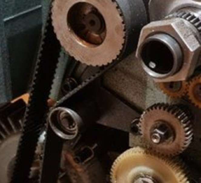

                  Nicholas Farr
                    @nicholasfarr14254
                    Hi, well looking at the original photo, and cropping and enlarging the area around the adjusting pulley on the before one, the adjuster is push up higher then on the after photo, so maybe something has got in the way of it going up higher. It shouldn’t need to go much higher to take out the slack that you have.

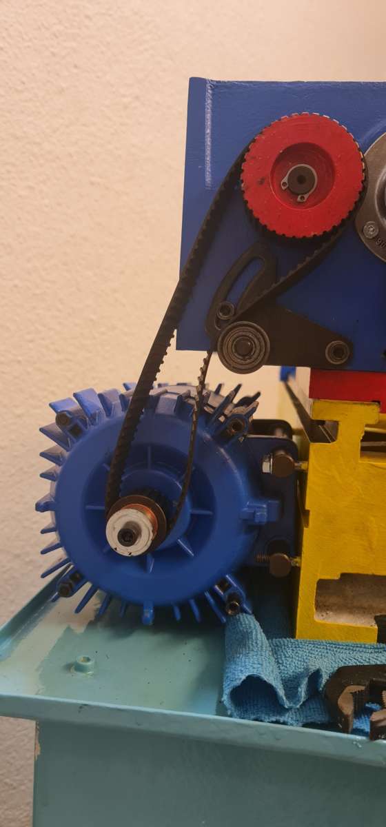

                      The idler appears to be high up, near the drive pulley for the spindle.
                      In view of the small diameter motor pulley, is it possible to reposition the idler so that it increases angle of wrap of the belt around the motor pulley?
                      On the face of it, it sounds like misassembly, since none of the components have changed.
                      My inclination would be over check the assembly without any soft spacers, as much to the original set up.
                      You haven the original components, which worked, so ensuring that they are assembled in the right place and order ought to solve the problem.

                        I want to summarize some conclusions:
                        – there could be some spacers for the motor. I’m not the first owner of the lathe. But moving the motor horizontally doesn’t tension the belt. Unless it is not moved by a considerable distance.
                        – I agree that I did something wrong in reassembling it. But I want to make some progress with the lathe. There are many months since I’m waiting for the moment to turn it on and now I’m very close. That is why I want to order a new belt. I don’t see nothing wrong in the way it is assembled now. With a shorter belt it should run fine.
                        – the adjuster idler can’t tension the belt. No mater if I reverse it, rise it to the maximum or anything else. The belt is way too large for it to be able to compensate. Bellow are two pictures with the tensioner mounted in both positions. Also look at the motor screws, I tilted it as much as possible.

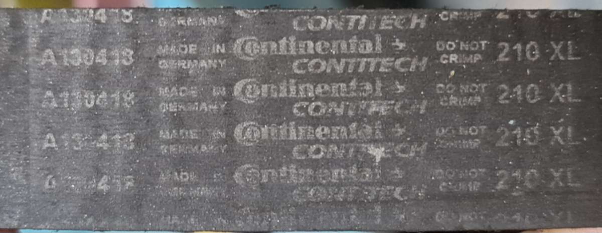

                        Can you tell us what the numbers are marked on the belt ?
                        According to the parts list it should be a 190 XL 075
                        With details on this link, does it actually have 95 teeth ?
                        https://www.tyma.eu/products/190-xl-075-conti-synchrobelt-neoprene/?srsltid=AfmBOoqo5EAvD95hTaxqt_kbJLVbKXUW0VH4lwzqnBOKFbUNNpmiOOP2
                        My belt has 105 teeth. Here is the type. But maybe the extra length comparing to the one from the part list is justified by the headstock riser block. I even tried to count the teeth of the belt in the first pictures. Just in case the seller gave me another belt and I forgot (very unlikely). But the number of teeth was also ~105.

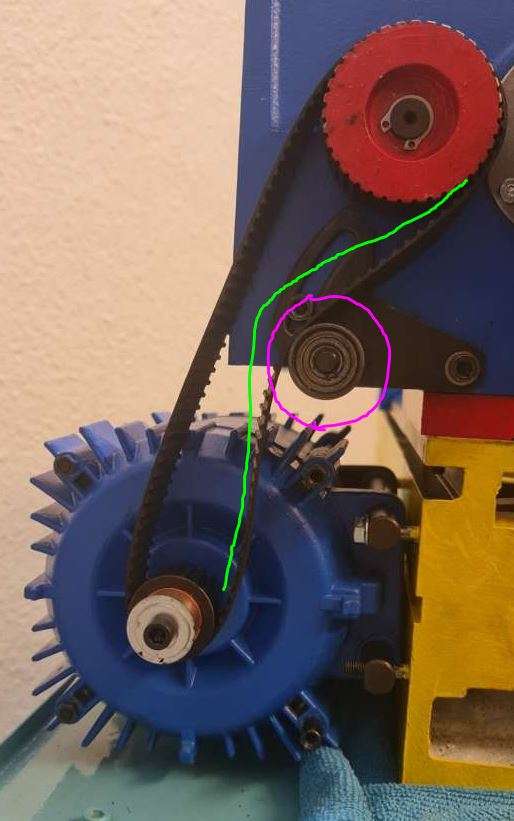

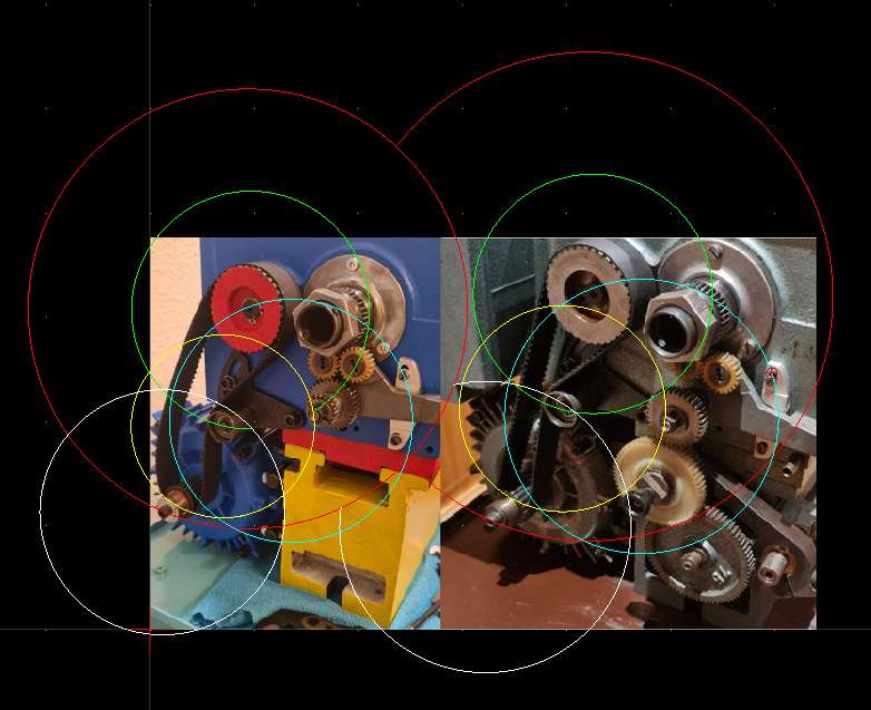

                                I tried comparing the relative distances between reference points on the before and after photos, hoping a displaced part would show up.
                                Screenshot From 2026-02-04 20-38-50
                                Looks to me as if all the relative references under the circles are proportionally similar. I can’t see anything in the comparison suggesting an assembly error.  For example, the red circles show the motor and headstock pulleys are the same distance apart relative to half-way up the lathe bed and the reversing lever in both photos.
                                The only thing that’s obviously wrong is the belt.  Except Sonic said in the opening post that there’s only one, so it can’t be that!  However, to quote Sherlock “Whatever remains, however improbable, must be the truth.”  As we’ve all failed to identify anything wrong apart from the belt not fitting, try a shorter belt!

                                  Aha – carefully studying the photos as you’ve edited with all those circles…
                                  Would bringing the motor back against the casting take up much of that slack, by increasing the wrap round the tensioner roller? Endless belts don’t need much lateral movement to tighten them appreciably.
                                  Sonic –
                                  Try that first- move the motor fully back to the bed so the roller has more effect.
                                  If that does not do the trick, was the belt too slack even before you took it all to bits?

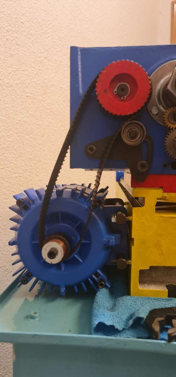

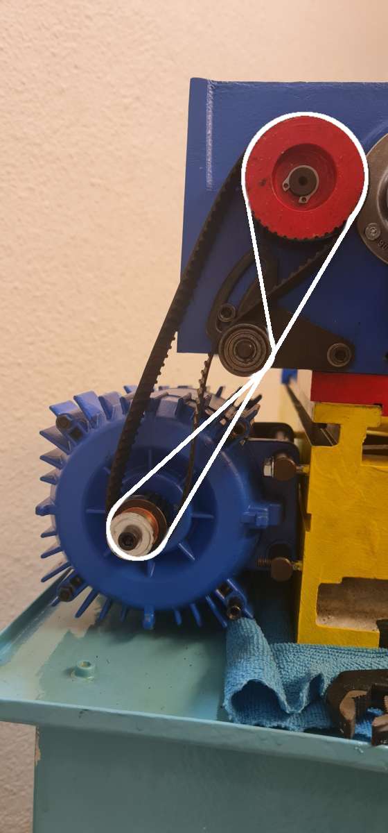

                                      Sonic –
                                      Look carefully at IanP’s reply a few messages up from this.
                                      I think he’d twigged it before I did, because your photo he cites is full-on to that area and shows that although the belt is too slack there, it does not look ever so “too long”.
                                      With the tensioner that way round (the quadrant between the belt sides and pointing upwards, roller on the outside) the amount of slack in the belt looks small enough for what he suggests, and as I did later, bolting the motor back to the bed.

                                          Do I take it the lathe was not used before dismantling ? 2 thoughts, first bring the rear belt run forward and put the adjuster on the rear run. …Noel.
                                          We have a winner. That would put the idler pulley in the more normal position on the return side of the belt  not the drive side.

                                            Good idea, and I hope it’s right.  Don’t bet the farm on it though:
                                            sonicbeltrun
                                            Maybe with the tensioner reversed? I think it makes the collision worse.  Over to Sonic! Does that belt arrangement fit in the real world? With luck my drawing on an angled photo looks tighter than it really is.   Fingers crossed!

                                                In all the pictures of the tensioner (including Jason’s in previous post) there still looks to me to be around 1/2″ of slot left to go.  If the tensioner was pulled right up to the end it would increase wrap round the top pulley.
                                                Colin
