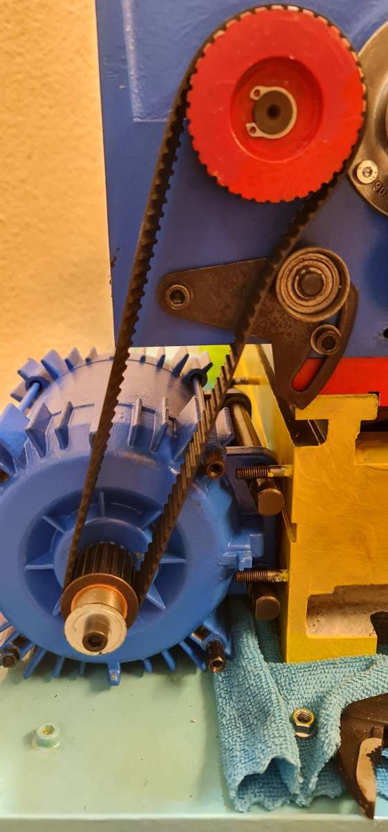

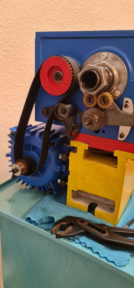

      This is embarrassing but I don’t know how to reassemble my lathe! On the right it is the lathe before disassembling it. And on the left is when I put it back. I can’t understand why the belt is so much larger! That tensioning wheel can’t compensate for such a big increase in diameter. What am I doing wrong? It looks to me that I put back everything in the same way. And I have only one belt, no risk to mix them.

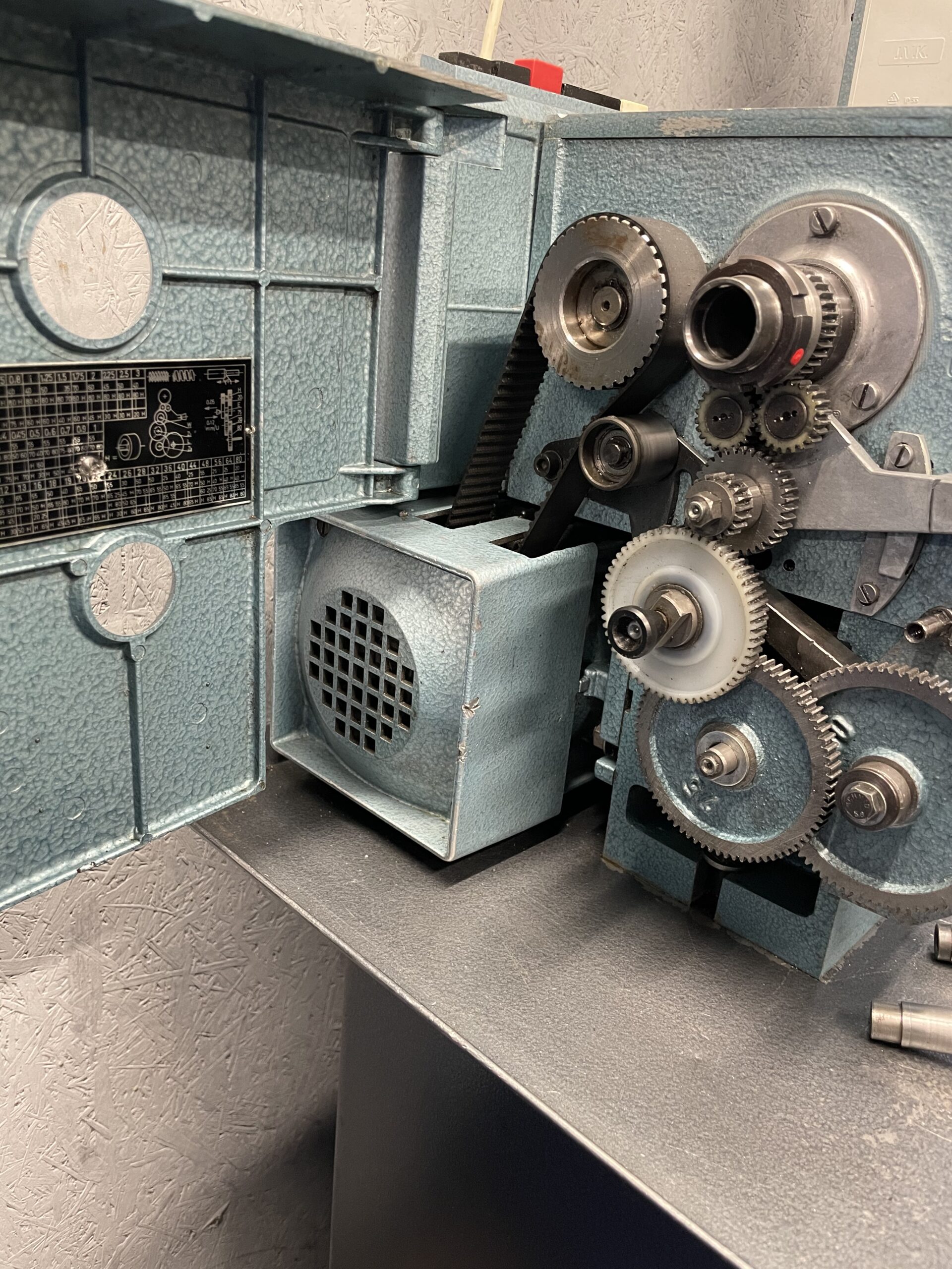

        Sonic Escape
          @sonicescape38234

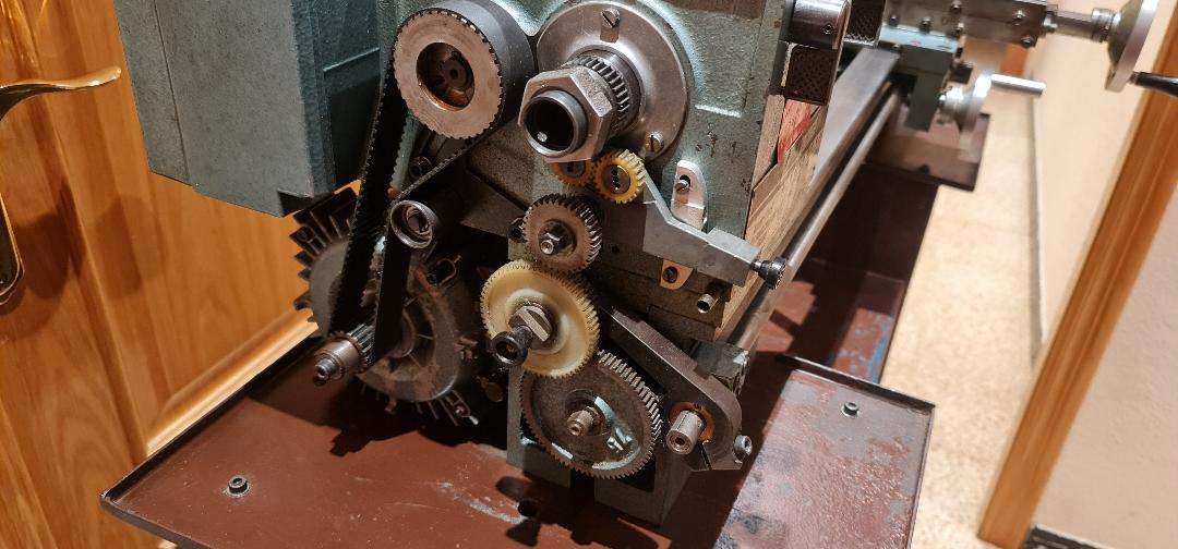

          The lathe is an Emcomat 7. I found this picture. The black metal part that supports the adjustable idler was mounted in reverse in my case. But this is not the problem. I mounted it like in the picture and the belt is still way to large.
          20260203_120909
          #835628
          Phil P
            @philp
            That is a bit of a puzzle but here are my initial thoughts.
            The position of the red pulley is not variable so forget that.
            The position of the tensioner looks to be the same as the “before” photo so probably forget that as well.
            That only leaves the motor, I would double check the mountings / adjustment for that as a starting point.
            Have you maybe left some spacers out somewhere ?

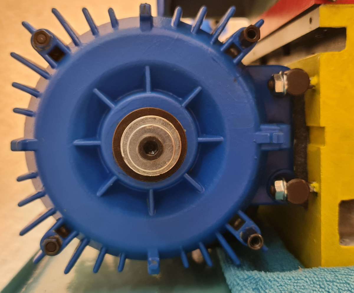

            Sonic Escape
              @sonicescape38234
              The motor is mounted like this. Unfortunately the exploded view from the manual doesn’t help because it looks like I have a different version of the mounting method. But still I can’t imagine what could be wrong. There are 4 M5 screws coming out from the bed and the motor has two black bars that connect to the screws. I don’t see how to mount the motor in a lower position.
              20260203_122104

              peak4
                @peak4
                It’s really hard to tell from the photos, and I don’t know how the motor is built, or what type it is.
                Are the mounting brackets offset from the centre line of the motor?
                If so, is it possible that when disassembling and refurbishing the motor, that you have reversed the end castings?
                I don’t even know if that’s possible, but effectively, the spindle would be sicking out from the wrong end, necessitating mounting the motor upside down compared to when it was previously fitted.
                That is, the armature has been re-fitted reversed left to right along its axis compared to previous.

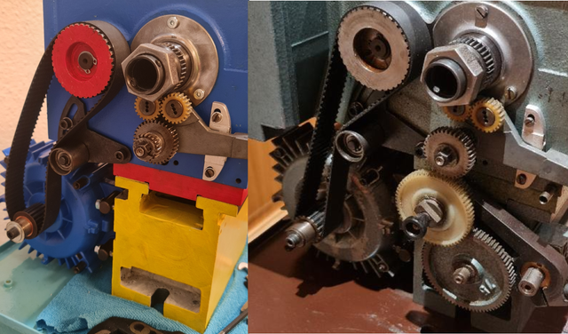

                  #835656
                  Mike Hurley
                    @mikehurley60381
                    I agree with Martin.
                    In your original pair of pictures, if you draw an imaginary line between the two axis of the main pulley and motor, in the ‘original’ one that line would ‘touch’ the edge of the adjustment pulley. In the later one there would be a gap . Only the position of the motor can affect that. Recheck the. Mounting.
                    Note : the 2 photos appear to have been taken from roughly the same angle, so I’m assuming there’s no visual distortion.

                    #835663
                      Is that the same pulley on the motor?
                      The painted up lathe looks to have a pully with a flange and the toothed area looks a smaller diameter than the original unflanged pulley.

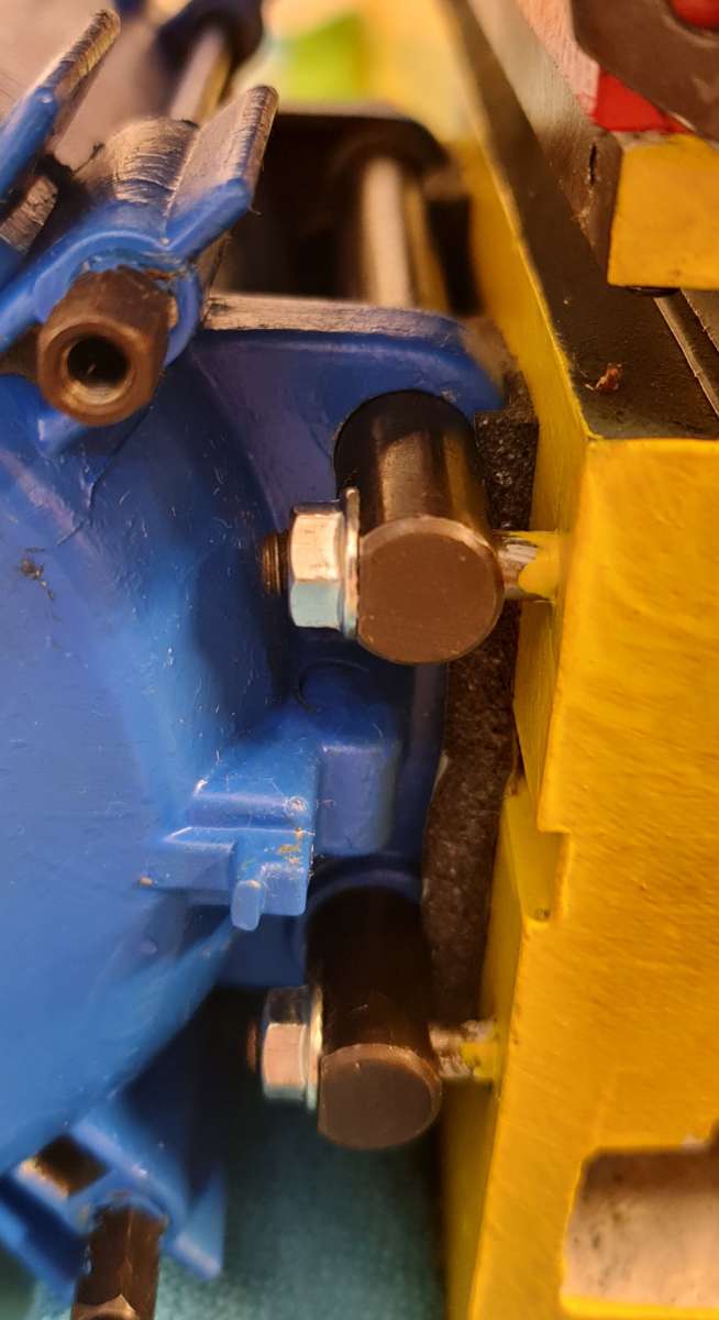

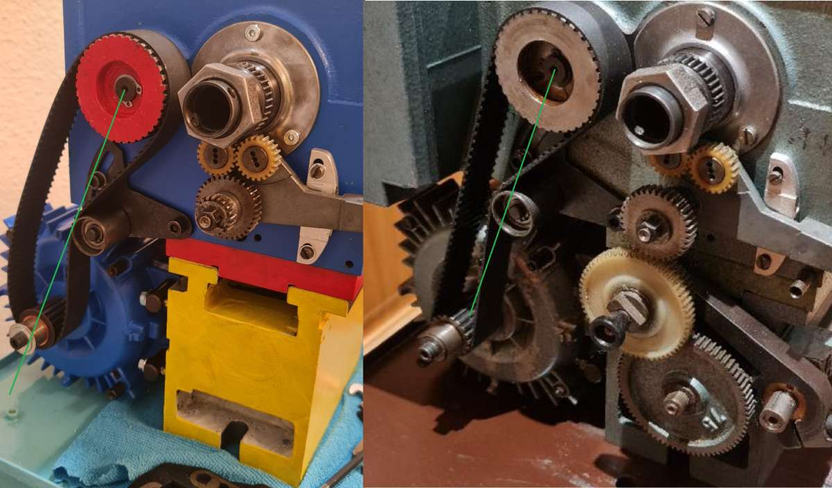

                      Sonic Escape
                        @sonicescape38234
                        Bill
                        I understand what you mean but the mounting brackets seems to be symmetrical. So reversing the motor end castings should cause no effect.
                        20260203_142940
                        On blowlamp Said:
                        The motor mounting looks a bit odd because of the gap between the bars and the bed, which means that the bolts don’t have the correct clamping effect. Are you sure that spacers or bracket of some sort aren’t supposed to fit between the motor and the bed?
                        The correct size of belt is fitted, isn’t it?
                        Martin.
                        Here you can see better why there is that gap. I don’t think there was a spacer there because the screws would be too short. I added some soft material between the bed and the motor in a hope to reduce the noise. And anyway moving the motor a few cm horizontally would not tension the belt. It is a pity that I don’t have the manual for this version of mounting.
                        20260203_143126
                        Mike
                        You mean like this? In the left picture the motor is mounted a little to the left. Because of the soft material I added between the motor and the bed. Horizontal position shouldn’t matter much, but I’ll remove that material just to check. Anyway I don’t have other ideas.
                        Lathe Belt 2

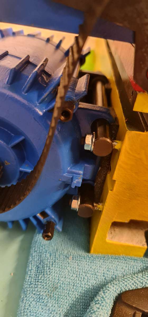

                          Sonic Escape
                            @sonicescape38234
                            Here you can see how much I have to lower the motor in order to tension the belt! Something is seriously wrong in the way I reassembled this part of the lathe.
                            20260203_145804
                            #835676
                              Swing the tensioner right up, it needs the roller a lot closer to the spindle pulley

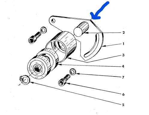

                                    peak4
                                      @peak4
                                      Yes, the two mounting points for the motor do look symmetrical, so it seems to rule out that one.
                                      The exploded diagram of the other motor (Page 13 of the manual) shows the same part number for each end, so it would be possible to reverse the castings, but it looks like it wouldn’t make any difference.
                                      Similarly the two long bars with flats on would move the motor even closer to the headstock if reversed.
                                      Not wishing to talk down to you, but are there any bits left over? I’m thinking 4 tubes to space the motor out slightly between the round (flattened) bars and the headstock.
                                      Alternatively, I see you now have the tensioner idle pulley in the same orientation as the one in the photo off Tony’s site; wasn’t it the other way round previously? This photo appears to show the belt length; does that tally?
                                      image_2026-02-03_144806903
                                      How is the journal (2) mounted to the plate (1)? Did you take it off when cleaning and refix on the opposite side?
                                      If it can be fixed the opposite side, maybe reverse the plate so that the curved slot is on the side further from the headstock; That would also move it upwards and allow more wrap around the top pulley.
                                      Page 33 of the manual
                                      image_2026-02-03_143740758
                                      I wonder if the tensioner might be a multi use part, assembled different ways around, and fixed in opposite directions depending on which motor is fitted.
                                      Bill

                                              On peak4 Said:
                                              Your lathe is flat topped and has a spacer under the headstock
                                              That was going to be my very unlikely question: if the headstock has been removed from the bed for the porch painjob (sic), has it been re-mounted correctly? If the motor won’t go down, does the headstock need to go up?
                                              Someone with the appropriate photo analysis skills could scale (overlay?) the two photos and see if the measurement between motor and input pulley is the same. Spindle to input pulley clearly cannot change.

                                                Sonic Escape
                                                  @sonicescape38234
                                                  Doesn’t help, the belt is too large.
                                                  Out of interest – With the motor mounted normally, remove the 2 screws holding the adjuster mount plate. Manually push the assembly across to the left against the belt-  how far could you push it?
                                                  This problem has got to be something stupid simple?
                                                  Quite far. This can’t be the solution. I agree that the problem has a very simple cause
                                                  Yes. it was the other way round. But in both cases the tensioner can’t compensate for the extra belt legth.

                                                  Hey, what’s wrong with my panting? I like it 🙂
                                                  I regret that I didn’t made more picture before disassembling the lathe. But even with the one I have I’m confident that I reassembled this parts like before. The headstock is fixed to the bed with 6 screws. So there is only one way to mount it. At it’s height is given by the red riser block.
                                                  Anyway, I’m thinking to declare it an unresolved mystery and order another belt. Are these types made in small diameter increments?
