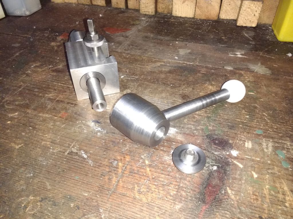

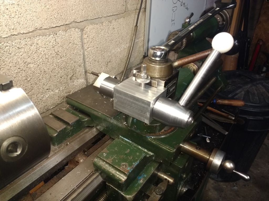

                    Hevanscc
                      @hevanscc
                      Hi Peter
                      I have also made the Hemmingway version. Martin described the cutting tool but if using a boring bar it is quite springy so only very light cuts in harder material is possible. Haven't tried parting off with it as I can't see that it would be easily achieved.
                      Hywel
                      Boring head ball turner
