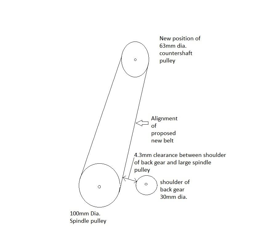

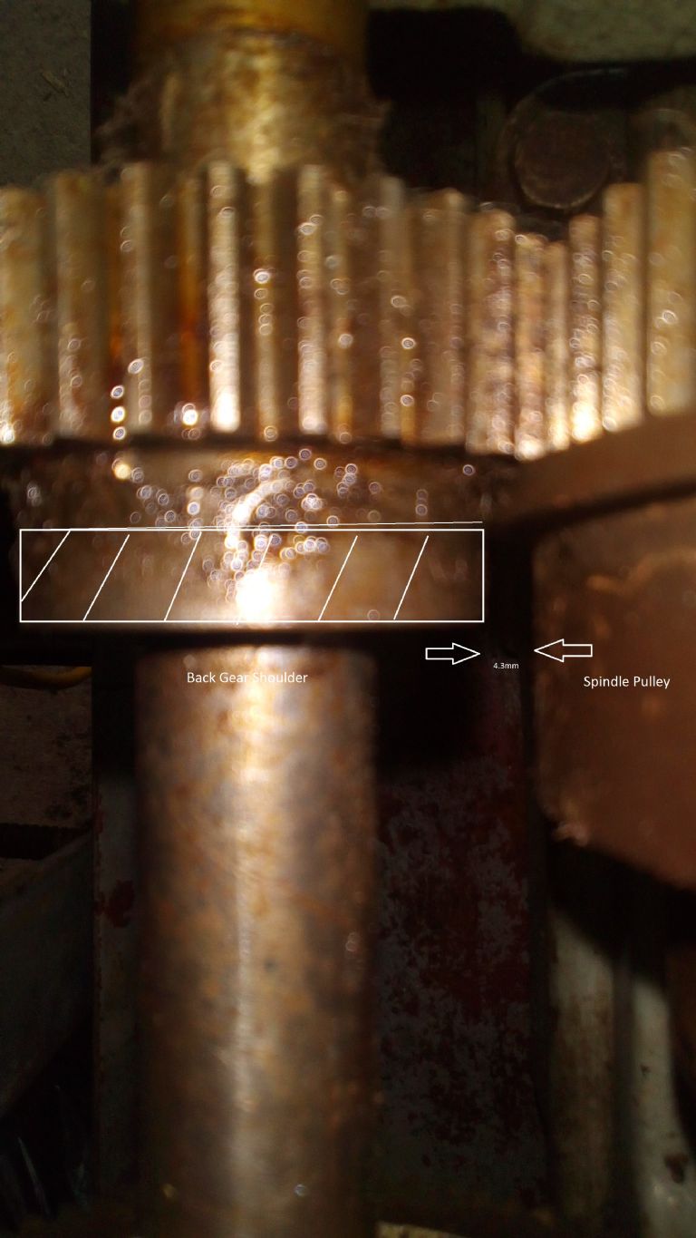

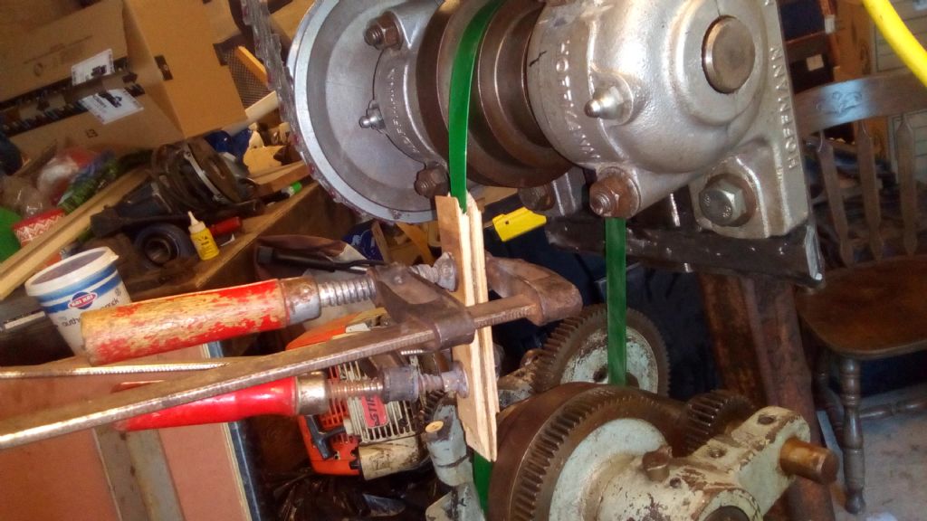

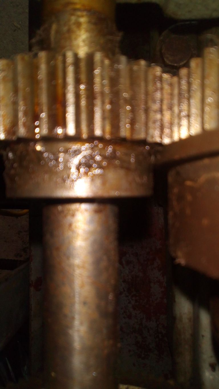

                  back gear shoulder clearance.jpg2.jpg@SillyOldDuffer. Re: my last reply to you…..
                  "do you think it would be an issue to run 20/40 thou off the shoulder of that gear ? Just to give a tad more clearance."
                  My thinking is a miss is as good as a mile but I don't know if that applies to drive belts ? I believe the Poly V belt is 3.5mm thick. should be approx 0.8mm of clearance. A touch off the shoulder would improve that a tad but I really don't know how snug these belts get and what the tolerances are when they are in tension and whizzing round at speed.1.jpg
                  #486506
                  Perko7
                    @perko7
                    From my experience with flat leather belts, they do flap a bit at speed but rubbing on a smooth surface like the shoulder of the back gear would not cause any problem. Mine will sometimes rub on the end of a piece of steel angle forming the motor mount, other than polishing the end of the angle no harm has resulted to the belt.

                      #486535
                        Posted by Dibnah on 18/07/2020 21:09:32:
                        The answer is I don't know – I've no experience of how far belts come out but see Perko7's encouraging comment about flat belts. I'd expect V belts to be less inclined to flap but flap may be more a matter of adjustment – loose belts flap much more than tight ones. Important not to over-tension belts though because it puts a lot of side strain on the bearings. Rule of thumb, about 10mm / 1/2" stretch when pulled with a finger in the middle of the longest span. From your drawing, the gear shoulder is close to the lower pulley, where the belt is pulled close anyway.
                        I wouldn't expect skimming a little metal off a gear shoulder to do any harm, but it might not help much. It's uncomfortably close whatever. Maybe try it to see if the belt rubs? A miss really is as good as a mile.

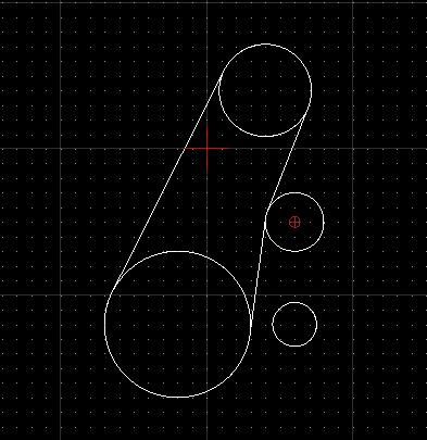

                        Otherwise, is there room for a jockey wheel? Something like:
                        As well as guiding the belt, jockeys are often a convenient way of adjusting tension. Rather than moving the motor, adjust the jockey.
                        #486575

                          Posted by Perko7 on 19/07/2020 04:22:19:
                          Ok thanks for that info Perko yes I think will give it a shot and see how it goes first.

                            #486578

                              Posted by SillyOldDuffer on 19/07/2020 10:13:37:
                              Great suggestion Dave the jockey wheel may be easier to achieve than my initial plan for tensioning. And the rule of thumb info is really useful to know yes As per your suggestion and Perko I will give it a run and observe before I decide to take a slither off the shoulder.

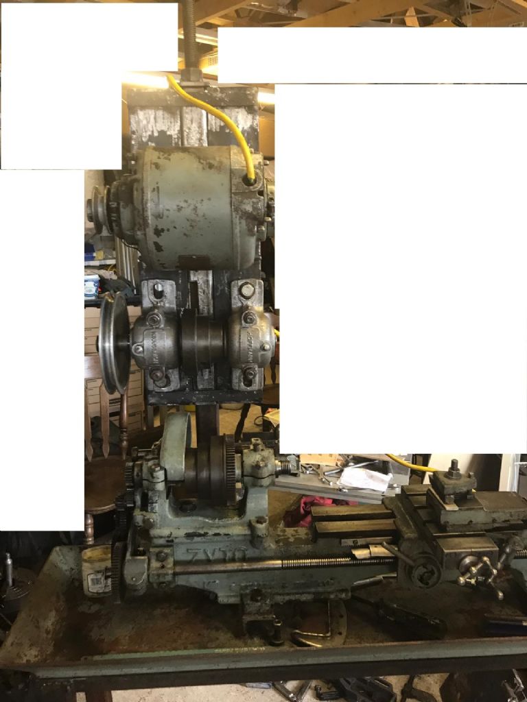

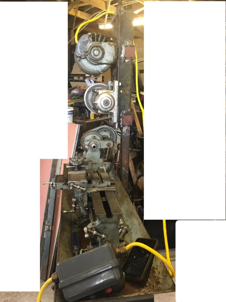

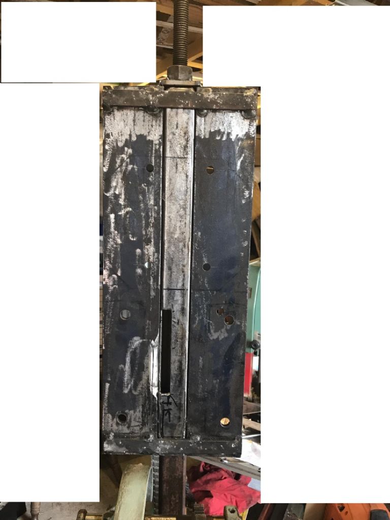

                                Managed to tack the motor & countershaft mount together this evening.
                                Motor and C.S. bolted to angle iron which uses a piece of box section as a guide, the angle has couple of keepers snug on the rear and raises and lowers for tension by that stud on the top of the mount, through a captive nut. The box section is bolted to a piece of slotted angle shown in earlier pics. Haven't got any belts on but spun the motor up and as yet no out of control vibration. I am trying an idea I had for a flat belt and will reveal shortly what it is, just glued it up and will give it a whirl tomorrow hopefully. Success or failure I will report here.smiley This stuff is so cheap if it is ok I don't mind cutting it off to strip everything down for final weld and paint.
                                Have edited out backgound junk in the hope it easier to see.

                                  I used pallet banding for a flat belt. It hasn't really had a load test as in cutting chips but it has held and spun under tension with no slip or sign of parting company up to now. It's that uncontrollable stuff you get around heavy parcels etc too. I think it is polypropylene maybe ? I have some on a drum so thought I would experiment with it.
