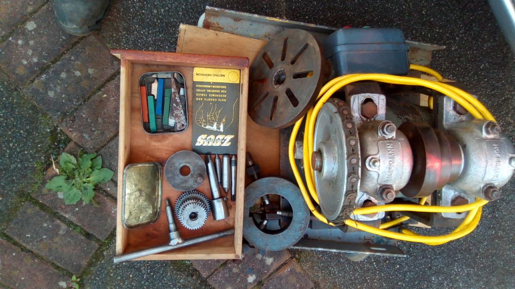

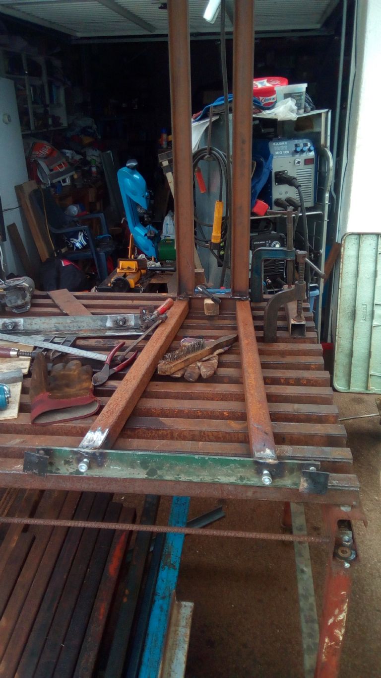

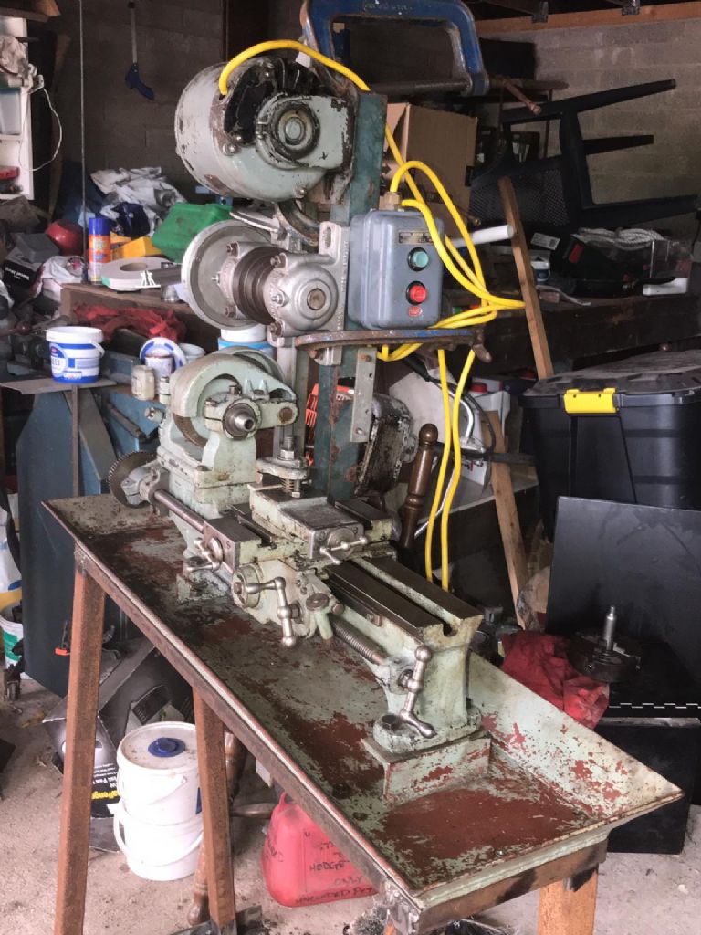

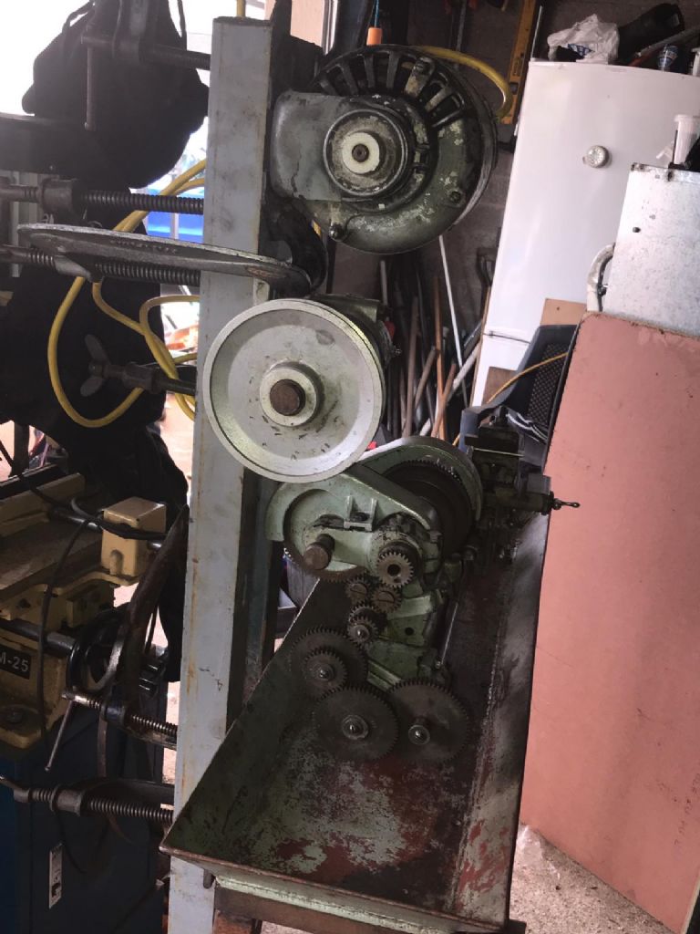

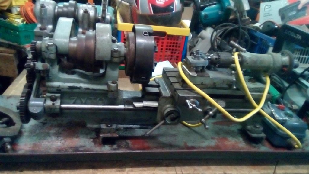

      Just inherited this lathe. Want to change the motor and countershaft arrangement. Want to relocate to above the lathe. Have just fabbed a new stand for it with castors for easy of moving and jacks for when it's in use, will add couple of shelves and framework for motor mount to the rear as I figure it out.

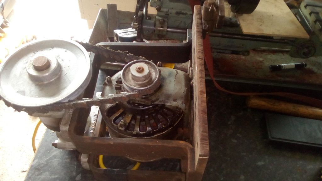

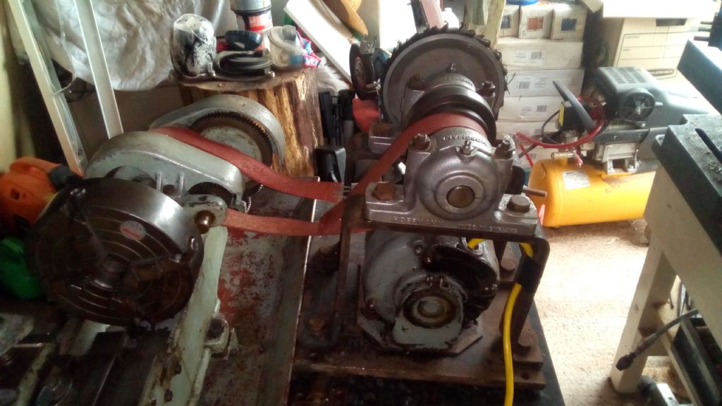

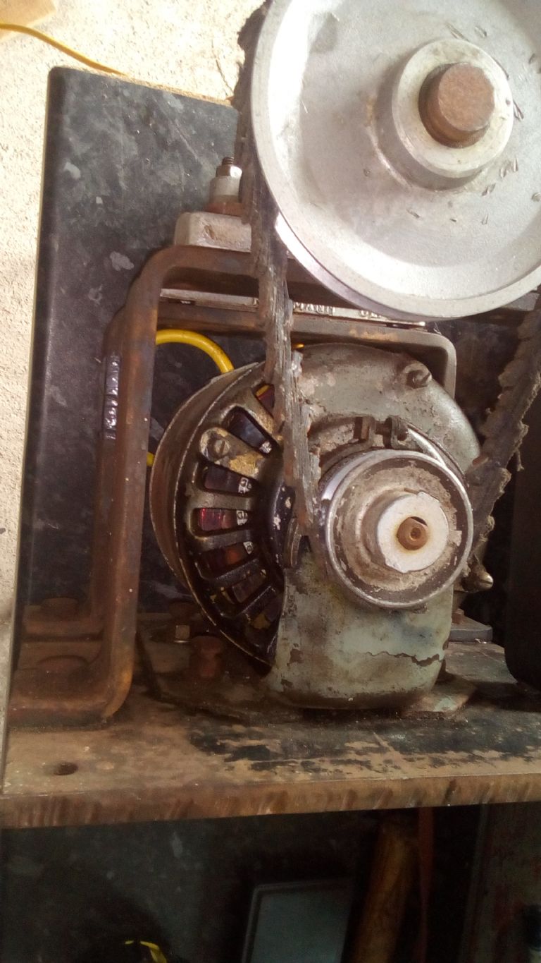

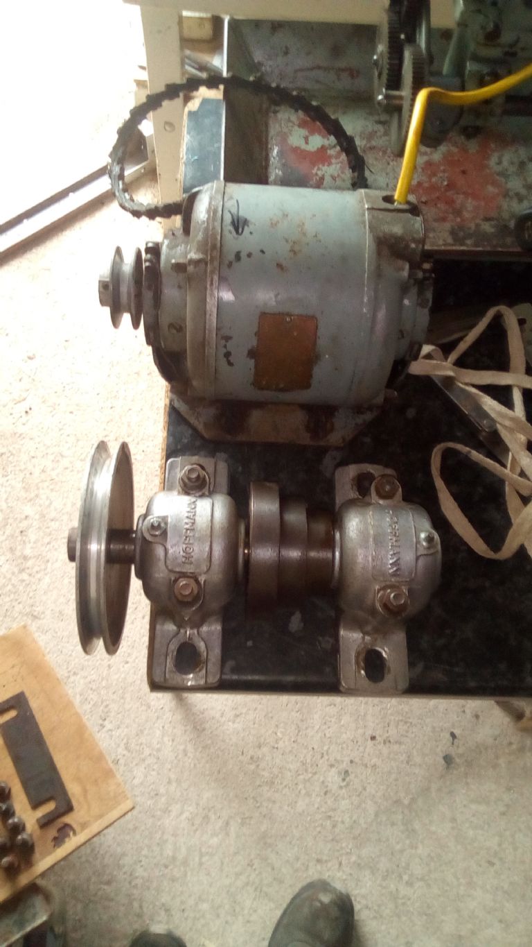

                        Motor and countershaft mounted to half inch plate and flat bar. Someone must have had a mate who worked in a shipyard!! Heavier than the lathe laughimg_20200715_135846.jpg

                                Clive Foster
                                  @clivefoster55965
                                  Dibnah
                                  Having made a number of countershaft arrangements of several different designs over the years I think what a I called a "crypto Myford" version would work well with your Zyoto. Basically a rectangular frame hinged off the bench just behind the lathe bed running up at an angle such that the drive belt from countershaft to lathe spindle clears the back gear pivots. The motor is suspended on a suitably pivoted bracket close to the bottom of the frame. I Imagine a frame around 3 ft long would work OK.
                                  The one I made was for a Pools lathe. The motor was perhaps 2 inches clear of the back of the bed and a similar distance above the bench. The countershaft itself ended up with its spindle line around 16" back from the lathe spindle. Plenty of room to add a second shaft, ex-spin drier bearing carrier units are good, if you go for a two stage speed reduction which uses smaller pulleys. I guess somewhere around 350 rpm countershaft speed would be OK.
                                  By cunning arrangement of the pivots (OK sheer luck!) thew eight of motor and countershaft unit gave adequate belt tensions. Plan B was bungee straps!
                                  I made a belt guard from hardboard sheet which painted up quite well.

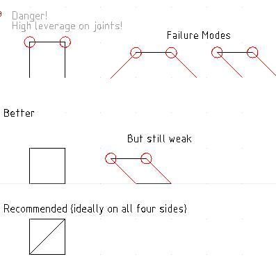

                                        Posted by Dibnah on 17/07/2020 10:51:00:

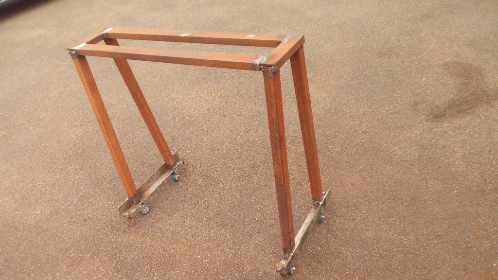

                                        Good start, but the structure has a very weak geometry. I'd add more struts.
                                        Lathes are great fun, but not if one falls on your feet! Enjoy.

                                            My shaper has the same sort of stand, with cross struts
                                            Put in cross struts and bottom struts as recommended by sillyoldduffer, make a reinforced box shape
                                            and check regularly for welding cracks once it's under a working load, I have fixed at least one crack which suddenly appeared in my own frame

                                            #486319
                                            Dibnah
                                              @dibnah
                                              Posted by SillyOldDuffer on 17/07/2020 11:43:11:
                                              yesYes agree. I thought I said here but must have been another thread that I plan to make a mechanical connection longitudinally either weld or bolt in the form of a shelf. Maybe even two shelves but wanted to leave that until I'm satisfied with my motor mount plans.

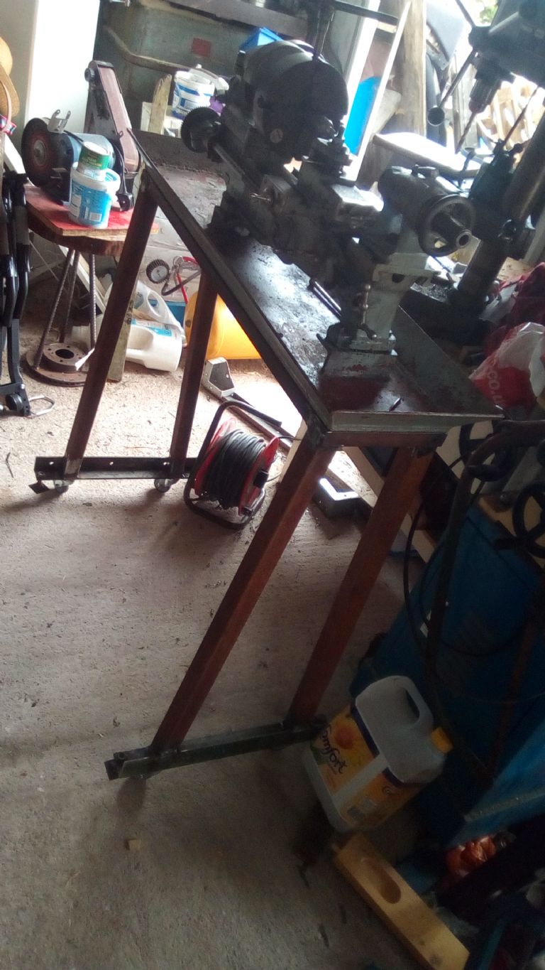

                                                Thanks for both suggestions and info Clive. I want to keep the footprint minimal and be able to move it around easily and just lower the jacks when in use.

                                                  Thanks Ady just explained to S.O.D. why I haven't done anything as yet. Only needs longitudinally. Top and bottom is connected front to back. Don't want to be around to experience the forces that will break these welds.thinkinglaugh

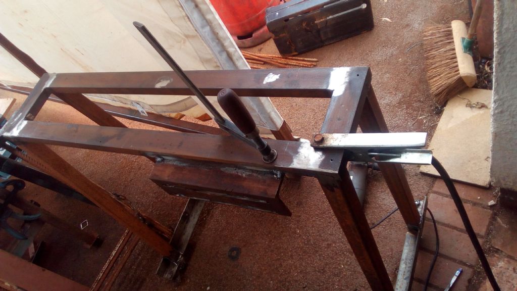

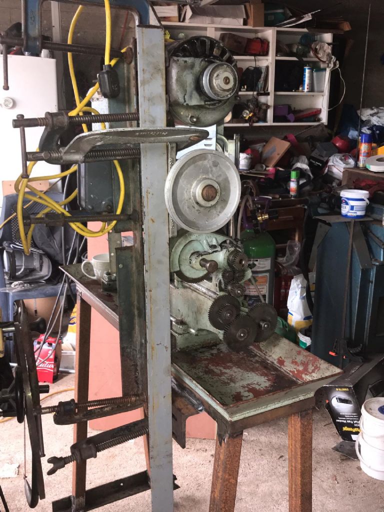

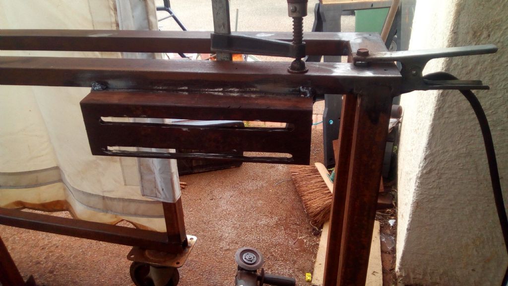

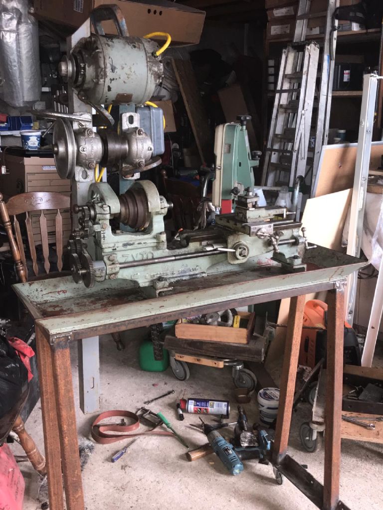

                                                    img-20200717-wa0009.jpgimg-20200717-wa0008.jpgimg-20200717-wa0007.jpgimg-20200717-wa0003.jpgimg_20200717_153350.jpgThanks to Lee & Brian for also popping in here.
                                                    I just tacked on a bracket to rear of stand which will hold a vertical frame (that I have yet to make) but managed to clamp on couple pieces of angle iron and clamped motor and countershaft to them to show roughly how they will be when finished. Obviously any thoughts to potential issues would be glad to hear it, the obvious one being ensuring clearance for the back gear shaft and just general accessibility to nuts and bolts on lathe etc.
                                                    I plan to sort belt tension between countershaft/headstock and motor/countershaft separately. It looks like previously between motor and countershaft nothing in place. Nothing fancy for that just a slot with captive nut and bolt to apply pressure to countershaft mounts. Then they will both slide in unison like in a lift shaft using the angle frame as a guide. With some stud to lift or lower. A bit like the action of a vice.

                                                      Well, you've moved all the weight really high up, made the base really narrow and put tiny wheels on it.
                                                      I would suggest that you never move it like that, running those wheels into any dip like the joints on those bricks in the floor will likely trip it up. You should at least be using the size of wheels from that mobile screen you have in the last photo.
                                                      I've got a cheap Halfords tool chest with that size of wheel and it gets stuck on anything.
