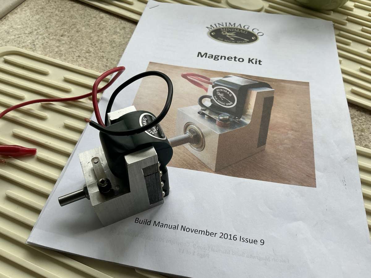

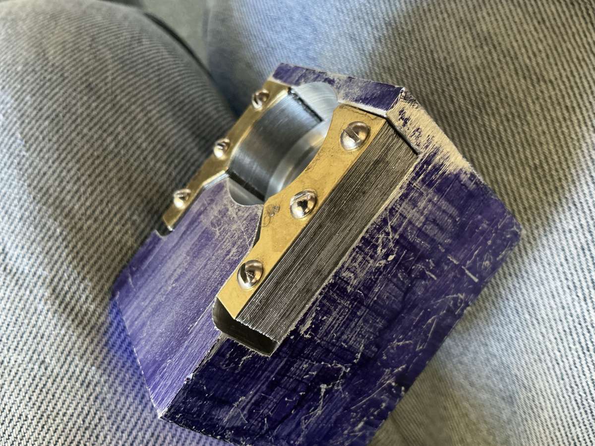

        I’m having a go at a small magneto (for a future engine) and have got this far, not tested for spark as yet.IMG_4100IMG_4095
        #849121
        paul rushmer
          @paulrushmer83015
          hello bernard I built one a few years ago it did not work. I spoke to minimag who sed it was probably the timing, they did how ever offer to fix it as long as my machining was up to scratch. I was going to try it on a tom senior but could not decide wether to run it at crankshaft speed and wast a spark or camshaft speed? Nothing has been done just waiting for enthusiasm time.
          Paul
          #849132
          bernard towers
            @bernardtowers37738
            Hi Paul, have not timed it yet other things have got in the way.
            #849148
            Diogenes
              @diogenes
              ‘Expression of interest’ in hearing how the job progresses, Bernard.
              Is the body about 2″ square?
              #849188
              bernard towers
                @bernardtowers37738
                Its 1.7″ x 1.6″ x 2.3″ tall so its not that small but I guess that there is a limit to how small you can go and get a useable output. Ill leave that one up to Robert Im more of a mechanical engineer.

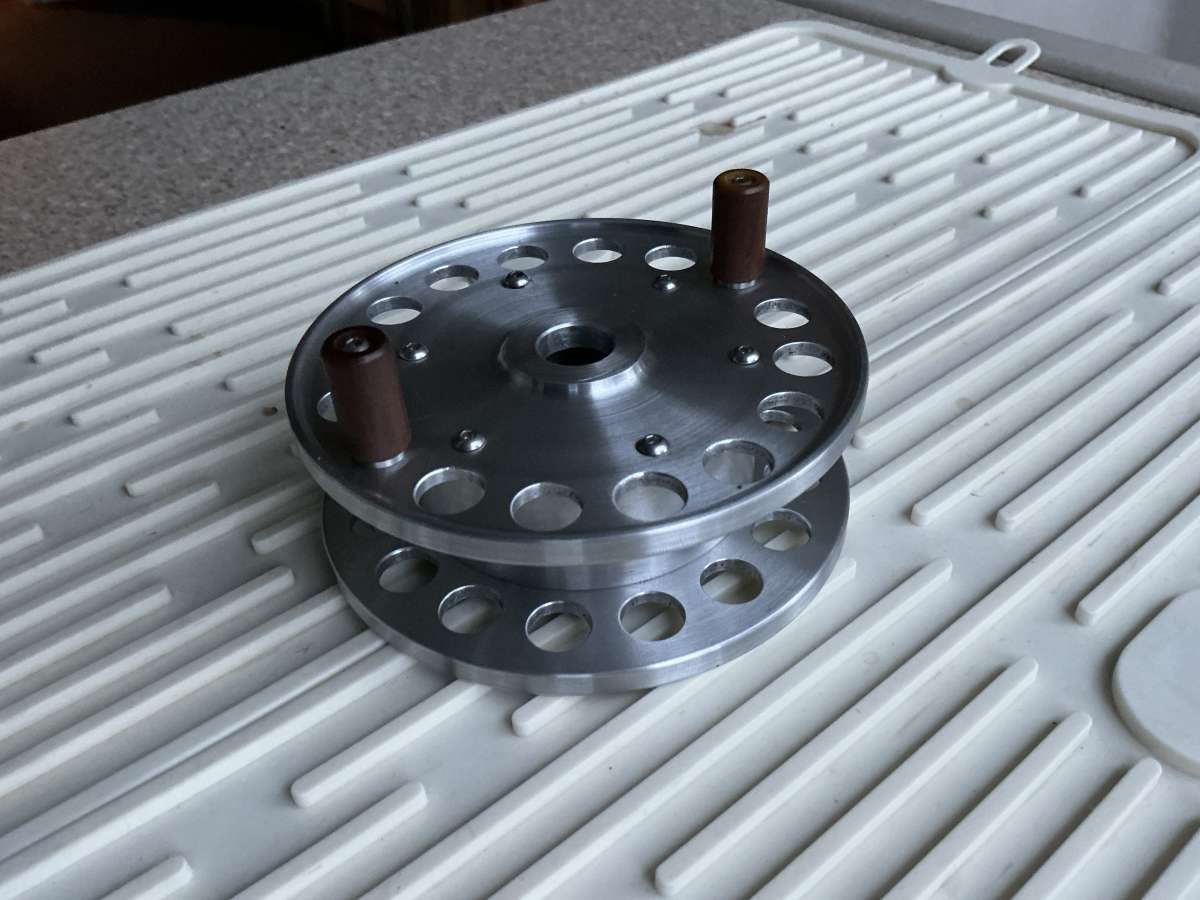

                  This is one of the other things thats got in the way. Neary time for anodising.IMG_4108
                  #849209
                  Speedy Builder5
                    @speedybuilder5

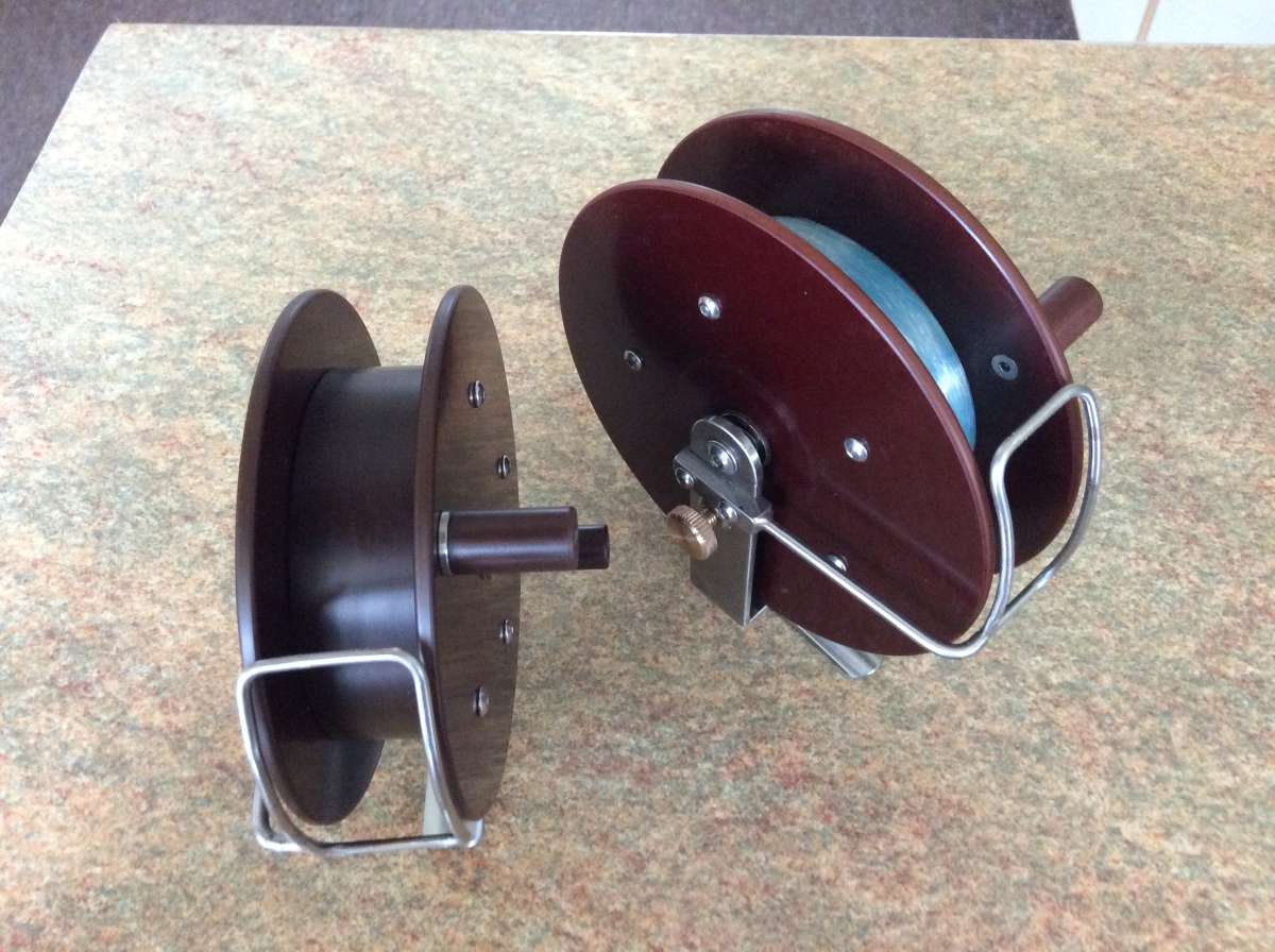

                    Very nice Bernard, do you fly fish ?
                    Bob
                    #849230
                    bernard towers
                      @bernardtowers37738
                      Yes I do but this one is 4 1/4″ in dia and is for trotting. I have made a couple before from Tufnol and are really nice to use.IMG_3926

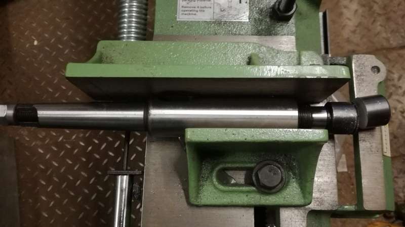

                        Hi, one little job I did today was to shorten the arbor end of a 2MT blank end arbor, I did try parting it of on my mini lathe, but it was just too tuff, and caused a lot of chatter. So my only option was to saw it off, but holding it made me think a little, as the MT end was threaded, I then remembered that I had a 3MT to 3MT shank extension socket, that I’d drilled though the MT end, so that I could use it in my old Chester milling machine so that I could reach down between some tall projections, on a job I did about 20 years ago. So along with this and a 3MT to 2MT open sleeve, I was able to fit the arbor into the extension sleeve secured with a long hold-down bolt and nut, so that I could cut it using my Bandsaw.
