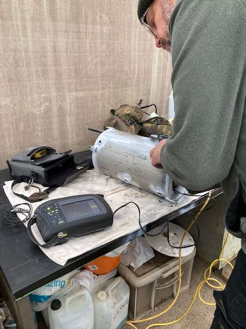

              Passed the first test with flying colours. Minimal degradation in plate thicknesses. All welds are sound-
              image0-2
              Will now engage the inspector for pressure testing etc, once we receive and present the paperwork.

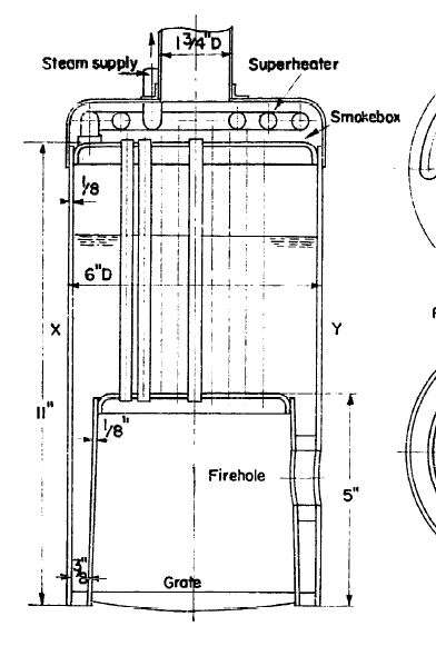

                  On JA Said:
                  I am not sure what I am looking at. This is a vertical fire tube boiler. Is the boiler contained within the steel work? If so, the welds in the photographs are not subjected to boiler pressure and would be adequate for the job. However as welds they are not impressive.
                  As a mechanical engineering apprentice I was taught that I could not weld and have been happy with that ever since. My experienece is that you should always use the best welder you can find and if anyone says they can weld just disbelieve him.
                  JA
                  The lower part of the boiler is constructed from two concentric steel” tubes” so there is a water space all around the fire. The inner tube stops at the lower tubeplate so water surrounds the smaller expanded in tubes and extends all the way to the full length outer shell. So all the steel is under boiler pressure. Something like this.
                  I’d be happy if my welds were half as good as those😂

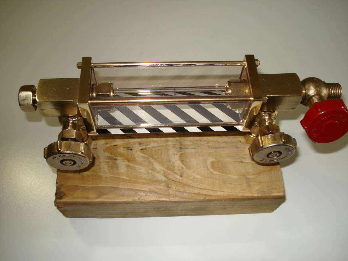

                        Making progress with rebuilding the Mower and refurbishing the power unit. Several items need attention, one of them is the Gauge Glass, which had no protection. I’ve just finished making a Protector for it-
                        DSC03123
                        Have a date for the next stage of boiler Inspection/Pressure testing at the end of the month.

                          Just to update the progress on this project. The boiler has passed the inspection and hydraulic pressure test today.
                          The next certification stage will take a while, as there is the Mower rebuilding work and some redesign of the power system and layout, partly to satisfy current compliance for public display. I’ll update when reasonable progress has been made.
