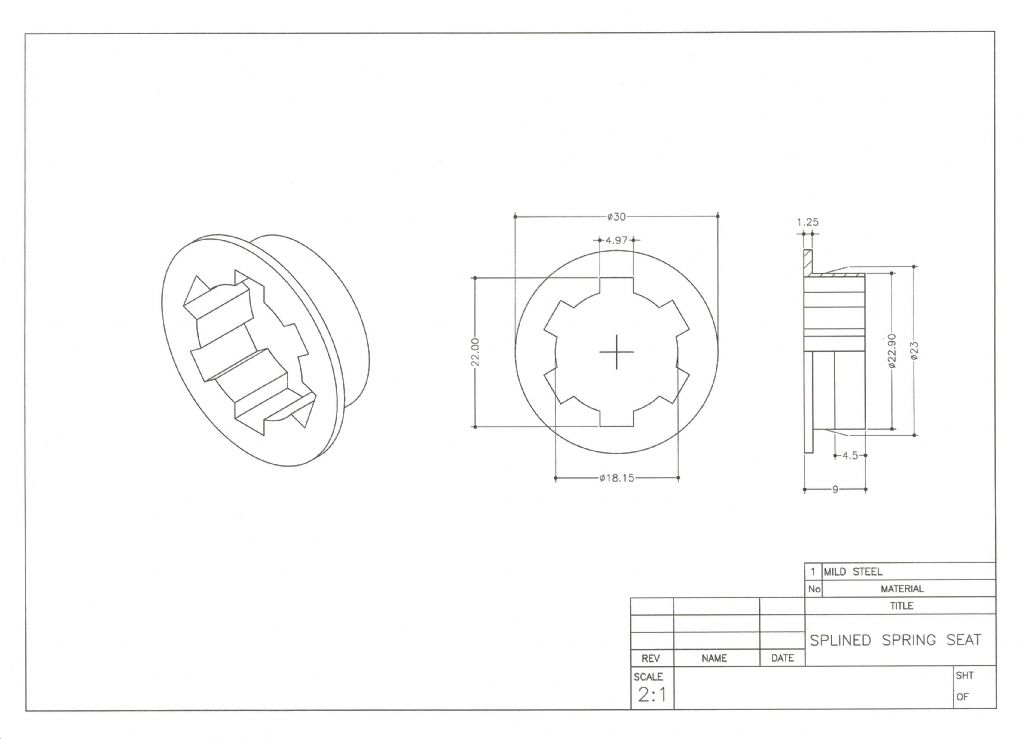

      There is one Quirk that has plagued me with the FB2 over the past 35 years or so. That is a growling noise in the 1100 RPM range. I must add that my machines have always been Single phase, so I cannot say if this happens on the 3 Phase machines.
      One machine I had early on would also exhibit this characteristic in the 680 RPM range. In all cases the noise would disappear as soon as some cutting forces were present, only to reappear when the machine was running light. I have postulated an umpteen theories over the years as to why this happens. None of the remedial fixes tried for each theory, had no or little effect. On one machine the growl would only start when the machine was warm. My current machine would growl what ever the temperature of the machine, or the workshop.
      Changing the viscosity of the oil and the oil type, have had little or no effect. A recent overhaul showed the Sliding Gear, (Part No E3A 010 060) and the Gear Bank (Part No E3A 010 070) had signs of wear due to the misalignment of the selector arm. All of the other gears were in perfect condition. Even showing signs of the original grinding marks on the gear form. Replacement gears made no effect to the growl once the machine was reassembled.
      A couple of weeks ago at long last the Penny finally dropped. The FB2 uses a Helical spring around the upper part of the Spindle to return the Quill. One end of the spring rests on the splined drive gear, the other rotates with the spindle via a spring seat on the spindle. There is some play between the splines but as my machine parts are with-in drawing limits it cannot be from wear.
      What I believe is happening is that the spring being a torsional member is allowing the spindle to oscillate on the splines due to the design clearances. When the spindle is loaded the clearance is taken up. I also believe the Cyclic nature of the Single phase motor adds to this, in the 1100 range.
      Having postulated one more theory I thought I would add the splined spring seat above to the spindle. The splines on this seat are a nice sliding fit over the spindle splines but with hardly any play. The machine has been used quite a lot over the past couple of weeks and so far there has been no growl. If anything the machine seems quieter throughout the range, but I may be suffering the placebo effect on that one. One can hear a cyclic variation in the tone of the machine which could not be heard before in the 1100 range.
      Regards
      Gray,

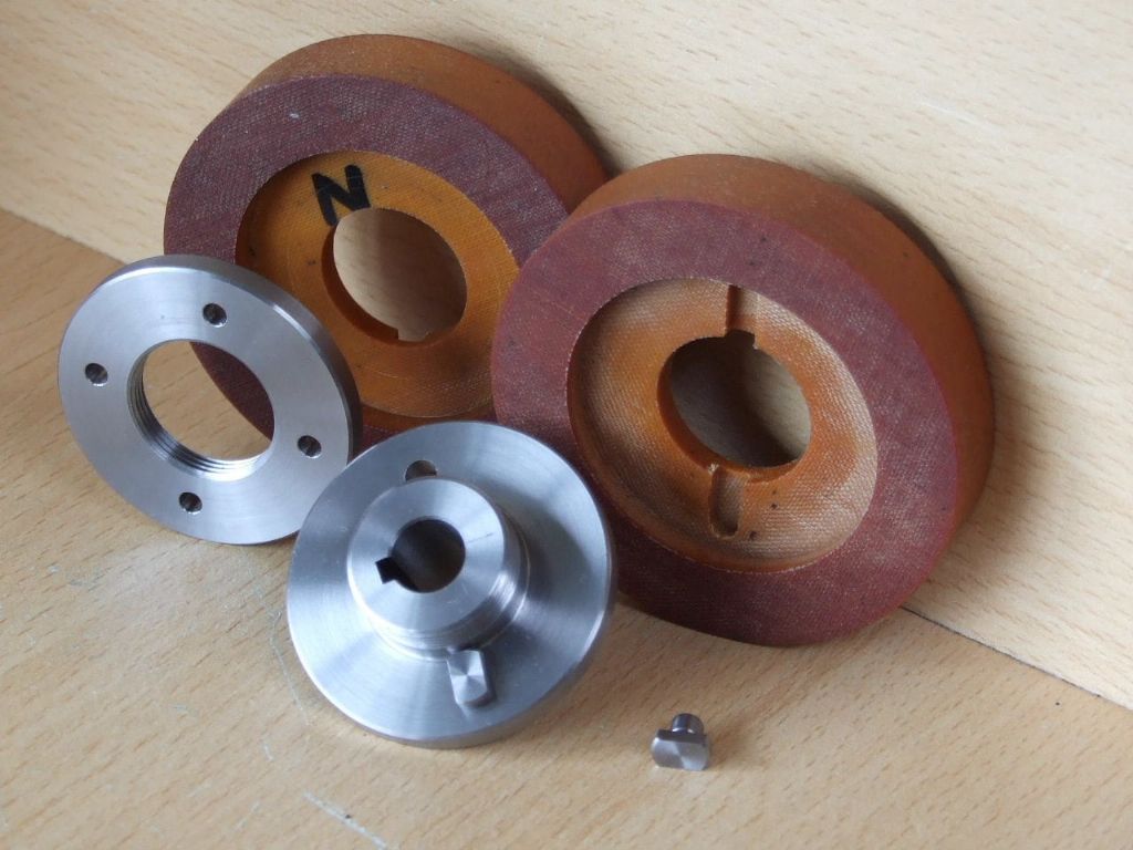

        It has been a while since I posted details about the FB2 Tufnol Gear 47. John Slater has kindly produced a 3D view of the proposed design which I am currently working on.
        Emco press their Tufnol gear onto the arbor over a coarse knurled diameter. The gear is retained with what I presume to be Epoxy glue from what I can see. I would expect the gear teeth are then machined after the parts are assembled.
        Trying to make the gear separate and pressing this onto a knurled arbor did nothing to inspire my confidence in maintaining any form of concentricity.

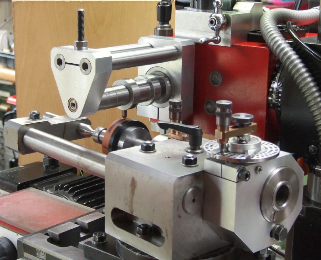

        To this end it was decided after quite some debate between John and myself to drive the gear with two face keys and retain the parts together with a Ring Nut. This type of construction lends itself to the use of other materials for the gear, such as Delrin. Which might present problems if the assembly was just glued together. Without that is resorting to some form of exotic glue. The Ring Nut will be locked on assembly by drilling an tapping M3 through one of the Peg spanner holes, (one that is not over the drive keys, hence the need for 4 spanner holes) and inserting an M3 Allen grub screw.

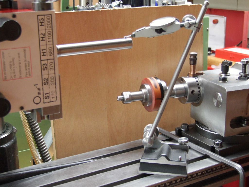

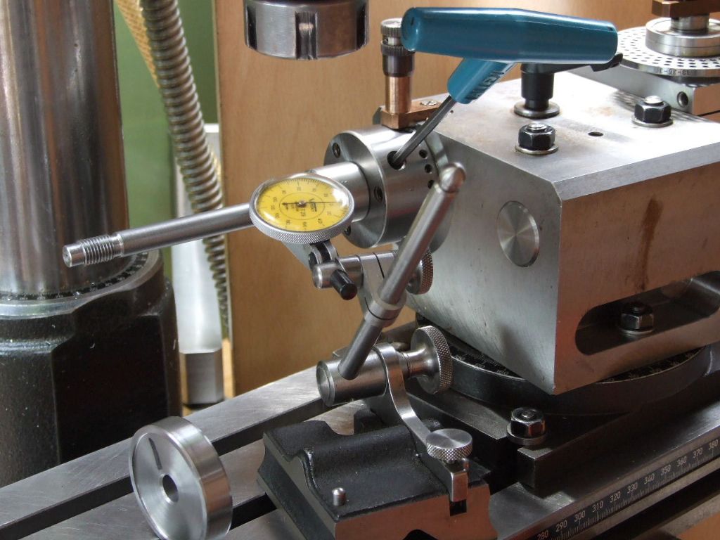

        The Dividing head has been rotated through 8 degrees and the DTI is being used to check the angle over 30 mm of cross-slide travel.

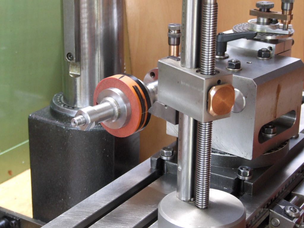

        The Mandrel to mount the gears is next checked for concentricity and adjusted using the GHT, Versatile Dividing Head method.
        Once the gear is assembled with its black Delrin backing piece, (to stop the Tufnol delaminating during cutting of the Gear) two lines are scribed 0.2 mm above and below the centreline. Similar lines are already marked on the width of the gear blank. After which the gear blank is rotated trough 90 degrees to get the marks at TDC.
        These will be used to centralise the cutter over the blank. The cutter needs to make contact in the 0.4 mm square. Once that is, the FB2 has been configured for Horizontal work which will have to wait until tomorrow.

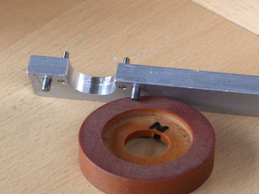

        Below is the double side Peg Spanner to fit the Gear and the FB2 Quill Assembly,

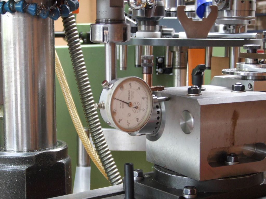

          The first operation today was to clock the Test Mandrel parallel to the table.

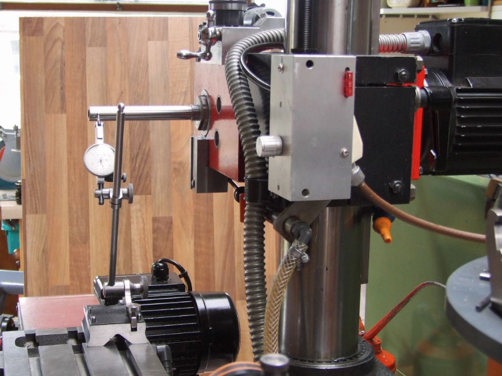

          After which the Column of the milling machine is rotated through 90 degrees and the Test Mandrel clocked parallel to the Y-Axis movement. The Mandrel was again clocked over the top to ensure that it was still parallel with the table.
          This view shows the Dividing head repositioned to the other end of the table nearest the table feed motor. The Over-arm support for the arbor has been added as well as the Centre support bar on the Dividing Head. The cutter was set using the scribed lines from yesterday and a trial cut taken to see if the cutter was equally disposed about them.
          Lastly a close-up of the witness mark. Tomorrow I hope to cut the gears in earnest.

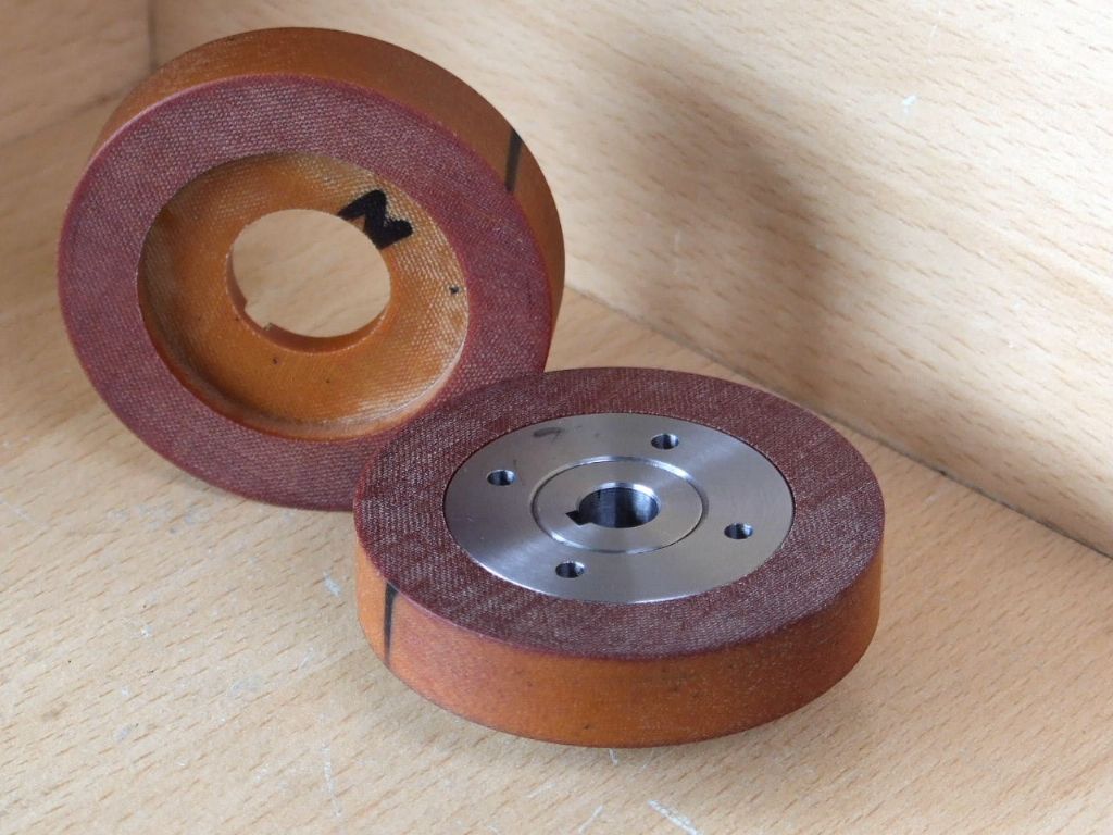

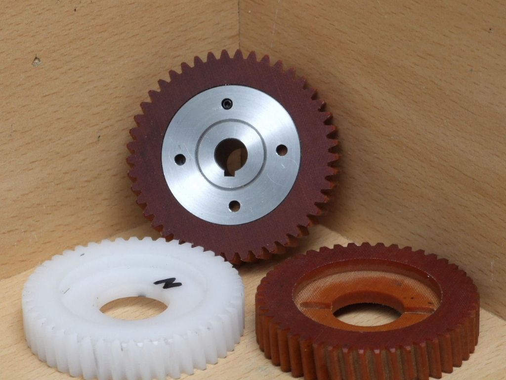

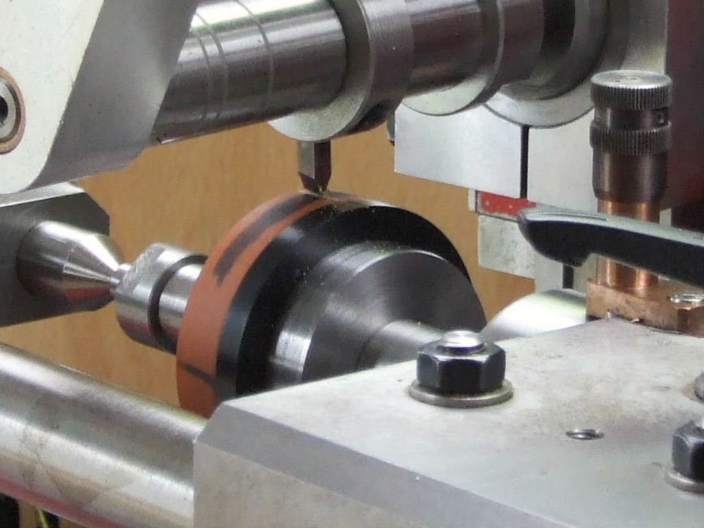

            Yesterday was a good day, I managed to cut the Tufnol gears as well as some Delrin ones. When I started out to do this project I did not know I had the Delrin, so when I chanced upon a billet yesterday, I thought why not make a couple more spares.
            Above is the finished assembly and some spares, note the M3 Grub screw to lock the Ring Nut at 12 o'clock. I find clicking on the photo gives a better view.
            For comparison the new Spare part on the left and the Original taken from my FB2.

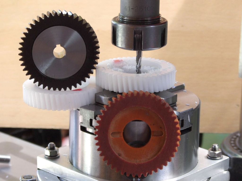

            Lastly machining the Keyways in the Delrin gears. The Spare Gear assembly is driving the machine and the Emco Original. Just to show the gears work and to remove any doubt about suitability.
            While the gear produced yesterday is not a true Helical Gear, the FB2 is not grumbling about the fact. There is certainly no difference in the noise levels or the backlash between the motor gear and the Spare. If anything it may be very slightly less.

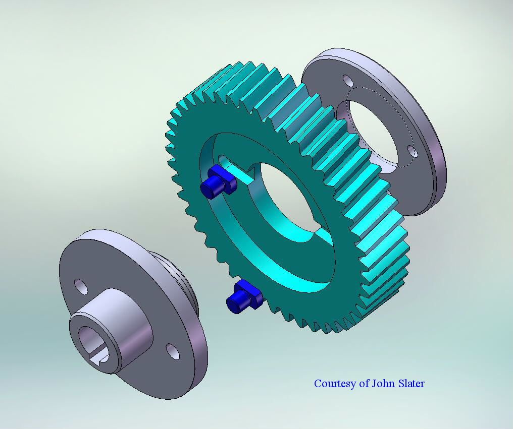

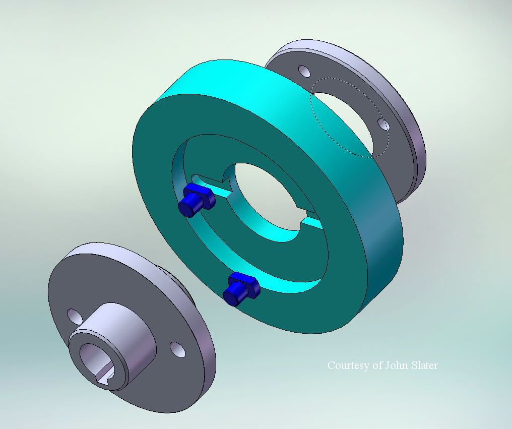

              For those following this post John has added the gear teeth to the 3D view. For readers who would like further details in the form of drawings, I am currently preparing an article for MEW to be published shortly.
              Regards

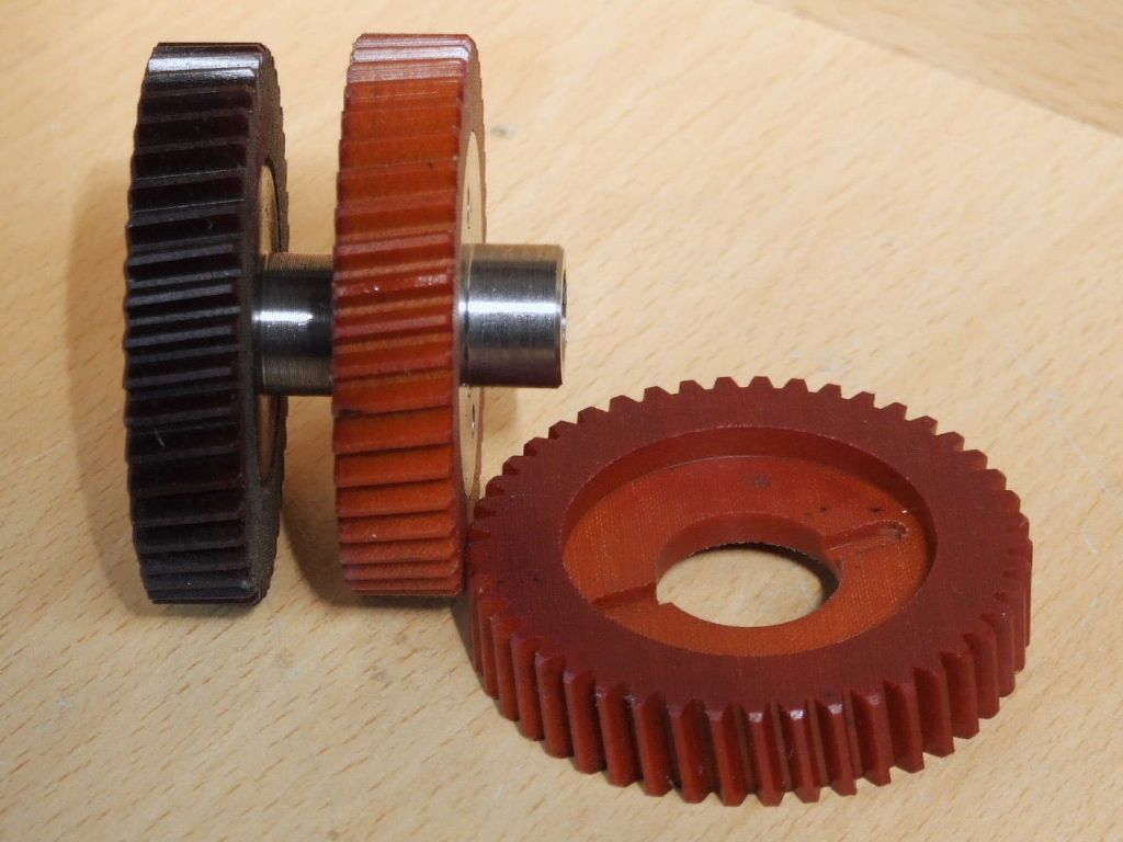

                As promised in the article and above, I have now had chance to trial the new FB2 Tufnol gear. Having done quite a bit of heavy milling with my inserted tip 50 mm diameter Face Mill on Mild and Tool Steel. As well as the Emco 40 mm diameter HSS Face Mill. I decided it was time to take a look at how things were doing in the gearbox.
                This is the condition of the new gear on the Right compared to the original on the Left. Despite the new gear not being a true Helical gear there are no signs of scuffing on the edges of the teeth. Which is where I would expect to see some.
                Currently I am running the Delrin gear, which to me seems quieter still. I have not had a chance to do any serious milling with this gear as yet, property maintenance has got in the way, but that will soon change after this week, as a new project is started.
                Regards
                Gray,

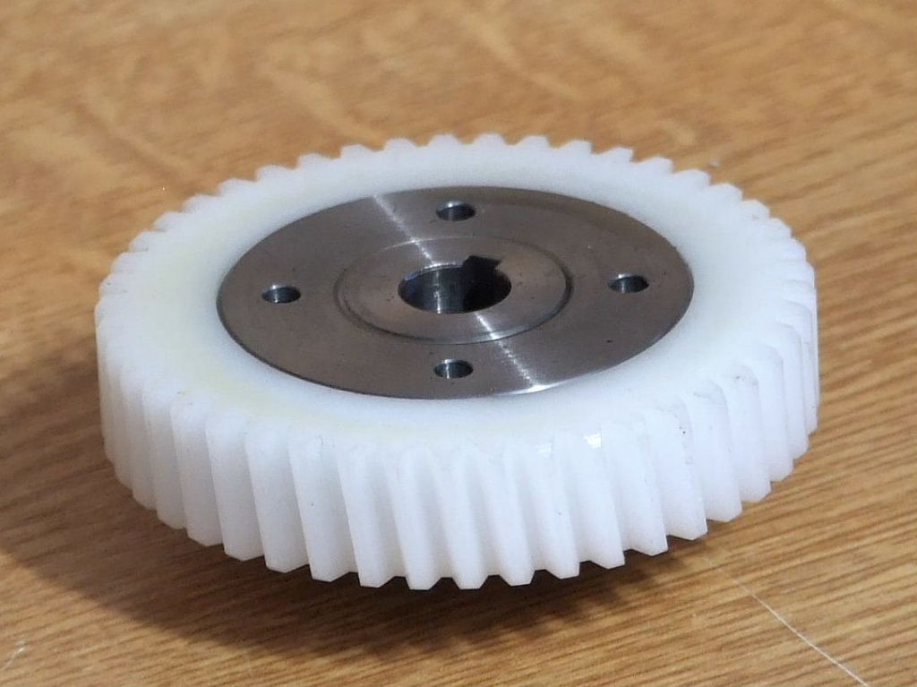

                  As the FB2 is going shortly I thought I would share one last photograph with those who have been following the post.
                  I have given the Delrin Gear assembly an extended trial since my last post. It has had a solid 6 months machining a wide variety of materials, with different metal removal rates. The gear shows no sign of distress and if anything it was a lot quieter in use.
                  I hope all those who have followed this post have found it interesting and helpful.
                  Regards
                  Gray,

                                                  Can I suggest an alternative to a plastic or composite material for the gear?   How about cast iron, the basic grey to take full advantage of the inherent damping properties of cast iron.  Have the teeth properly formed by hobbing or, at a push, shaping, not to costly, worth the expense to get long life and quiet running.
                                                  #871397
                                                  Graham Meek
                                                    @grahammeek88282
                                                    As I have said many times before, in the forty years that I owned FB2’s I never once had a failure of this gear. I put this down to not using the slowest speed to lock the spindle to undo the drawbar to remove tooling. Which is I believe the root cause of the problem.
                                                    To avoid using the rather awkward spindle spanner that Emco supply. I designed and fitted the Spindle Lock shown earlier in this post. The time spent making this attachment leads to more efficient working and is time well spent.
                                                    Regards
                                                    Gray,
                                                    #871402
                                                    engineeredbyhansson
                                                      @engineeredbyhansson
                                                      Regards
                                                      Gray,
                                                      Mine broke when I was facing at 1200rpm, 1mm depth of cut in steel (355N/mm2) with a 40mm cutter with 3 carbide inserts. Feed rate unknown as I handcrank for now. I guess this is a little to much for this small machine with the 0,18kW motor? I don’t know if it got damaged from a earlier tool swap but I get your point. I am certainly a beginner when it comes to machining and I learn something new every day.
                                                      Your spindle lock solution looks very tidy. I also like your solutions for the quill lock. I will do something similar.
                                                      Regards,
                                                      Jim.
