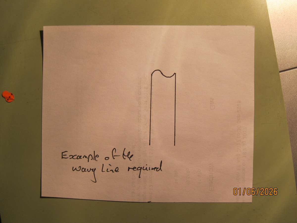

      Hi all – I am currently using AutoCAD 2000 for my 2D drawings would like to be able to insert a wavy line (similar to a sine wave) as commonly used to indicated that only a small proportion of  a disproportionately long object is being displayed. Initial thoughts centred on using the Polyline feature but I cannot get it to deliver the required results. Any advice would be most welcomed.

          #850466
          Greensands
            @greensands
            I have attached a hand drawn example of the ‘wavy line’ symbol indicating a truncated object which I would like to be able to reproduce using AutoCAD 2000.
            Line Break
            #850467
              It appears that the ‘problem’ is that AutoCAD does not support that ‘curvy’ convention, but instead uses the jagged breakline.

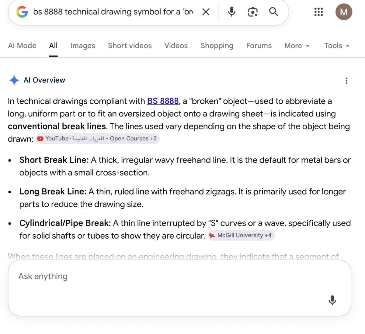

              #850468
                This may [with the usual AI caveats] help explain

                #850480
                DC31k
                  @dc31k
                  What you are looking for is called a ‘pipe break symbol’. As above, a search suggests the BREAKLINE command, using a block, is one possibility.
                  What you have drawn in your own sketch is incomplete in those terms as the convention is to use three arcs.
                  If you only want two arcs, and there is an automatic way of doing it, you would have to delete one of the ‘factory’ items after insertion.
                  For what it is, two arcs meeting on the centreline of the object, would it not be simpler just draw to them thus as two individual entities?
                  You only need to do this once per drawing as you can then copy and scale them thereafter.

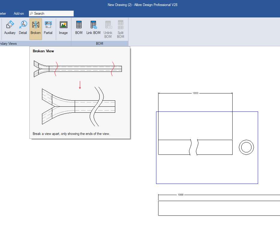

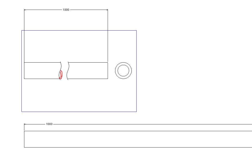

                      Not good to actually draw the part broken as how do you dimension it when the dimensions on a 2D drawing are derived from the part.
                      If it is anything like Alibre then create the part full length so it can be changed at any tiime and looks right in an assembly. THEN when producing the 2D drawing look for a “broken” or similar option. Alibre does give a few options for the form the break lines take but it only does round objects like Greensands sketch not the correct way that should show the “cut” edges if a round item.
                      This is a 1000mm long part broken to fit an A4 sheet and the unbroken one below, red is how it really should be shown for round items
                      broken
                      broken drop
