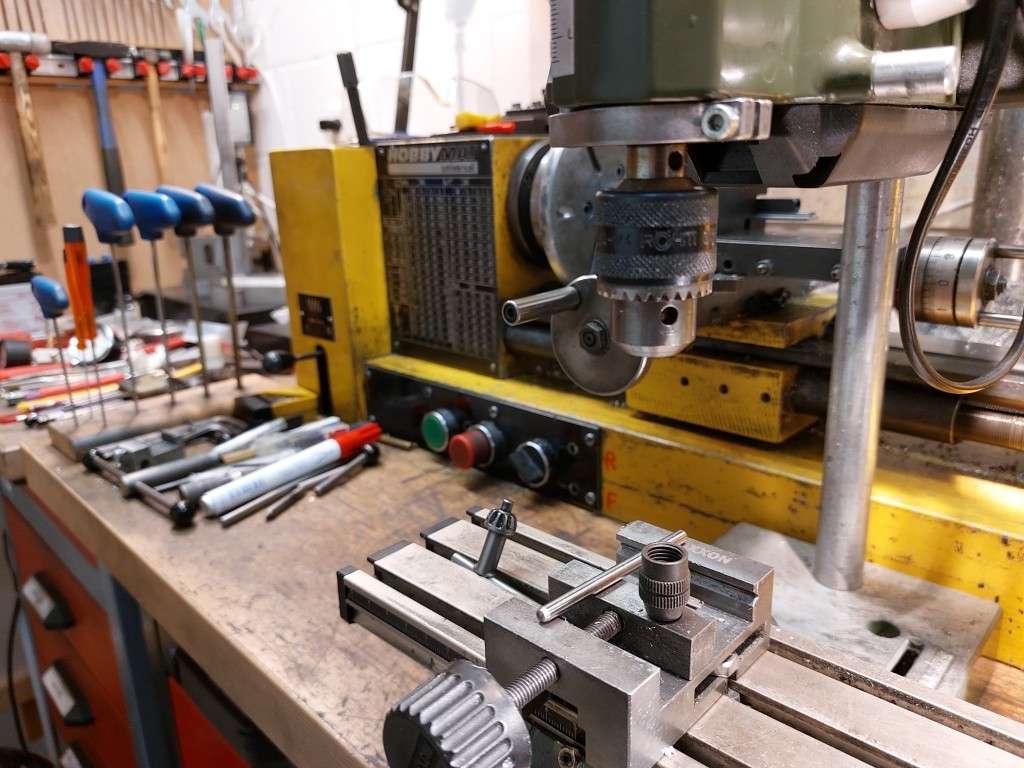

                        Graham Meek
                          @grahammeek88282
                          Proxxon do not list a drill chuck for the MF70. I am fairly confident the spindle nose thread on the MF70 is M8 x 0.75P whereas the TBM 220 Drill is 3/8″x 24UNF.
                          As the Collets are double tapers they do tend to clamp parallel within reason. Bristol-Ericson use a similar principle, but with 3 tapers.  Draw-in collets do not do this as Michael has already pointed out.

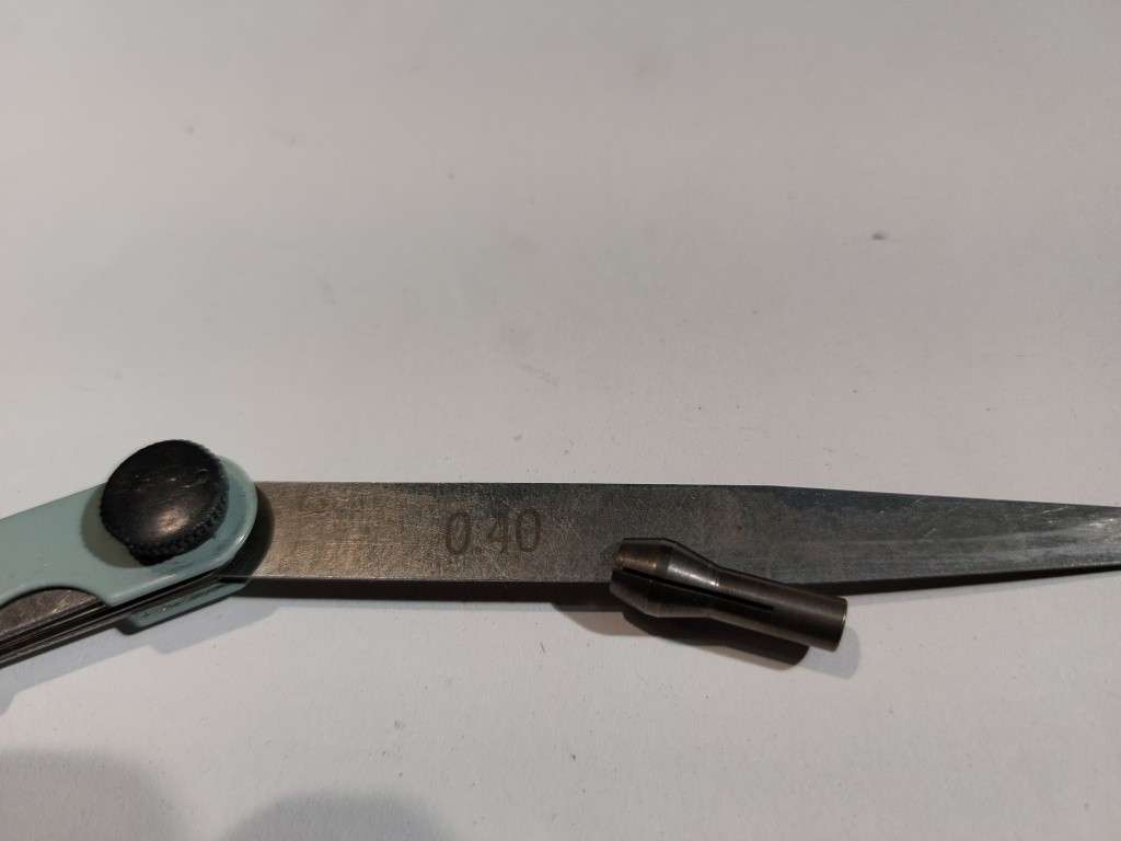

                          Roger B
                            @rogerb61624
                            As Graham says the two machine spindles have different threads.
                            The drill will take a Rohm geared chuck as well as the collets. The drill also has a 4mm hole through the spindle to allow the drill chuck to be removed and replaced and to allow the collets to be properly tightened.
                            TBM 220
                            The mill has a smaller spindle and just takes the collets. Both the spindle and the collet nut have spanner flats to allow the collets to be properly tightened (important with double taper collets like for ER collets).
                            MF 70
                            The collets have 0.4mm slots which will limit the clamping range.
                            Collet Slots
                            As a trial I put a 3.2mm collet in my MF 70 and clamped a length of 3mm rod. This seemed to rotate without wobble.

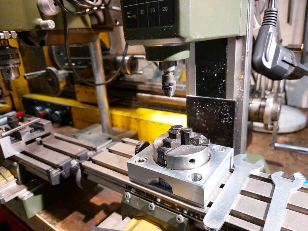

                                        #850461
                                        John Haine
                                          @johnhaine32865
                                          I have seen two styles of chuck for the Proxxon.  One is as Gray describes.  The other (which I have) came with my Proxxon drill stand and is a proper “Jacobs” style with a chuck key and is pretty good.  Screws on the standard thread.
                                          I have to say that I was very disappointed with both my Proxxon purchases. Style over substance I thought.

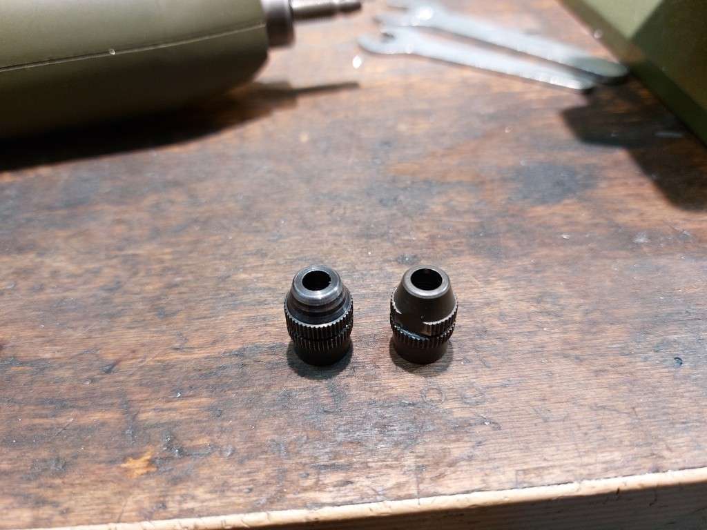

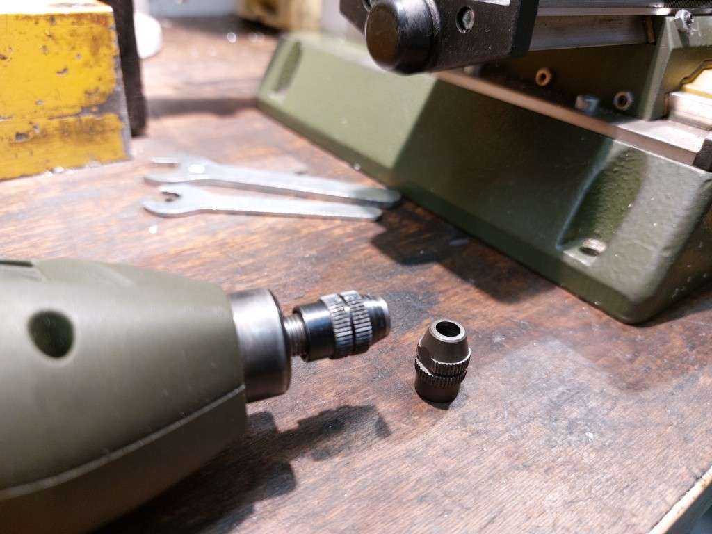

                                              #850631
                                              Roger B
                                                @rogerb61624
                                                The collet nut that came with my Proxxon hand tool does not have spanner flats and from time to time I have had to use pliers to undo it.
                                                The collet nut that came with my MF70 has 10 mm spanner flats in the lower knurled section. The nut does not seem to be hardened so it should be fairly easy to file the flats. I guess that there are actually two part numbers, one for the standard nut and one for the milling nut.
