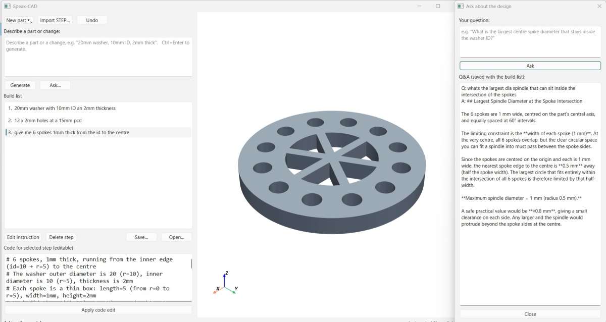

      … so I wrote a program where I could just tell it what I wanted. Like Minority Report but for 3D CAD.
      You just tell it in English what you want it to do.
      If you screw up you can back up to the last good instruction.
      I always wanted to use 3D CAD but could never be bothered with the initial learning curve.
      Now I don’t have to.
      You don’t even need to spell good!
      Screenshot 2026-06-02 130354

        Interesting idea – is it available for others to use?
        Depending upon capability it might be good for those who struggle to learn current systems.

          Chat GPT will generate STL files according to written instructions.  Says that it can’t do other CAD formats at the moment.

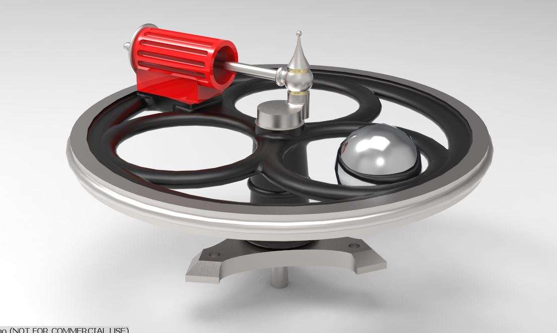

                    Funny you should mention Starships as I was wondering how much I would have to type to get it to come up with my latest engine which I have named “Orbital”.
                    Hopefully just asking for 2mm radius fillets to the spoke/rim joint will get the desired result as CAD failed to add that size fillets, luckily I have a cunning plan that will work on the machined part if not the 3D model.
                    orbital 3D

                      Jason, presumably thar spherical thing opposite the cylinder is the boiler?
                      #850641
                        No, counterbalance weight – big ball bearing
                        #850653
                          How do you get the steam in?

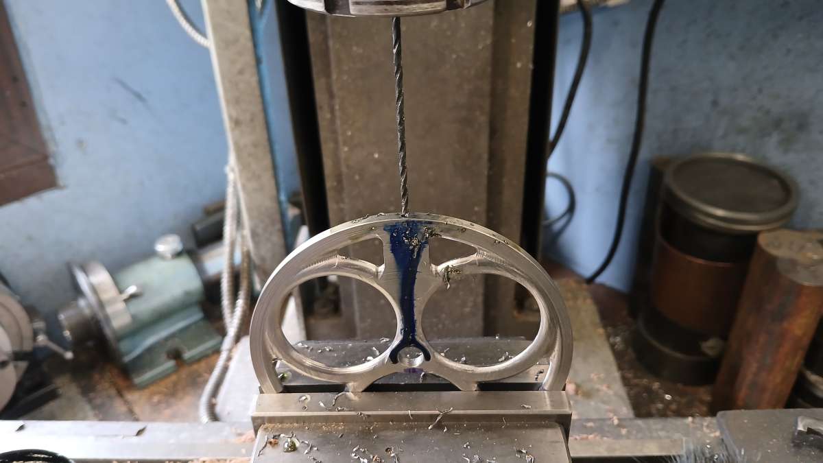

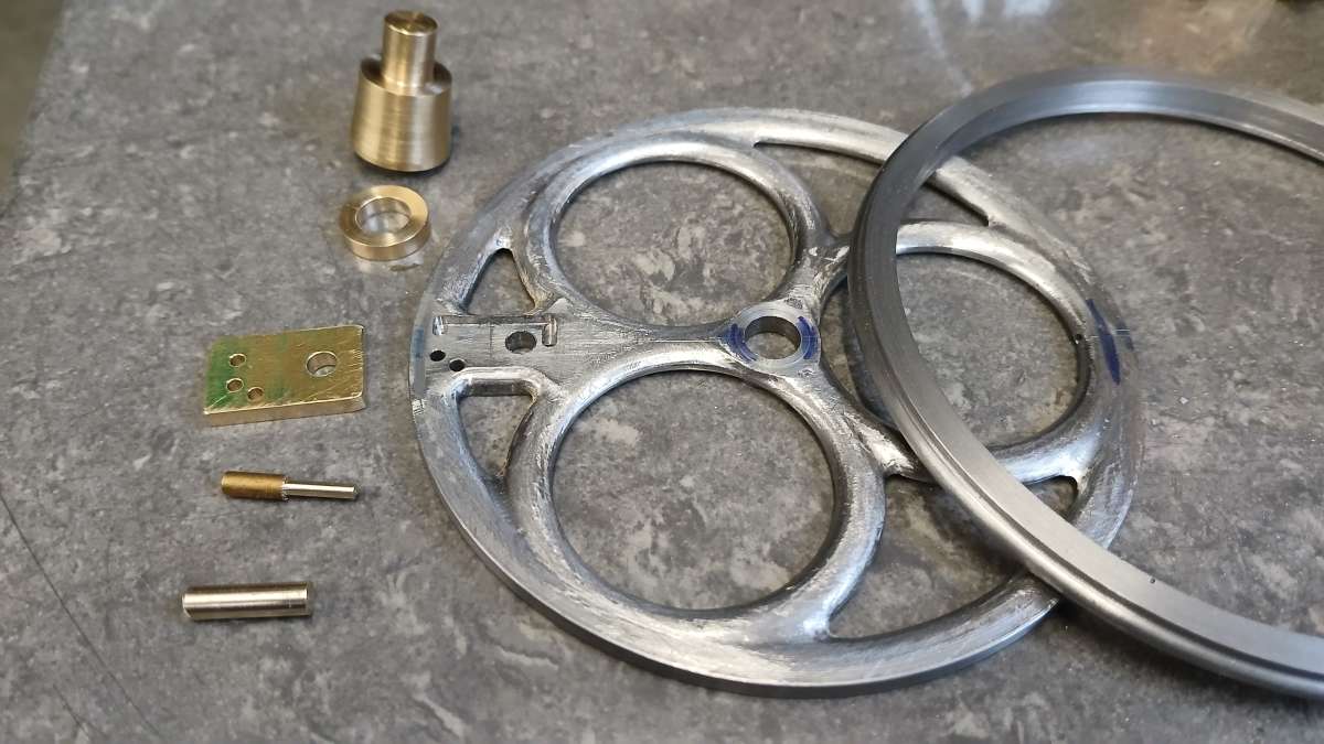

                            I have a cunning plan.
                            Spoiler on the flywheel progress
                            20260531_083030
                            20260602_134640

                                  Nope, it will be via flat faces rather than cylindrical ones. Though that could have worked with steam coming up the stationary crankshaft and out the side to meet a groove in the flywheel hub and then out along the spoke to the portface
                                  Think of how the cylinder fits to the port face on a typical oscillating engine and then extend the port in one face so it is a complete circle. You then get continuous steam/air transfer as the flywheel rotates.
