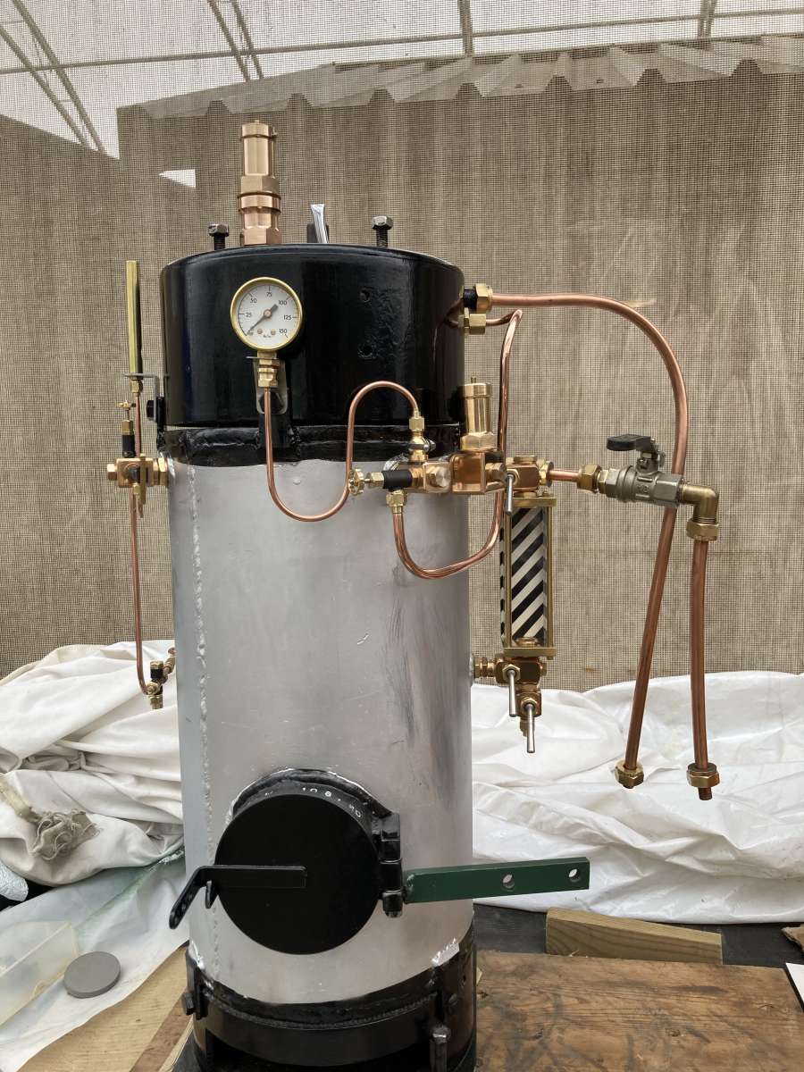

                        Making progress with rebuilding the Mower and refurbishing the power unit. Several items need attention, one of them is the Gauge Glass, which had no protection. I’ve just finished making a Protector for it-
                        DSC03123
                        Have a date for the next stage of boiler Inspection/Pressure testing at the end of the month.

                          Just to update the progress on this project. The boiler has passed the inspection and hydraulic pressure test today.
                          The next certification stage will take a while, as there is the Mower rebuilding work and some redesign of the power system and layout, partly to satisfy current compliance for public display. I’ll update when reasonable progress has been made.
                          N.B. I mistakenly wrote initially that this Mower was a 14″, it is actually a 17″.

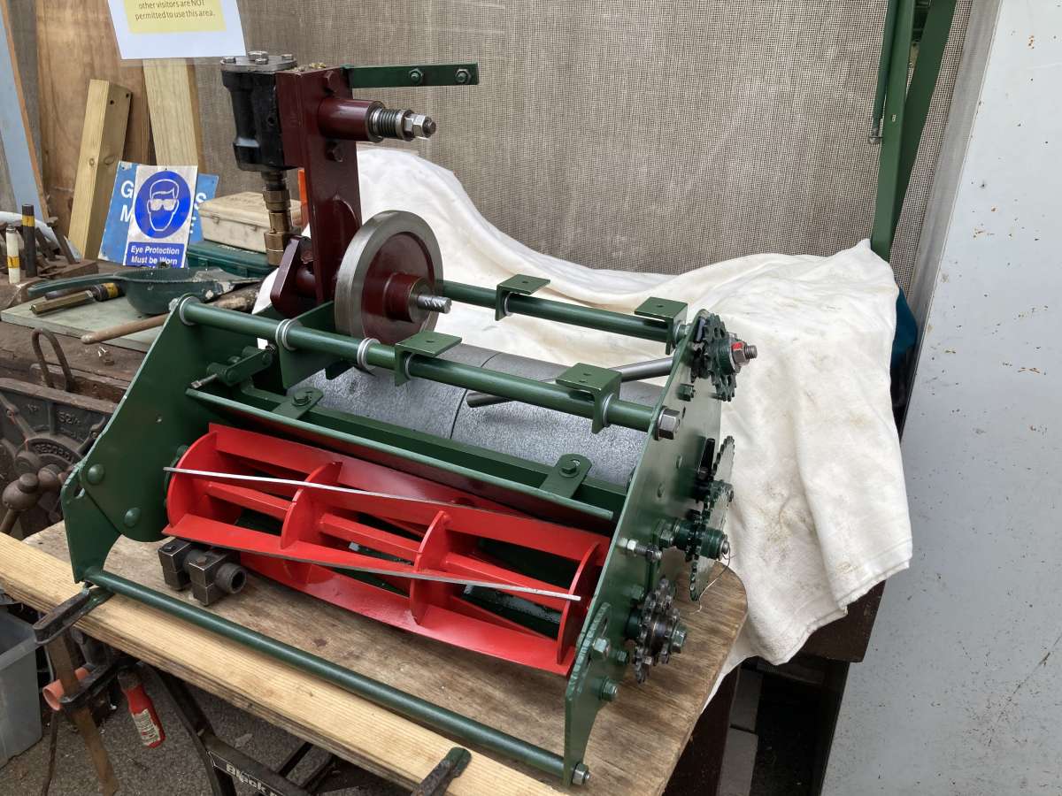

                            Have made some progress. The 17″ mower is coming on with the refurbishment-
                            IMG_0356
                            Found there is a 10mm discrepancy in the shaft alignments. Too much work to lower the motor, easier to align the frame bearing and adjust the chain(s) if required. the old universal drive joint is shown lower left in front of the cutting cylinder. I have to incorporate a centrifugal clutch close to the flywheel area, and a Dog Clutch in the sprocket drive area. This will satisfy the safety requirements for demonstrations/displays to mitigate risks.
                            I’ve also been busy on the boiler, spot facing all the steel bushings for mechanical/thread joint sealing, as previously only thread sealed. Manifolds, safety valves produced and Water Gauge/fittings all now either Gunmetal or Phosphor Bronze. Modified the Gauge Glass Protector to fit the new 3 cock version-
                            IMG_0357
                            Hope to make progress in the next month.
