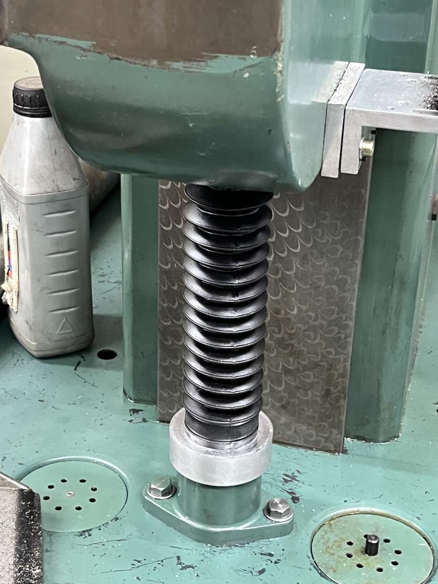

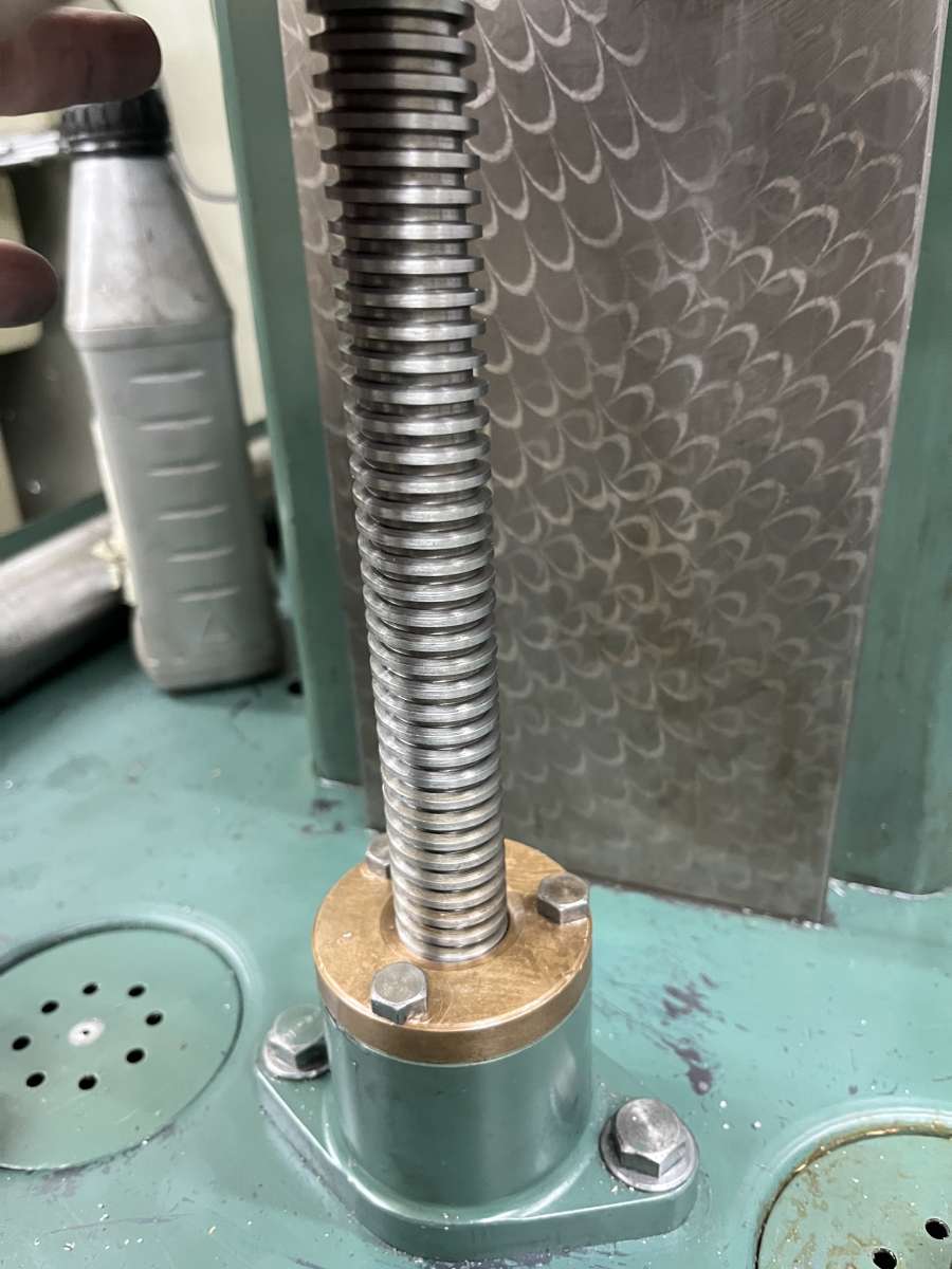

      I used a scrambler front shock absorber boot and a piece of scrap ali to protect my Tom Senior screw and nut from swarf for less than a tenner.  Just lift the ali to add oil.
      IMG_5534IMG_5536

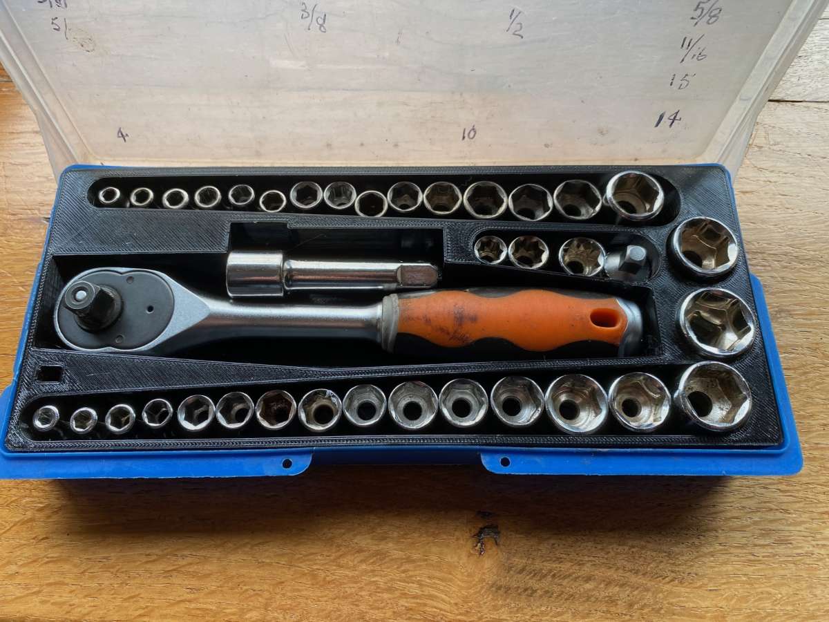

        Second attempt.
        Changed from ABS (Which warped badly on the table) and finally made a birds nest of plastic and “crashed” the print head.  This one had minor dimensional changes and I decided to use PETG instead. The run time reduced from 9hr 20min to 6 hr 40min and turned out as I wanted it to.
        SocketSet - 3

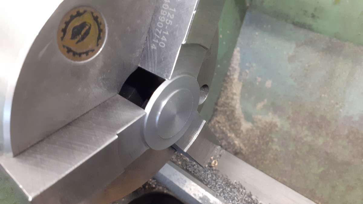

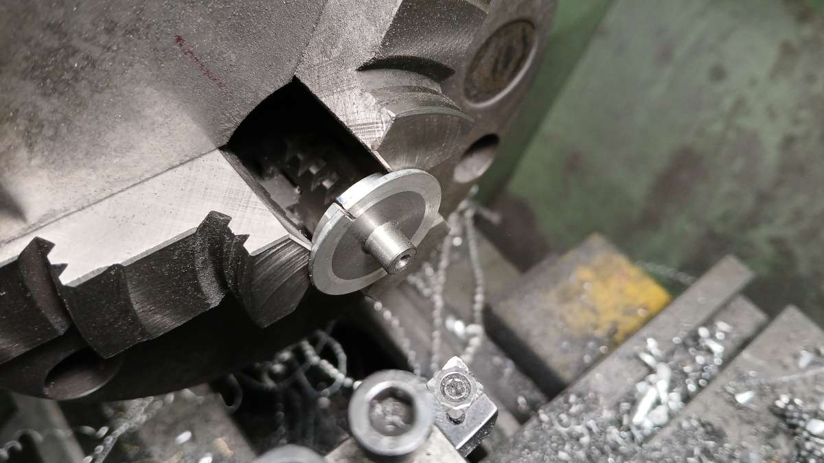

          Non magnetic washers?  Having machined the old and face with bevel how do I successfully hold to do the reverse. I know about wax chucks/ superglue etc but it’s soo slow. Any ideas.

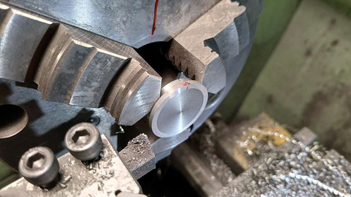

                Washers are 20mm diameter 8mm hole and 2.5mm thick with a45deg chamfer that covers half the thickness. I have thought of using the surface grinder by having a magnetic plug in the 8mm hole and a 20mm diameter fence round the outside but am frightened that it could still be picked up and then disaster.
                #838701
                  Cut your softjaws 2.25mm deep and away you go.
                  Simple split stepped bush would also work. These are doing 2mm thick parts 20mm dia
                  20251120_145215
                  20251229_144538

                    I think shellac chuck
                    is better as you can then break the sharp corner as well
                    will give it a go tomorrow
                    #838730
                      Still enough sticking out to take any burrs off the corners if done to the depth I said and no problems with getting the washer running true radially or axially, so your easing is equal all round.

                        Have made some shellac sticks today and experimented with the non magnetic blanks. Good results and shellac gives a very firm hold. I made the chuck with spigot so the washers were automatically centered. Interesting day!

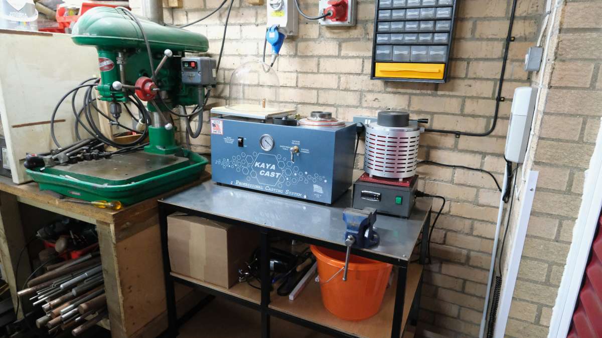

                              Finally got my investment casting set up finished last night:
                              Investment Casting Setup
                              Now I’ve just got to learn how to use it.

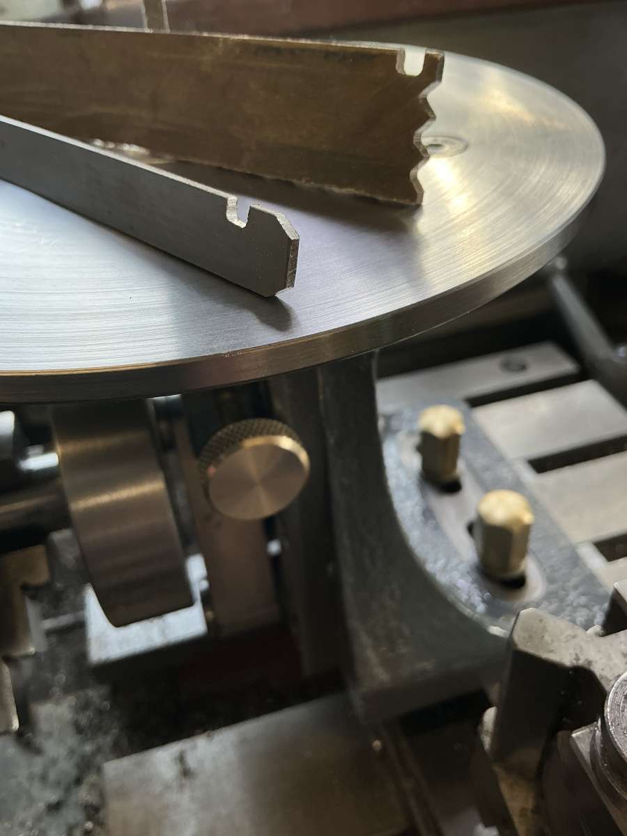

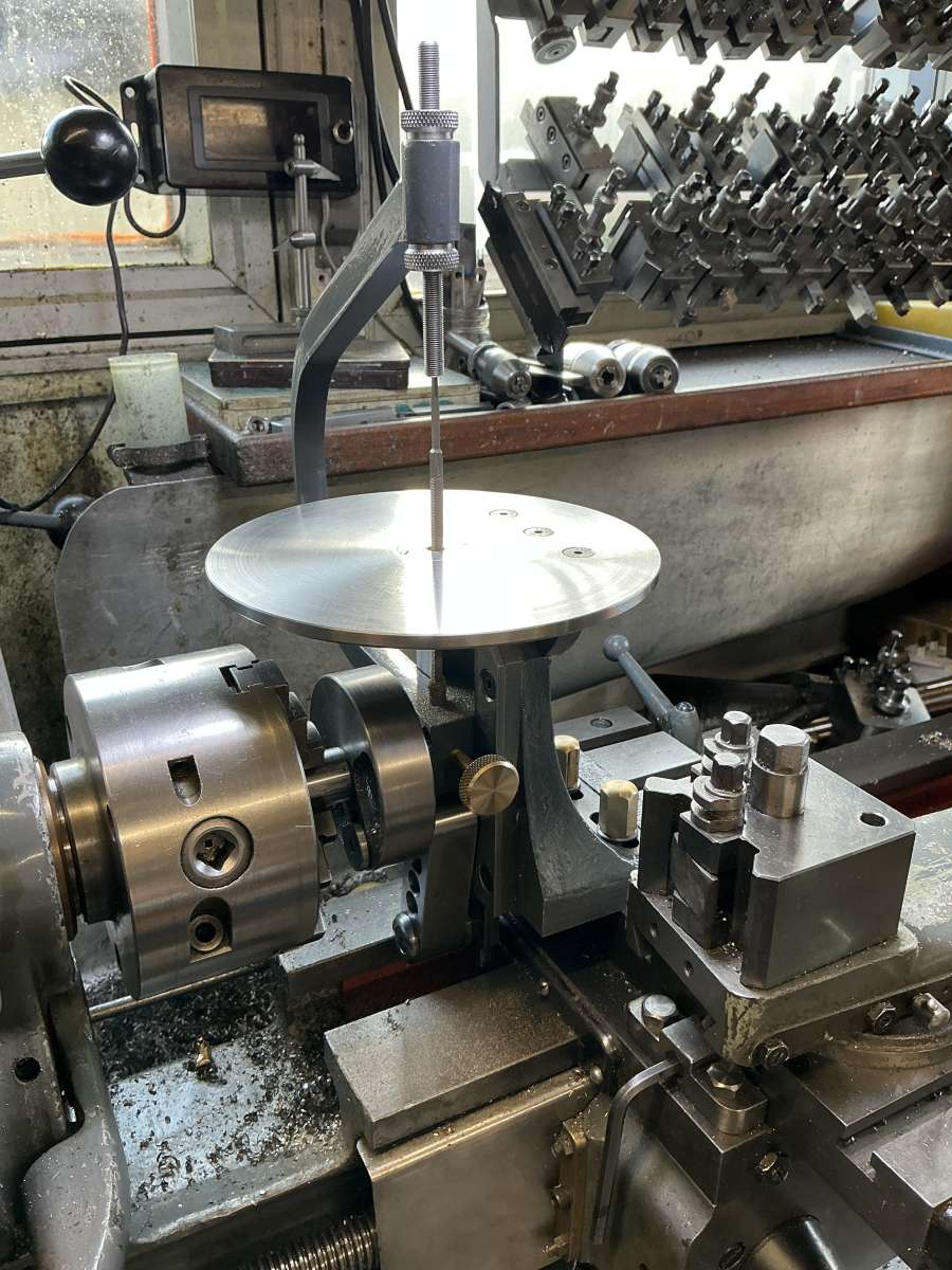

                              #838950
                              bernard towers
                                @bernardtowers37738
                                Set up and test run today, results are encouraging. File was coarse perhaps fine would be better.IMG_4061IMG_4058

                                  Please do keep us posted if/as you have the time – looks a handy little set-up and it’s always good to see a less-common process carried out in a H/WS setting

                                      #838992
                                      Dave Wootton
                                        @davewootton
                                        Very nice job on the filing attachment Bernard, something I’ve been considering, doesn’t take up too much room, would be very interested in how you get on using it. I did borrow a Butterfly die filer from a friend with a view to buying it but it took up a lot of bench space and was too heavy to lift on and off repeatedly, besides the seller missed it and wanted it back!
