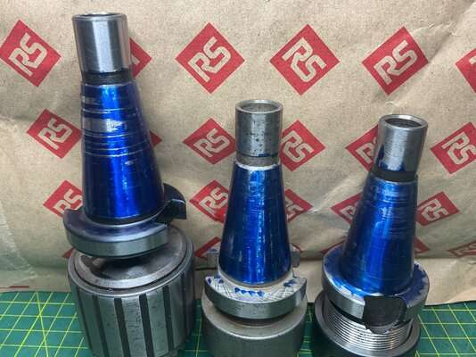

      Chasing down some runout on the Beaver mill. It looks like the fit on the 30 taper isn’t very good:
      IMG_1434
      What’s the best way to improve it? I’ve looked into lapping with valve grinding paste, and been told not to.

        To my mind you have way too much blue on the tapered spigots. Also what are you going to use as a reference taper? I would suggest as a first step going over the female taper and all the male spigots checking for damage etc etc.

          Is that marking blue you have used rather than engineer’s blue.
          #850546
          Andrew Skinner
            @andrewskinner94774
            It’s blue marker pen – I have some micrometer blue, but haven’t got the hang of using it yet. The reference taper will just be one of the toolholders. I’ve 3D printed one, with a view to making some sort of lapping tool, but not too sure about that.
            I imagine the female taper has suffered some damage from bits of swarf and various ‘dings’ over its lifetime, since 1961.
            Confession: I’ve just given it a very light lapping with some fine carborundum paste. Hardly any cutting, but it did make a nice matt finish and showed the marks up nicely. However, there are so many, that if I went at them all with a convex file, I’d end up filing away most of the taper.

              I would stop NOW ! Sit and study the issue and possible causes, then decide if you REALLY need the perfect machine or whether you can work within what you already have. Good luck.  Noel.

                Personally, I would follow Noel’s advice and think very hard before trying to improve the fit of the taper. Once you have taken metal off, you can’t put it back on.
                The dents in the surface are never the problem, it’s the high spots and they require a bit of thought before being attacked. Far too easy to end up worse than when you started.

                  The high spots are very few, and tightening the drawbar will pull the external taper into the internal one.

                    Ok, thanks for the advice. I turned a slitting saw arbor on the lathe, fitted it into the INT30 collet chuck and ran it in the mill, and it wobbled visibly. Even with the saw blade off, the shank and boss of the arbor, which were turned in the same operation, ran out by about 6 thou.
                    Suspecting the collet chuck, I clocked in a length of silver steel on the lathe four-jaw, clamped on the collet chuck and measured the runout on its taper – 3 thou at the top, 1 thou at the base. Not too bad, since it was only 10mm silver steel and there may have been some sag and deflection.
                    The inner surface of the 30 taper runout was under 1 thou, but I could feel those dings inside, hence the blueing saga.

                      Yes you are right about sag and deflection with a 10mm bar! I would take those readings with a very large grain of salt.
                      I also would not use your shop-made slitting saw arbor to measure runout because you may have turned the taper just a fraction out and it is not seating correctly. You really need a reference taper to check it against with blue.

                                  I’ve measured the runout of a 10mm carbide milling cutter in the collet chuck. 1.5-2 thou, and it made little difference turning the cutter, collet or collet chuck itself. The runout of the internal surface of the 30 taper was barely 0.5 thou, so pretty good.
                                  My slitting saw arbor must be bent, perhaps from too much tailstock pressure, or internal stresses? I’ll make another, since even a small amount of runout is painfully obvious on a slitting saw.
