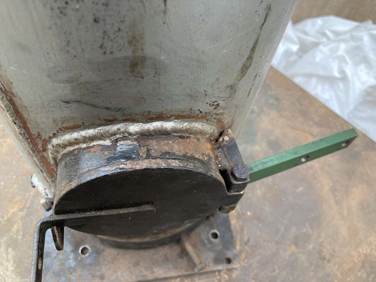

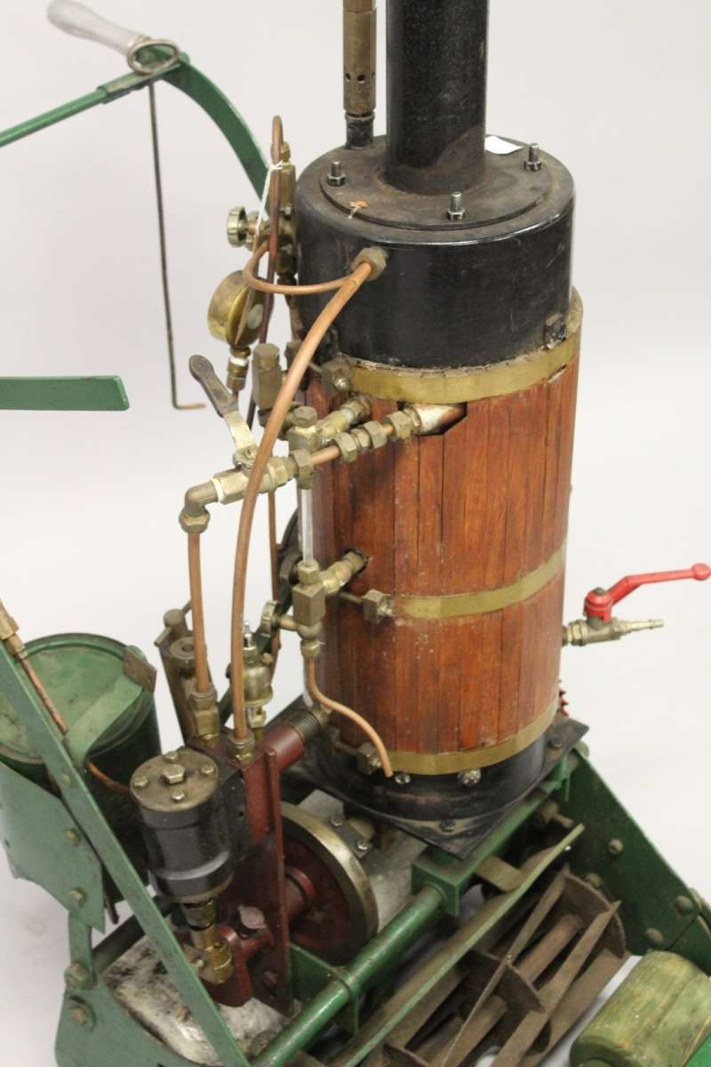

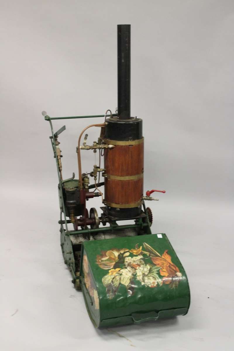

      Hope this forum section is ok to post this. i’ve been asked by the Museum Curator for which I volunteer for restoration work on antique and vintage garden machinery, to assess this for recommissioning.
      It was a project built around 30 years ago, and fortunately the Curator has tracked down the builder, who is hopefully visiting us tomorrow at the Museum.
      Image 1
      The Mower is an Atco 14 inch. Full strip down will commence soon. I’ll add to this when progress has been made.
      #832426
      Harry Wilkes
        @harrywilkes58467
        Interesting mower look forwards to seeing your progress
        H
        #832427
          Splendid stuff !
          #832428
          Nigel Graham 2
            @nigelgraham2
            A wonderful machine!
            #832437
              looks to be a copper boiler going by the upper most sid econnection so should not have rusted in 30yrs. Probably need stripping down to bare boiler and a proper test done if to be fully recommissioned to steam.
              Hopefully that is a safety valve just going out the top of the  picture and not a wistle.
              #832440
              Bazyle
                @bazyle
                I remember seeing one many years ago at the Guildford club annual steam rally. Please ask the builder if that was him.
                In case anyone doesn’t know see the history of Leyland Motors that became British Leyland.

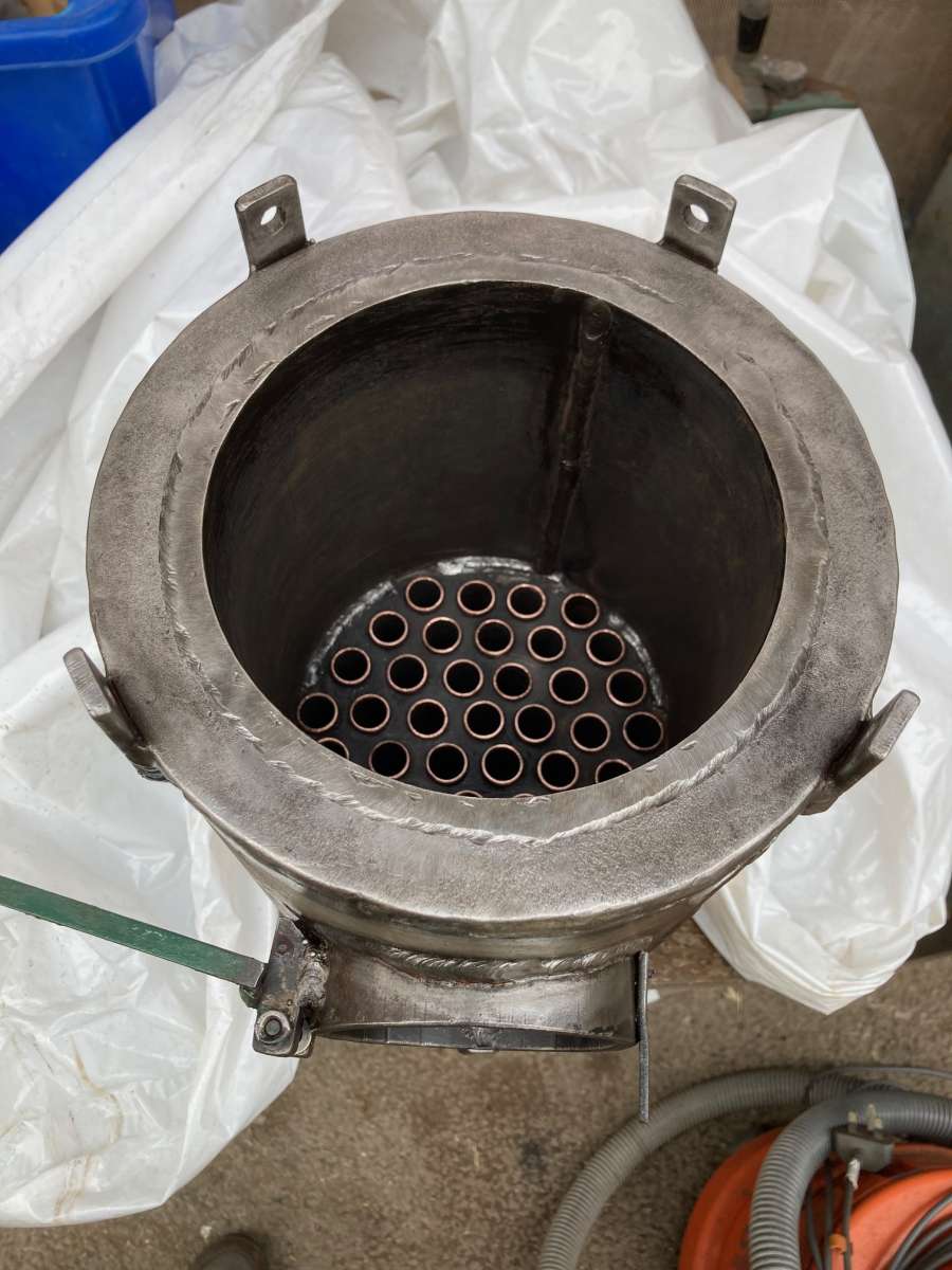

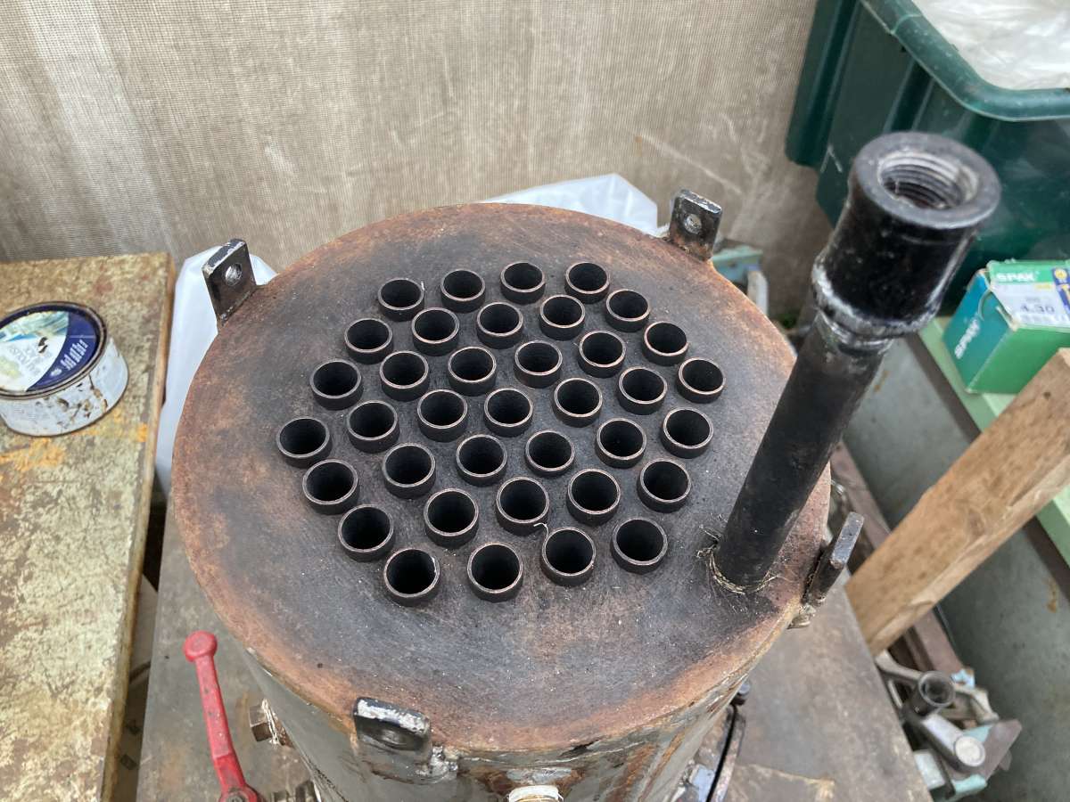

                    Smokebox/chimney removed and provisional clean

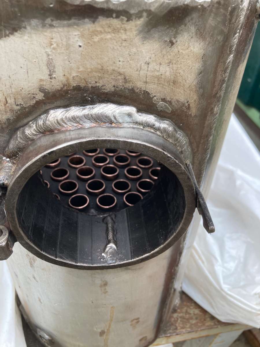

                    Firebox door area showing quality weld bead-
                    IMG_0276

                    Apart from mowing, he also used it to make his tea, run other small engines from it on compressed air. He emphasised his principle of keeping everything basic and functional in design. His name may be familiar to some, having published a book ‘The Steam Launch’ in 1982. His name is Richard Mitchell. i have the green light to return this to a certified running condition. He was most pleased to hear this, as his health is deteriorating. Regards.

                          Well, the whole machine has now been dismantled. We’re having to start from scratch with regard to recertifying the boiler. Unable to trace the paperwork. We’ve managed to engage a qualified NDT Inspector who will carry out a full ultrasonic testing etc. Date to be confirmed. Boiler is fully cleaned and ready for presentation. Volume is almost exactly 6 litres, so 33.12 bar/Litres. Couple of images showing the foundation ring of the firebox end:-
                          The door aperture. Note the forming marks on the inside to create the oval shape:-
                          Certainly robust in construction. this was his 18th boiler he’d designed and built. Fingers crossed it passes all requirements. Regards.

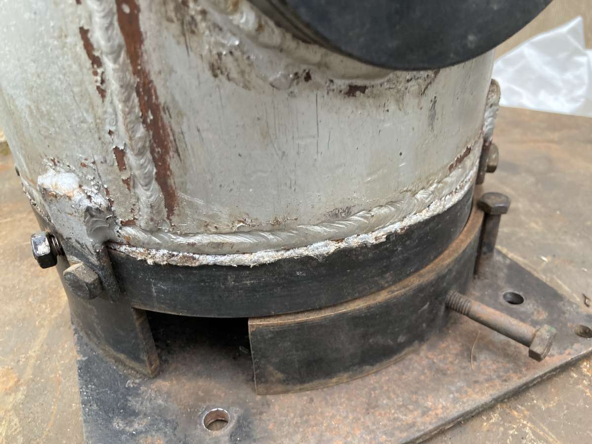

                                So it’s just me who remains unimpressed by the consistency of those boiler welds, then ………………

                                  No Martin, I was not going to comment but since you have I am inclined to agree. They don’t look like the work of a suitably coded welder – though If they will stand a 2x WP test Etc, ultrasonic and material tests Then I would be happy to operate it. That is why I will follow progress with interest and if a ticket can be got then there may be hope for my boiler.  Noel.

                                    Hi, I was thinking the same thing, too much build up in some, not a consistent size along the bead, and some undercut, not a very pro job in my opinion.

                                      Let’s hope the inspection of this boiler reveals a better weld pentration condition than the exterior standard of them.

                                        It’s quite likely a second weld on top of a perfectly adequate first run.  ‘Belt and braces’ in my book.

                                          Hi NDIY, a pro welder wouldn’t do, or need to do a belt and braces job.

                                              Boilers up to about 6″ can be made at home by anybody in copper and even if the silver soldering is not pretty, if it looks sound and passes the various tests That’s fine, it gets a ticket. Nobody asks about the grade of copper or any impurities, or the type of sliver solder. Costly – YES – and if made commercially VERY !
                                              The following are broad statements ! A bad weld will look bad and slag inclusions often obvious, variations in fillet may have little effect on the strength and porosity again is usually obvious. Under NDT tests these faults will show up. Provided the design is sound, the materials adequate, the prep and welding sound then following a hydraulic test to 2xWP all should be well.
                                              Woe betide anyone who tries to make their own steel boiler ! Even if based on a known design it seems that calculations till the cows come home need to be provided, the right plate spec and certified( this I accept ), not just a coded welder but a welder coded for the types of joint and position, the right rods, right joint prep, and so it goes on. I’ve been welding for 60 years often producing structures that peoples lives have depended on BUT I can’t make my own boiler, no matter what test pressure is used, how thick the shell is or how good the welds are. I can see why almost nobody makes their own steel boiler.   Noel.

                                                The welds just look like he was quicker in some areas and slower in others, I was trained at BOC many years ago to weld, Solder and braze. I did ask at my club if I could weld a steel boiler, as you can imagine that got downvoted and the other was could I weld a copper boiler with copper rods as opposed to silver solder, that got downvoted, the interesting thing here was that although they downvoted my questions they never answered why I could not do it, as model engineers we seem to be dismissive first rather than supportive.
