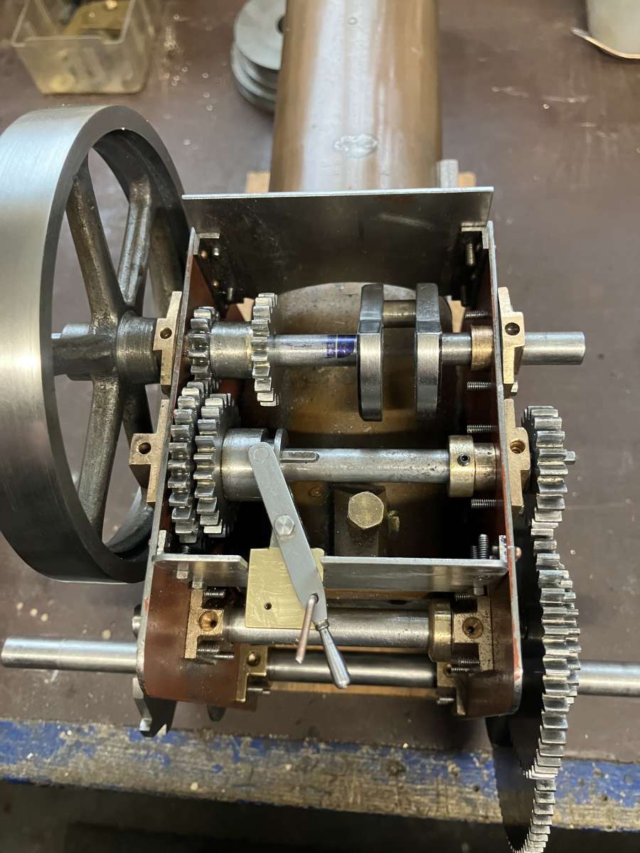

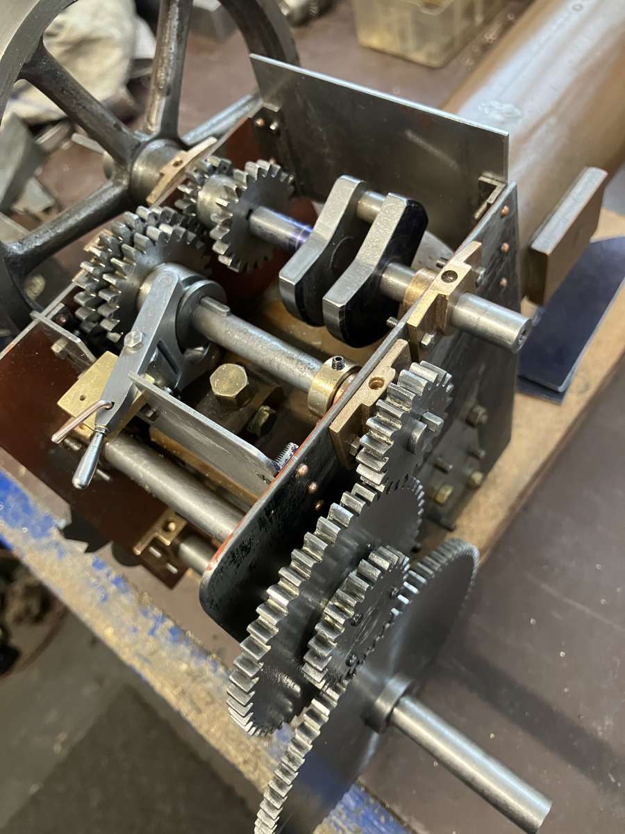

            Finally got all the bearings bolted up with spectacle and blackhead plates in place. Previously I had clamps etc.
            The shafts turn freely after a bit of fettling but some of the gears are now a bit tight and others some seem to have high spots.
            Some of it may be down to the centres and silver soldering etc but I did take what I thought was extreme care in setting out the gear trains as per book.
            I’ve relieved  the gears a bit with a file as they have cutting marks etc from manufacturing.
            Is it considered bad practice to run them with a bit of valve grinding paste and electric drill to bed them in, as this would make any high spots visible rather than struggle with blue etc – being so many teeth and gear sets.
            Also the first/second change gear pick up – do the gears need a little ‘lead’ angle or just that the crank needs to be turning to facilitate engagement ?
            Thanks again for assistance !
            #822454
              Did you use a depthing tool like the book shows as that usually takes care of any possible run out rather than building to numbers? I can’t remember now if it says to put a strip of paper between the gears to give a bit of backlash, if not that may be why you a have the odd tight spot.
              Some people do tend to “motor” an engine to bed things in, if you do so then mesh and unmesh the crank & second shaft pairs so they get run in various positions, the others can be marked so they go back in the same positions.
              With no syncromesh on a traction engine a quick push n pull of the flywheel will feel the gears into mesh while stationary, best not to do it while running.

                    After a bit more fettling it’s working fineIMG_0273IMG_0272 – still a bit tight in places on the big gear wheel, so a little more to look at.
                    The gear lever works ok with the rocking Jason mentioned- the gear lever position is a tad off centre but works fine – pin is only temporary!

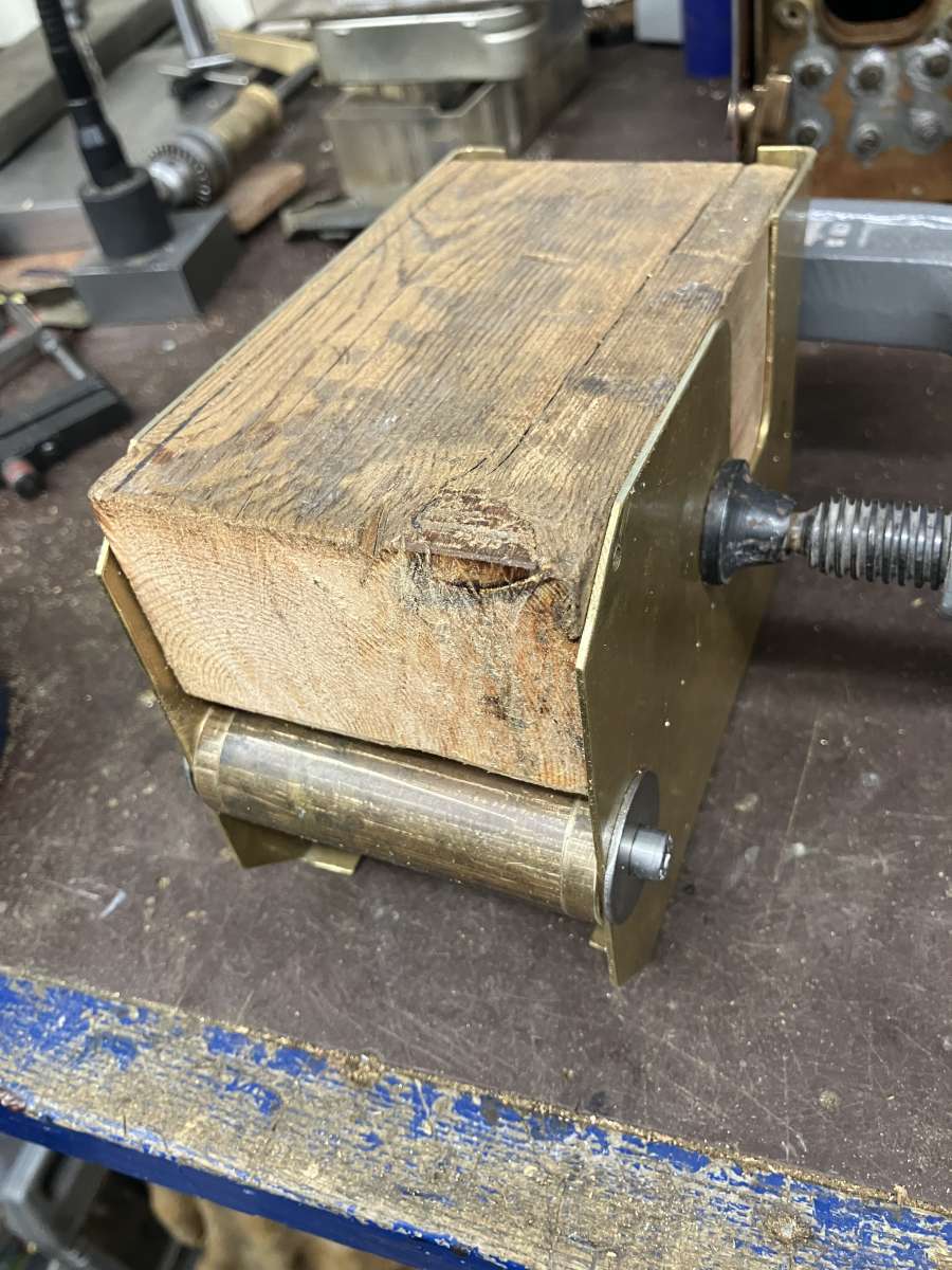

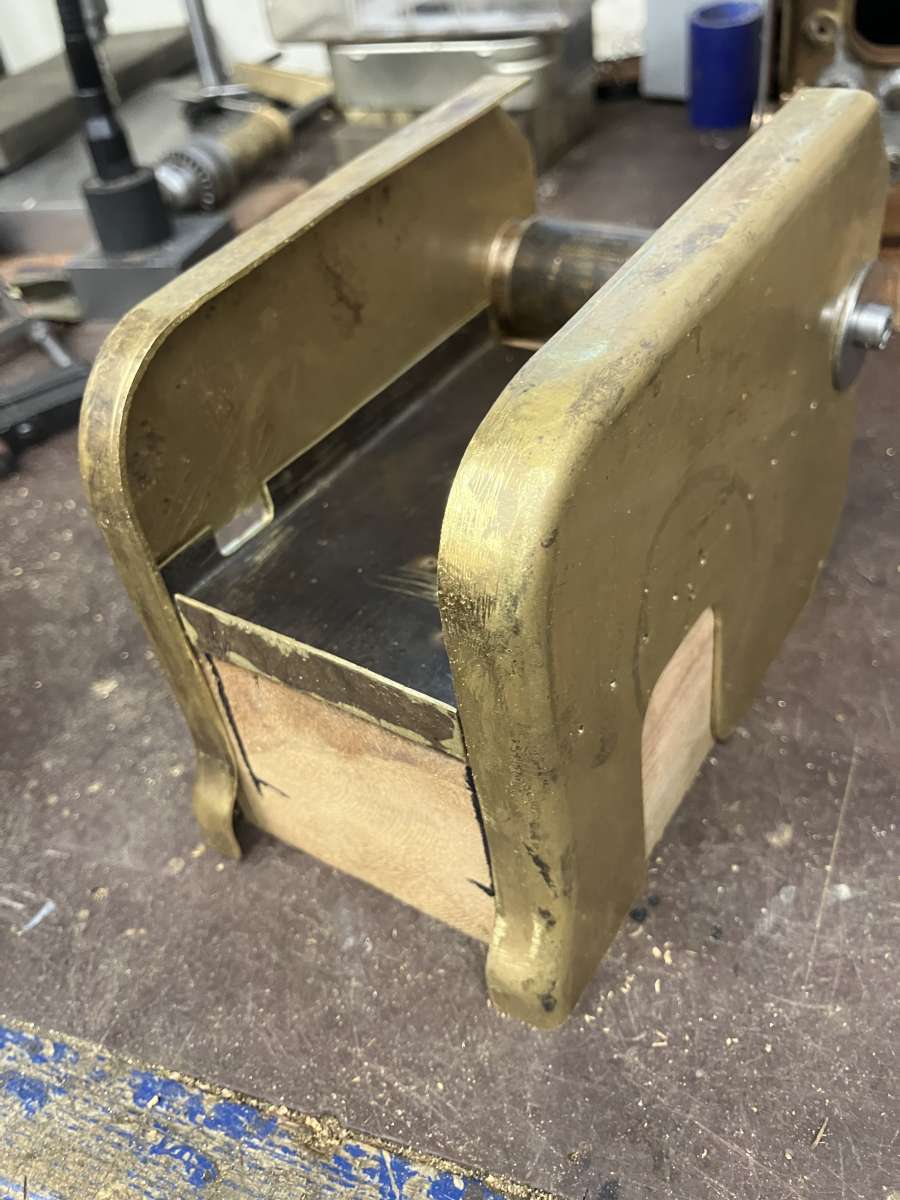

                      Currently working on the tender, trying to sort the sequence of drilling the strengthening plates / tender sides.
                      is it a case of marking out the strengthening plates from the horn plates and drilling each to suit – noting drilling of bearings for each side – locating top edge from 3rd shaft bearing bolt.
                      Then drilling the brass tender sides using the strengthening plates as a jig ?
                      I would like to drill the tender sides before riveting up the tender if possible as after will be much more difficult for the large holes etc – the book seems to suggest after ?
                      #833525
                        It is a long time since I did mine and I don’t tend to spot through much now but I did then. I would probably have:-
                        Put the large rear axle bearing hole into the strengthening plate, then us ethe bearing through that and the hornplate so locate the strengthening plate and spot the screw holes.
                        Rivit up the tender. Pack up the boiler with ornrplate sso it is level and not leaning sideways. Slip the tender into position and again pack it up level. Then start spotting through one screw hole at a time, drilling and adding a bolt before doing the next. Bearing hole last. That way if you get any twist in the tender when riviting you can avearge it out so it sits reasonably true when bolted to the engine.

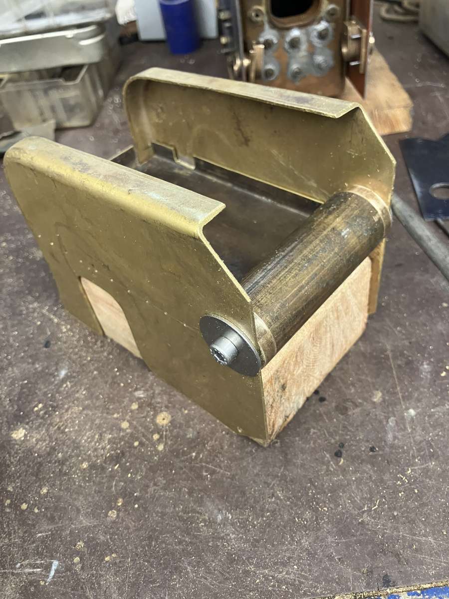

                          I drilled the tender sides first (boring the bearing holes to fit the bearings  snugly), then made a spacer to fit in place of the axle and its bearings, and used that to maintain (hopefully) the sides in alignment whilst doing the riveting.
                          Some of the rivets are a real pain to get at – I did as many as possible with a rivet squeezer I’d made, but some were a bit dubious in terms of the inside heads being formed properly, but it doesn’t matter too much since you’ll be sealing them and the seams with soft solder.
                          Take care with riveting the base plate, especially at the start – it’s very easy to let it gradually drift out of square. I had to scrap my first attempt and start again using a spacer as above.
                          n.b. if you use a spacer, make sure you can get it out from between the tender sides when you’re finished – I can’t remember exactly, but I think I made mine in two parts, with an outer sleeve which was the actual spacing element, and an inner dummy axle with a head on one end and a screw thread on the other to take a clamping nut.

                              I’ve developed the spacer idea and now have a 3 part spacer internally, the outer 2 parts are machine to accurately fit through the side plate bearing holes that I previously reamed to size.
                              I also have planed up a timber spacer to help keep it square and depth the tender floor while drilling the rivets.
                              Riveting looks a nightmare !
                              Thanks for the spacer idea – I had an old brass 1” propshaft IMG_0351laying about so used that.
                              1. IMG_0350IMG_0349

                                  Looks good. the wooden block’s a good idea.

                                    Well the riveting is mainly done !
                                    The spacer worked well and the wooden block enabled the use of a large G cramp to hold the tender square and also hold it in the vice for drilling etc.
