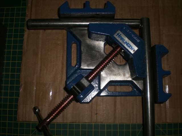

              Hi, I took delivery of four of these quick action welding vices today.
              CIMG3509a
              Very handy for setting up and tacking / welding frame-work, or just a right angle bracket or a T-shape piece, The blocks just stop the moving jaw tilting up, in the above photo, but shouldn’t need them on square or rectangular sections
              They will also hold round bar and tube as well, but small round bar / tube would need a block on the moving jaw side, to stop the jaw from tilting up. The blocks in all cases need to be at least the same height as the top of the clamping screw.
              CIMG3510b
              I’ve used these sort in my day jobs, and if you use all four together, you need a decent flat surface to put them on, otherwise any frame you make will probably end up being twisted.
              Regards Nick.

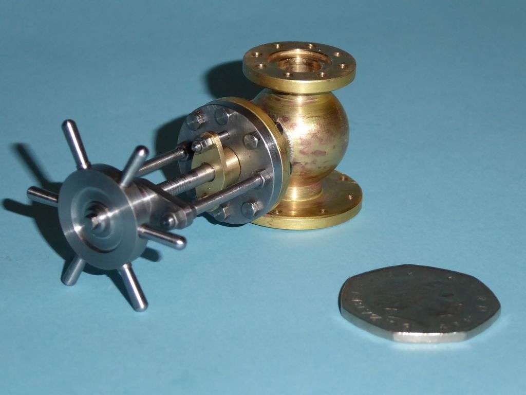

                      I finished the main steam valve for my model mill engine Agnes.
                      P1060765P1060767P1060770

                        Nicely done Phil and nice neat soldering

                          Fine work Phil. How did you form the sphere? Form-tool, copying or ball-turning attachment?

                            I did it with a Hemingway ball turning tool that I made years ago.

                              Thankyou – I am impressed with what it offers you.
                              I do know the Hemingway kits, having made a Boring-bar set and a ‘Kennet’ Tool-&-Cutter Grinder, and started a Keyway Slotting Attachment.

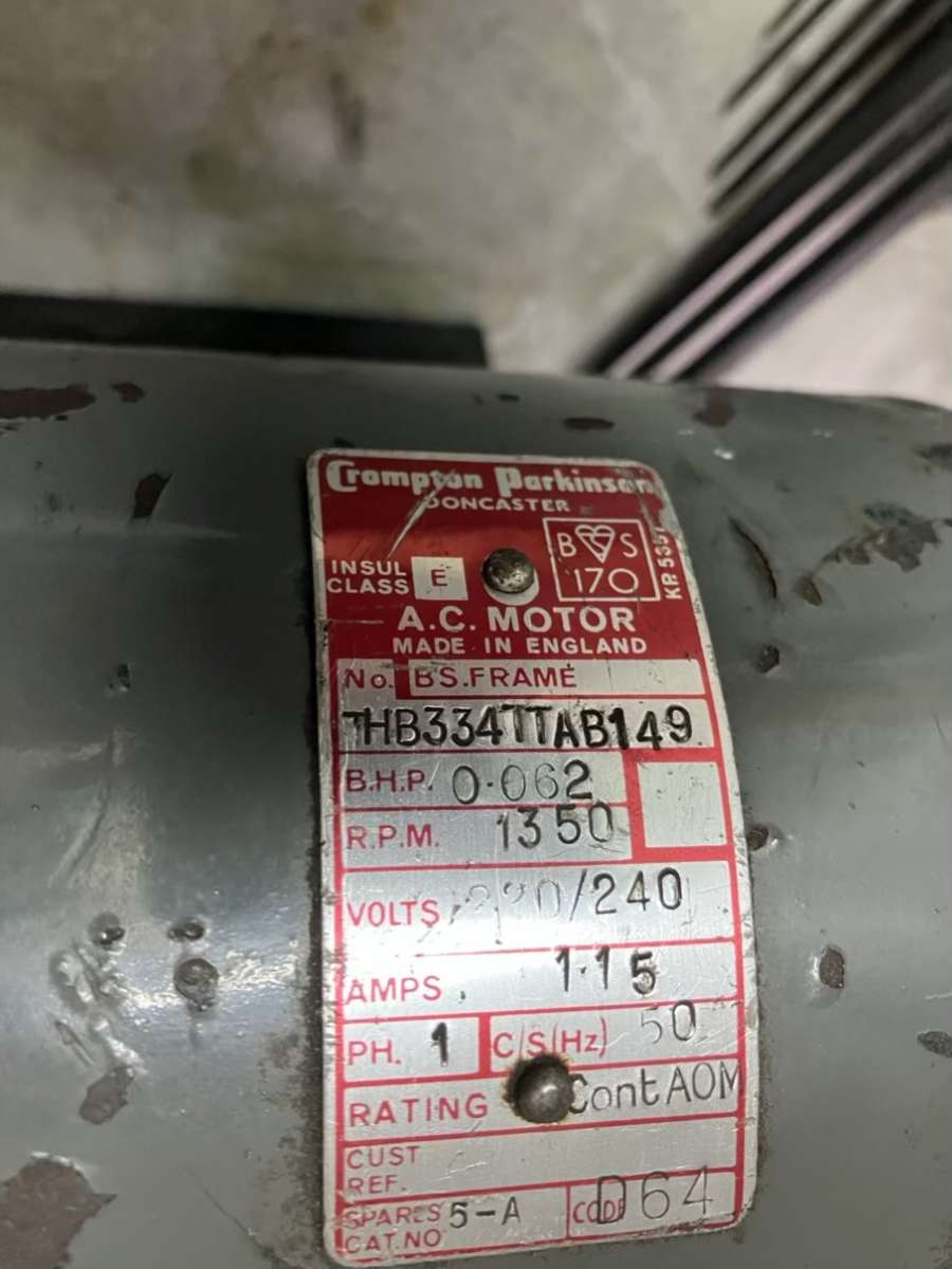

                                I received something I had been after for ages a small powered hacksaw.
                                It’s a Kennedy Hexacut 60 originally supplied without motor so no cast base, the motor is a bit weak but starts once helped , no on/off or cutout switch but apart from that it just needs a clean, not sure if I am going to get the current motor serviced or change it or even convert it to 24volt.
                                I will use it as is for now apart from adding a switch as picture until I decide.IMG_0504-compressedIMG_0507-compressedIMG_4743

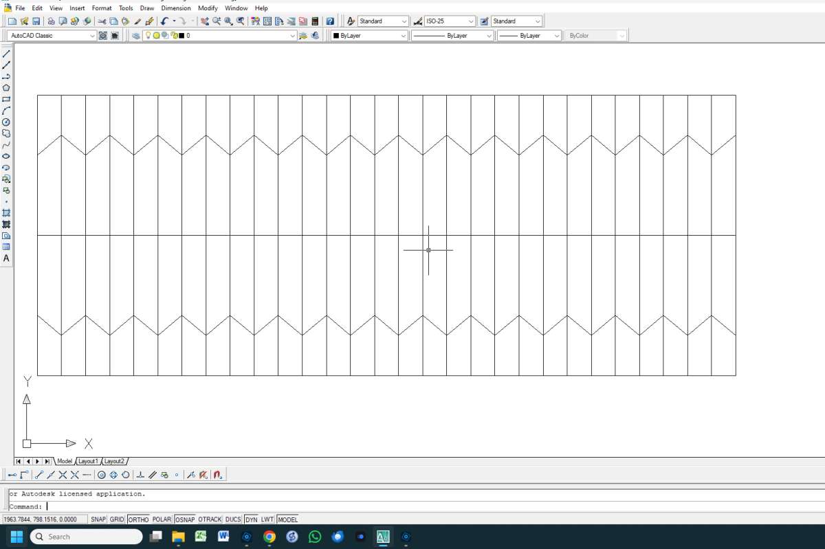

                                          I’ve been having a go at making some small slideway bellows:
                                          Design:
                                          bellows 1

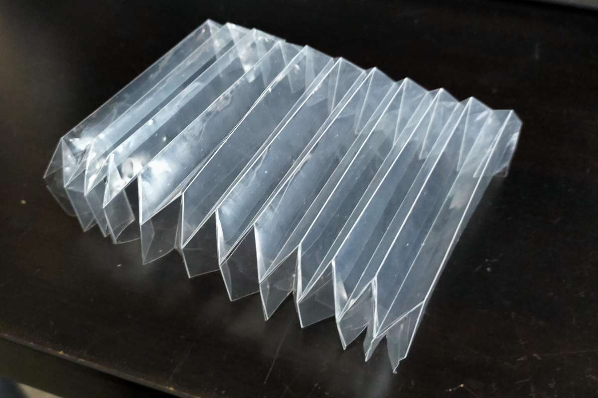

                                          and finally the finished item:
                                          bellows 2
                                          The biggest problem was finding a source for a small amount of suitable plastic.  Stationery supplies seemed to be the best bet.  I found some 12 micron OHP film which is too stiff and A4 document pockets at 3 micron are too flimsy.  However I found some premium A4 pockets which are 9 micron and that seems to be the sweet spot.

                                            Ah – happy memories. I spent a day or two folding various card types to this format before finding I could get 1mm polycarbonate flat sheet to curve through 90 degrees round a smooth guide. Much easier to clean, and this is still working years later.

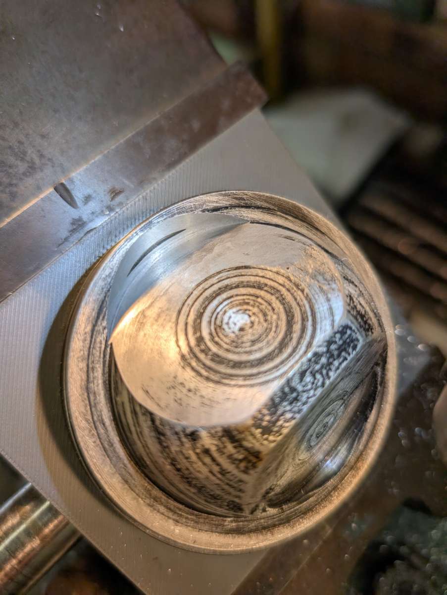

                                                I’m rebuilding a Honda CB450 classic racer engine for a friend of mine and needed to tidy up the inlet valve pockets that had been machined previously but not very well and were completely different. One had a 0.75mm step near the outside of the circumference, the other didn’t!
                                                I 3D printed a fixture to clamp the piston and align the gudgeon pin.
                                                PXL_20260311_132033463
                                                Then put it in my tilt and swivel vice and clocked it to get the pocket level
                                                PXL_20260311_132534410
                                                Then using my Wollhaupter boring head I machined the step away and just kissed the face.  Happy with that.
                                                PXL_20260311_142815311
