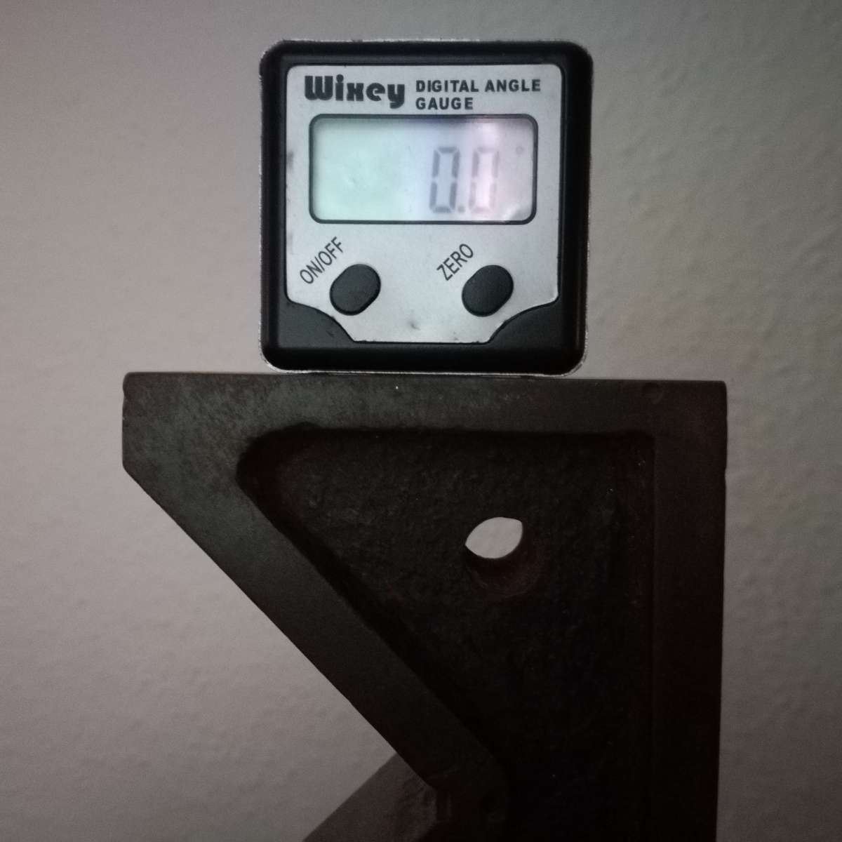

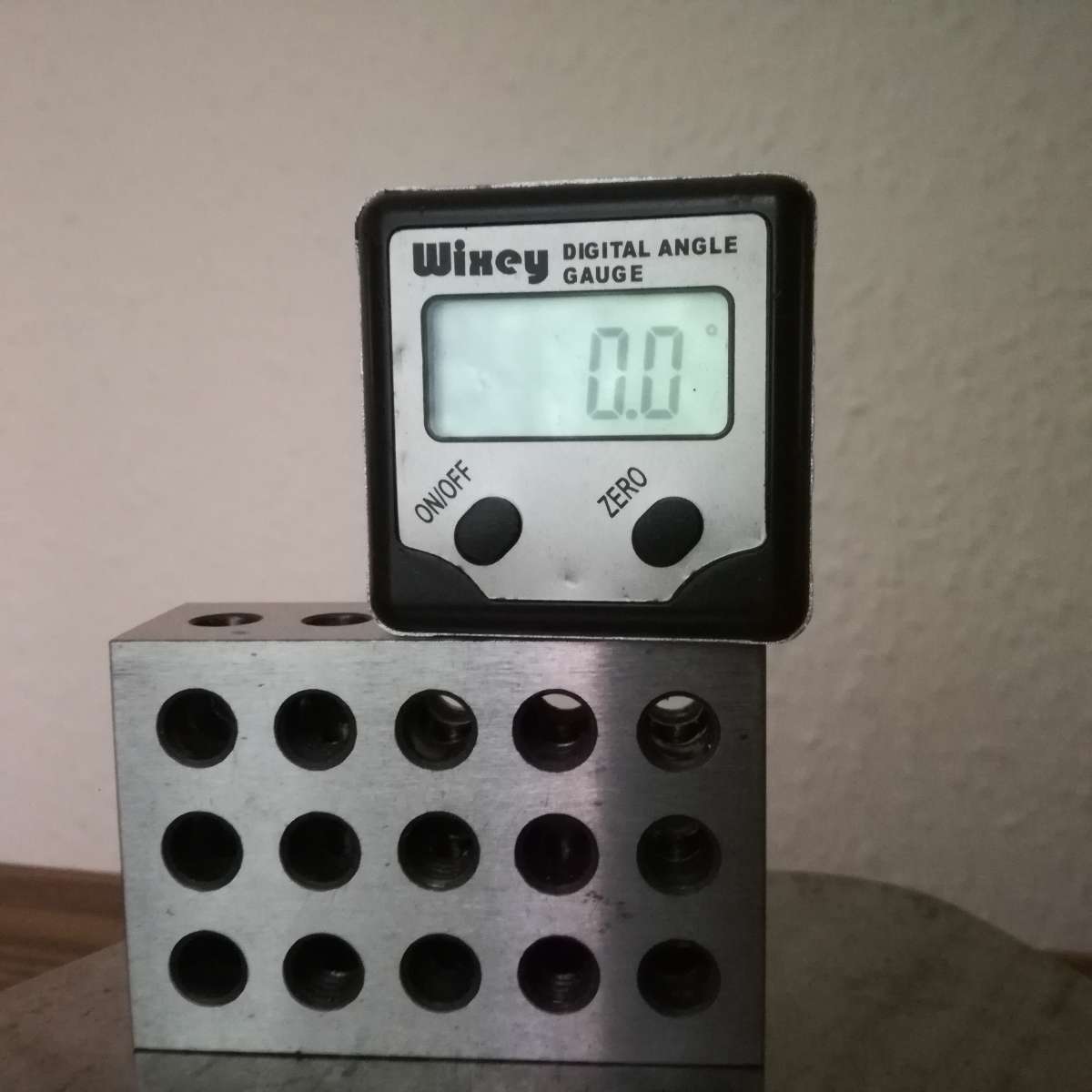

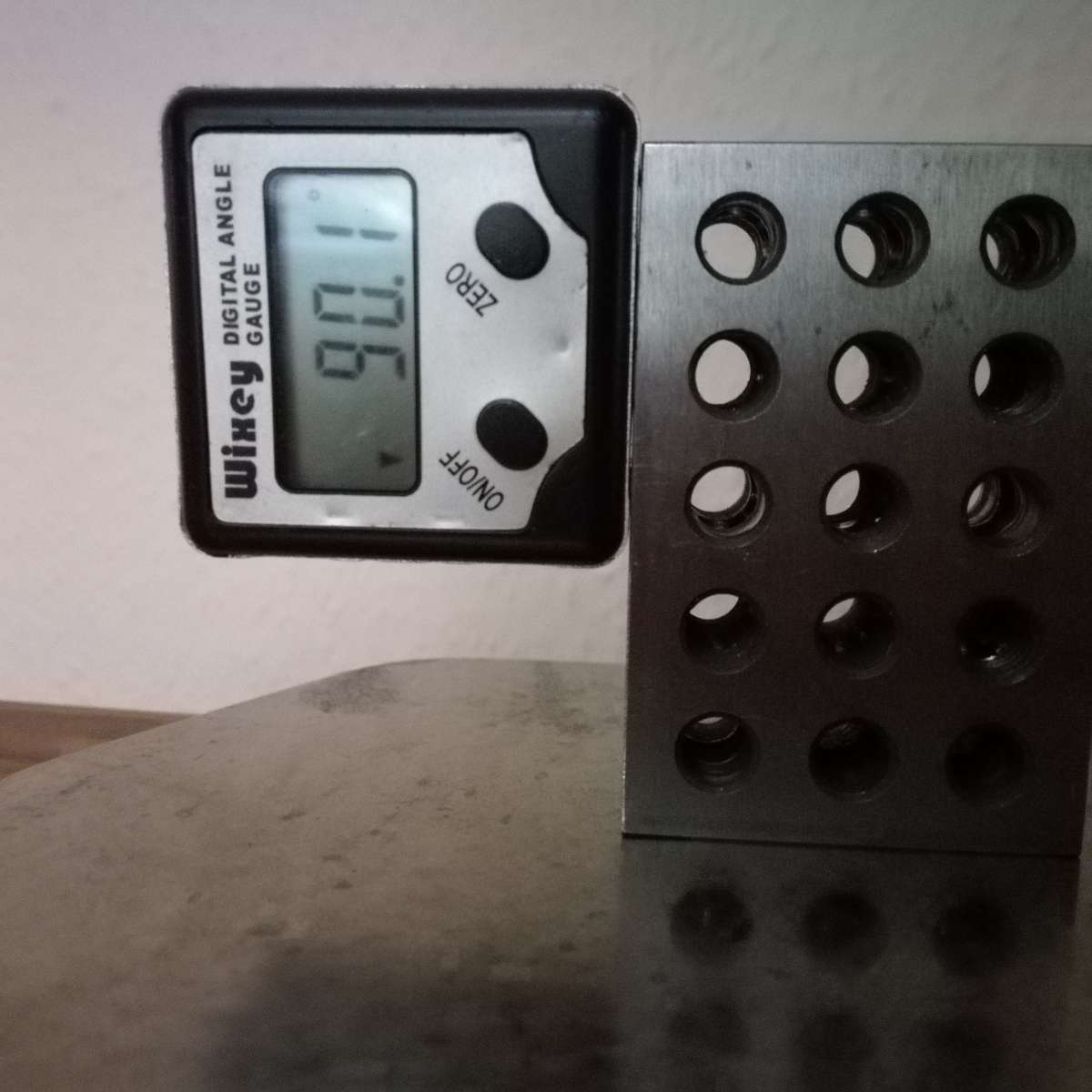

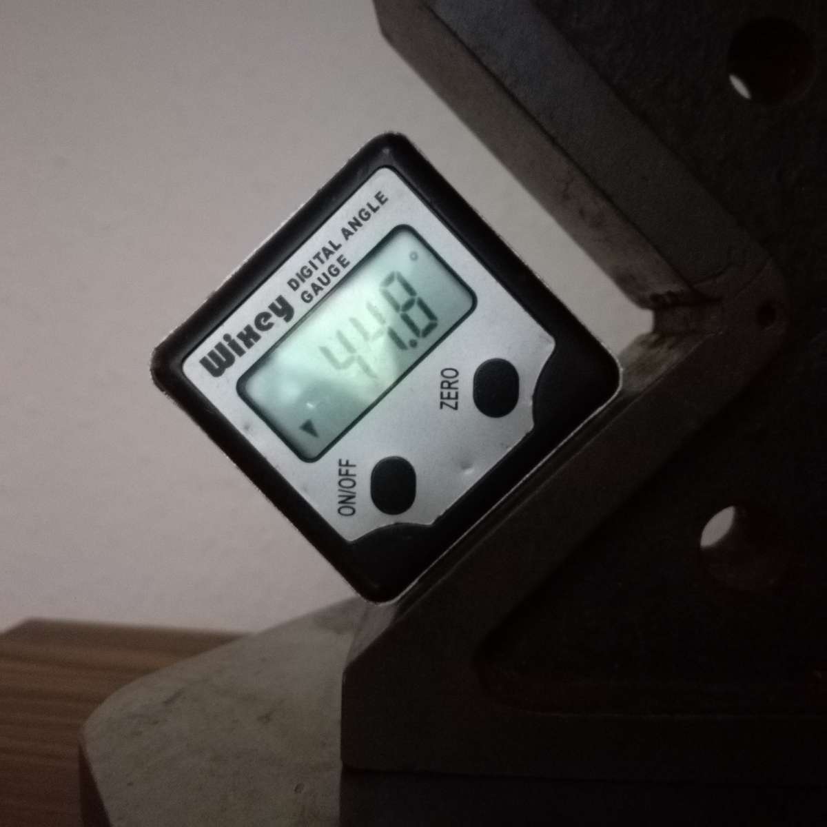

                                      Hi Mick Bailey, Checking true accuracy at home is quite difficult, as everything has to be on a solid stable base in a temperature controlled room, where everything has to climatise, and you should not handle anything with your bare hands. However, for the likes of what we do in our workshop, levels can be reasonable checked, take the digital ones, which can in most cases, be zeroed to whatever you starting surface is, and an easy way of seeing how true a digital one is, is shown in my photos below, the results show a small difference, but it doesn’t mean the digital device is in error, or even if it is level or not, as the first 2 photos show it reset to 0.0, but when turning the first photo, the error shown could be the block it is sitting on, or any small difference between the block and the surface plate or even the device or a slight temperature change. The same goes for the second two photos, but that vee block is not in pristine condition , but for what the most of us do, and the machines we have, these errors are plenty good enough.
                                      IMG_20260606_101456
                                      IMG_20260606_101521
                                      IMG_20260606_101658
                                      IMG_20260606_101737
                                      The Wixey was not what I would call expensive, nor was it what I’d call cheap, and I’ve had it for 20 odd years.
                                      Regards Nick.

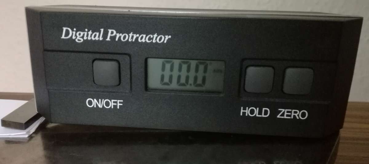

                                                    Hi, This digital protractor is reasonable good, it cost quite a lot more than my Wixey, and has a built in calibrator, and calibration can be done on any flat surface that doesn’t have to be level. As you can see in the photo below, the surface plate it is on, is near enough 4.2mm low on the left hand side, the protractor is 150mm long. When it is level, the ABS is showing, at the right of the digits, but it can be put into relative measurement on a surface that is not level, by pressing the zero button, and an angle can then be measured from there, pressing the zero again will bring it back to ABS.
                                                    IMG_20260606_123418
                                                    Regards Nick.
