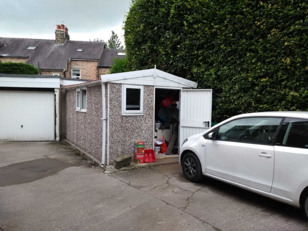

        This is my shed
        It's quite full. Even after several attempts at re-organisation.

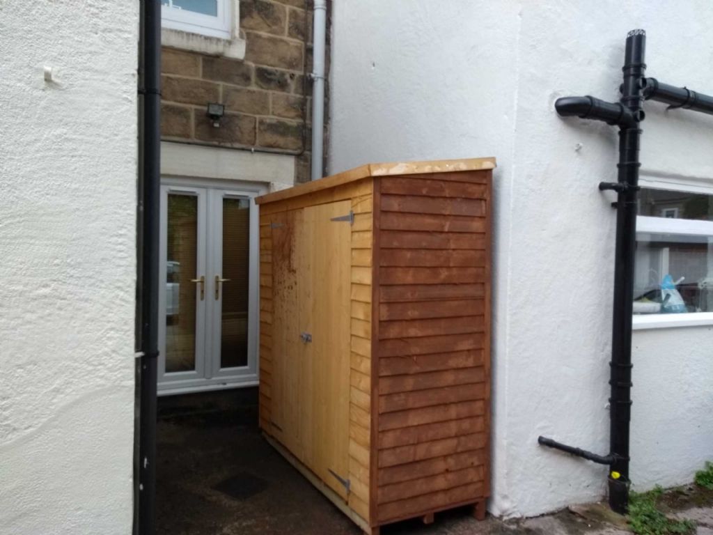

        And this is the shed's shed.
        This was going swimmingly until I came to spray the back, before pushing it back into place. I discovered two things about cheap fence sprayers. Firstly, they are not very accurate and the spray gets everywhere.

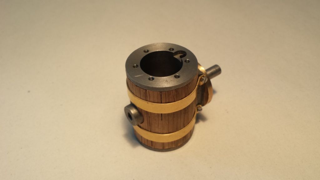

                                      Today I completed my first attempt at cladding (or is it cleading) a cylinder casting.
                                      I set the casting up on an arbor and milled a small 1mm step on the inside of both flanges. The hardwood rings which are jb welded to the waist of the cylinder were leveled to the same height in the rotary table arrangement in photo 1.
                                      The oak strips were cut with my new slitting saw and arbor from ARC
                                      All strips super glued in place with the 6mm brass straps secured with 8 ba screws.
                                      Just need to apply a sealing finish to the oak. I thought perhaps briwax applied with wire wool.
                                      Geoff

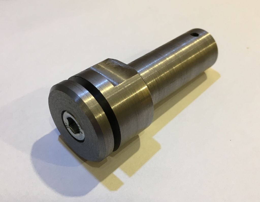

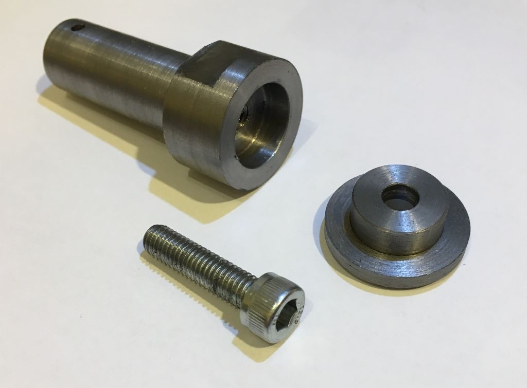

                                        Making arbors for slitting saws seems to be topic of the month, looking at other forum posts. I need one for making some clevices for my tender, so this is what I have made. The hole through the end of the shank serves no purpose: it was pre-existing on the bar in my scrap box. I also made a 1 mm thick washer to avoid the corner radius on the cap, allowing the cutter to seat correctly.
                                        It runs true in my ER chuck, but this is not important. The manufacturer of my slitting saw did not bother to put the hole in the centre and it runs like a single-point cutter…

                                          Nice bit of woodwork George.
                                          Cladding cylinders in wood where appropriate adds a lot to a model for me.

                                            " Just need to apply a sealing finish to the oak. I thought perhaps briwax applied with wire wool. "
                                            I'm no expert, but I know oak stains iron, so is there a danger of bits of your wire wool discolouring that very nicely done cladding? Hopefully someone with more experience of it can confirm or refute my fears.
                                            #418503
                                              George I would use a grey Scotchbrite pad to put on the wax as you can leave bits of wire wool in the grain which will rust or stain the oak black especially if you are going to use steam as Rb pointe dout.

                                                Thanks for the tips gents, wire wool probably a bad idea, glad I asked..
                                                Scotchbrite sounds good, I'll go down that route.
