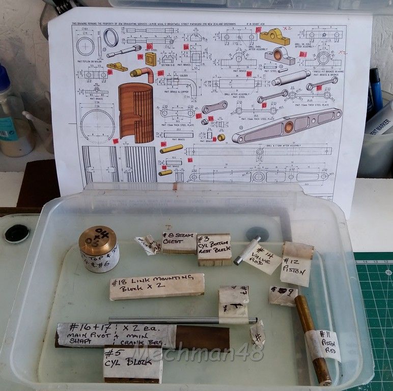

          Started collecting material for my next project … Single cylinder balance beam engine from a design by Gerry Dykstra,Holland.

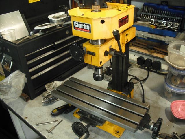

                    The long table for my mini mill/drill arrived today. Now fitted and adjusted. I used new hex headed gib screws instead of the existing slotted ones. I find them easier to adjust.new table.jpg
                    I'm not sure what to do with the old table. I did think about using it as a new cross slide on the lathe, but that could be problematical. I've temporarily fitted it to my home brew tool grinder to see if it's usable there.grind1.jpg

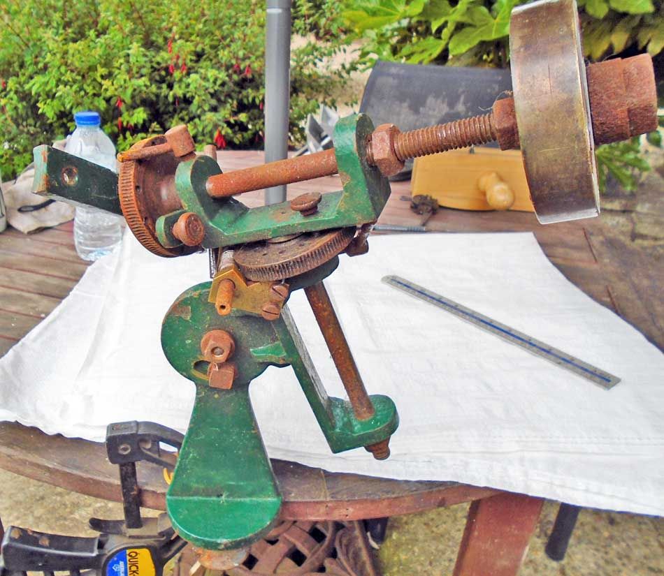

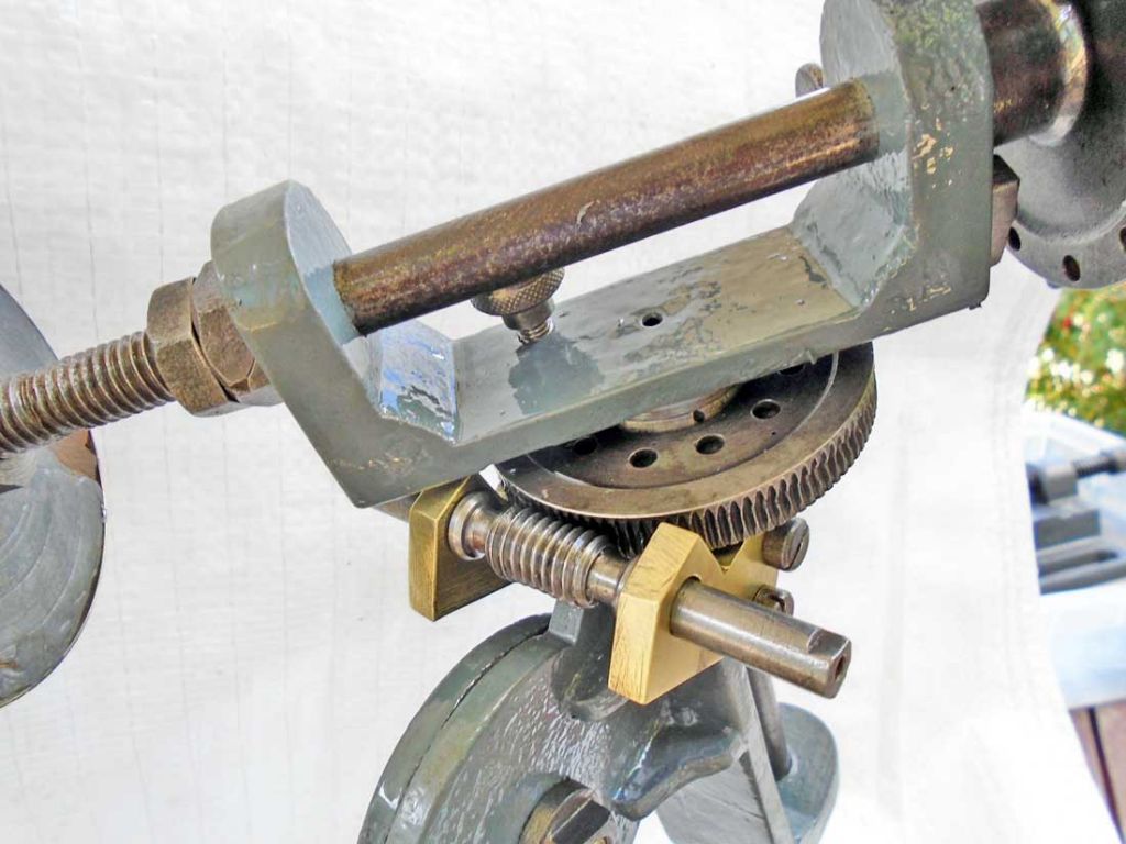

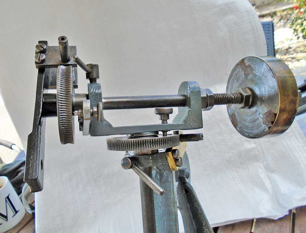

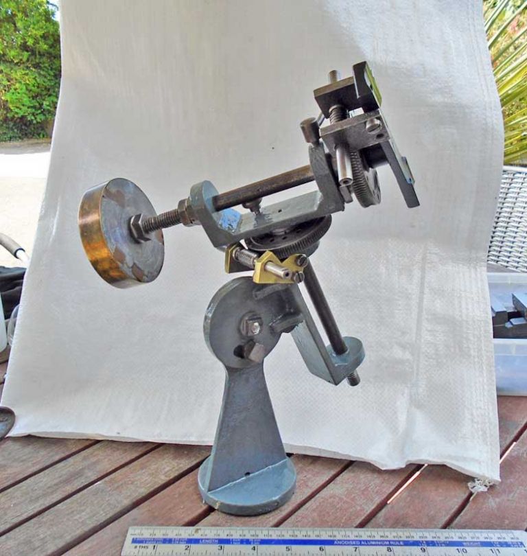

                        Hi All,
                        Today (& yesterday!) I got stuck into the old rusty telescope mount that i got last week:
                        Managed to get it apart with no damage and now it looks like this:
                        Ther is one sheared off screw and it looks to me like it is missing a couple of hand wheels for adjusting the worm gears. Anyone got an idea of how big a diameter these should be as there is quite a bit of friction in the gears?
                        Quite a fun little project to do while sitting under a brolly in the sun!
                        As you may tell from the colour it is for a MYFORD telescope! laugh
                        Cheers, Martin
                        #417173
                        Nigel Graham 2
                          @nigelgraham2
                          Looks good!
                          I am not an expert on telescope mounting but worm-drives like that, too low-angled to reverse under load, should operate silkily-smoothly without much effort and very little actual friction in them, the bearings and when released, in those spindle locks.
                          Assuming the bearings and locks are all up to scratch, and everything clean and lightly oiled; heavy friction suggests to me the worms are very slightly too deeply meshed. You might find a thou' or two relaxation in the way the bearings are fitted to the frame though. They appear not to have very positive locations, e.g. sliding in rebates on the frame; but rely simply on 4 chees-head screws. The two lugs holding the elevation worm particularly, look a bit out-of-place with the rest of the mount, as if replacements made by a previous owner, and not too accurately.
                          Short of someone giving more definite information, perhaps by comparing with another mount of similar size, I'd suggest completing the overhaul of what's there, fitting the telescope or an equivalent dummy load, then experimenting with a temporary handle to ascertain a suitable radius before make ones that do the rest justice.
                          I'd think hand-wheels or cranked handles, possibly no more than about 2" radius.
                          The limit looks anyway as if set by clearances between the handles and other parts of the frame.
                          #417177
                          Martin King 2
                            @martinking2
                            Nigel, The worm gears turn smoothly when operated with a small mole grip on the spindle to use as a handle and feel good with no binding or rough spots so the engineering is not too far out. There are no bearing in the supports which I found a bit odd.
                            I should add that I have no interest in using this item, I have just cleaned it up to move it on.I may make a coiuple of hand wheels though?
                            Cheers, Martin

                                    Martin. I like your telescope mount. I could do with borrowing that for a couple of hours to measure it up 😉😉
                                    Brian

                                      Hi Martin – have the gears turned out to be brass? If so, that's a big plus.
                                      The knobs would normally be turned by flexible drives (spring in a plastic tube) about 8-10" long with knobs about 1 1/2" diameter on the end. This is to stop your hands shaking the mount.
                                      Brian, if you make one, consider using bearings, ideally taper roller for the main axes, but also ordinary races for the worms.

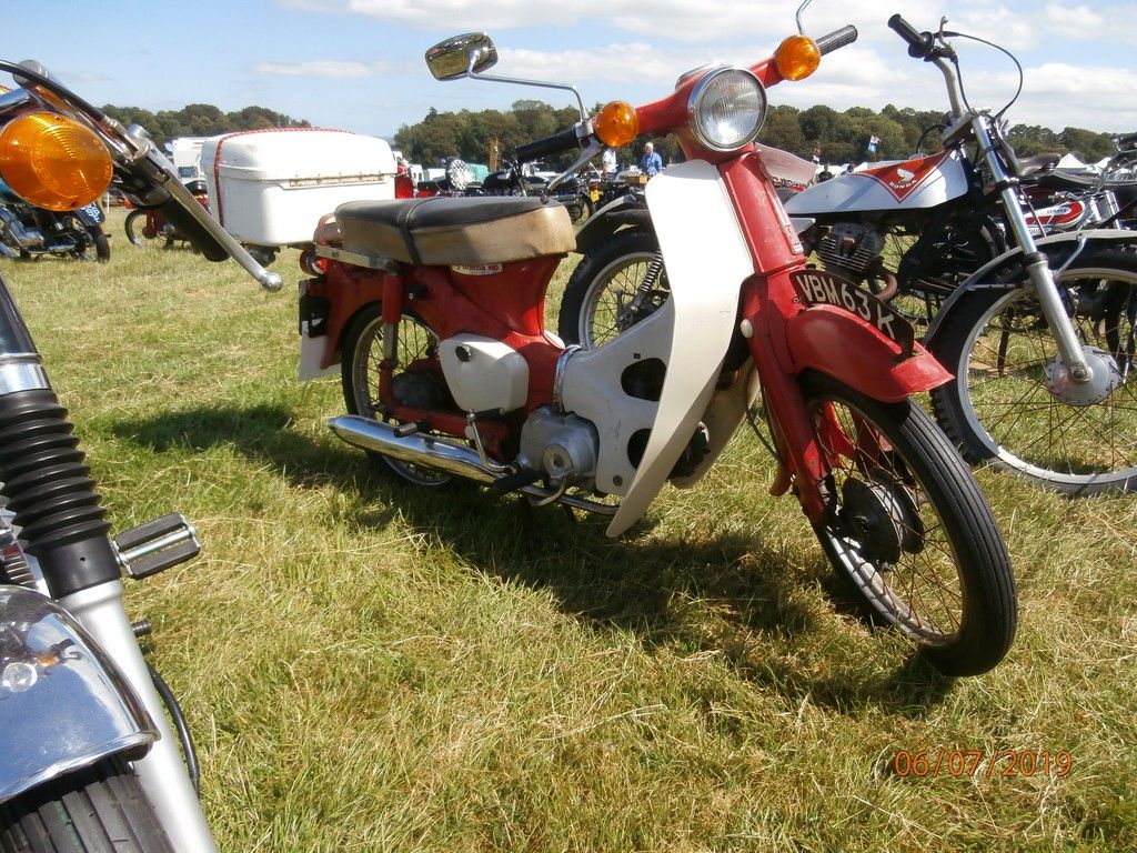

                                                  My first motor bike…

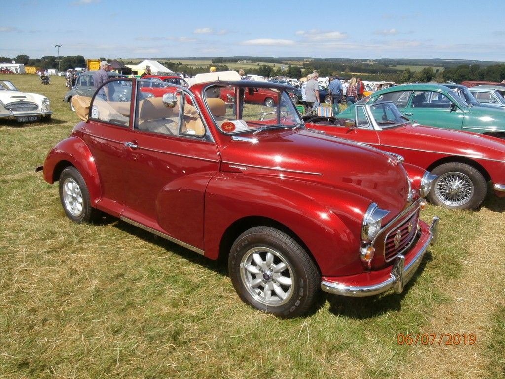

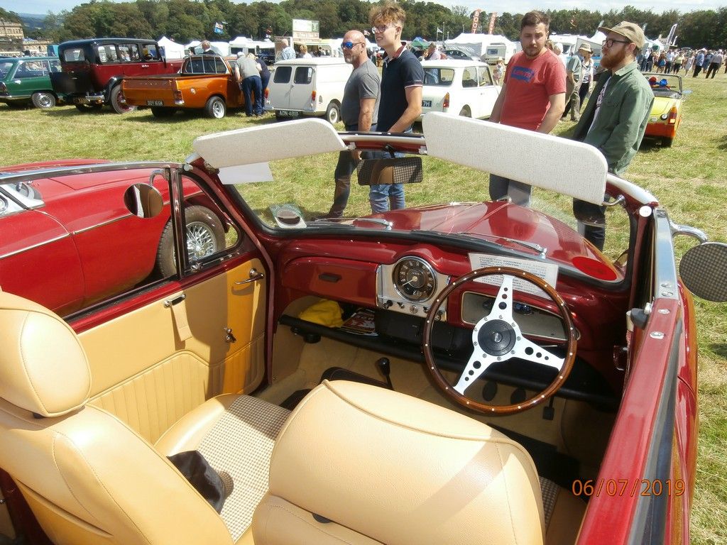

                                                  Beautiful converted Moggie…

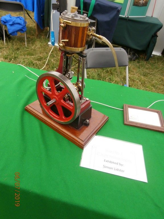

                                                  Stuart #1 iirc…

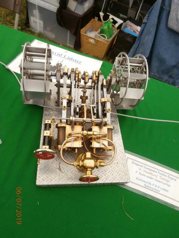

                                                  Twin paddle steamer engine…

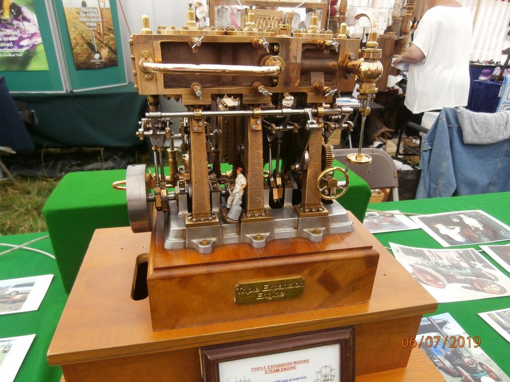

                                                  Triple expansion engine…
