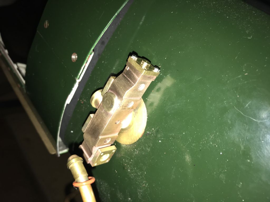

          Started to fit the new steam header and pipe it up to all the points
          It looks a lot better than the 16mm square bar it replaces

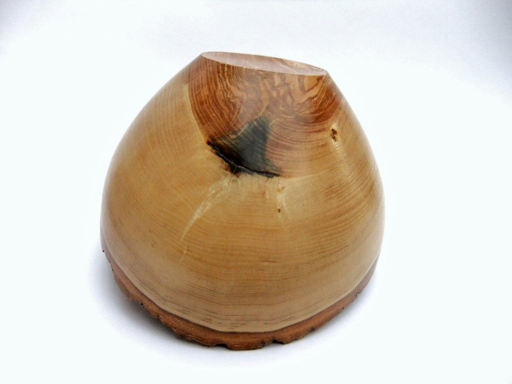

                I know a couple of days late but I turned this yesterday to only find a couple of nails in it and as you can see the black area is what they have caused. The wood for this is Ash had it been Oak the effect would have been a lot worse as it contains a lot of tannin which reacts with metal.
                To give another example if I want to turn Oak black I take wire wool and let it steep in vinegar for a while and when rubbed on the Oak will turn it instantly black, so avoid rubbing it with wire wool
                As for using Oak on a nicely made scale model the grain is of the open type and can look wrong on a small scaled model, personally I would have used a closer grained wood for appearances and then stain it Oak coloured.

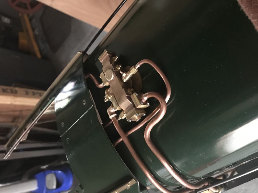

                                              I have now finished fitting and piping the steam header that i made. Its a lot better looking than the old 16mm square one that the engine came with.

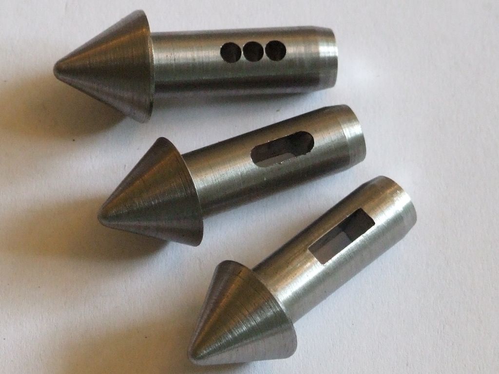

                                                I have now finished forming the rectangular slots in the anchor bolts and frost spikes for my traction engines. To summarise the sequence:
                                                Three holes drilled and then the slot milled to size with a slotdrill, both on the CNC mill. Finally the square ends were done with a keyway broach, thinned on the surface grinder to be a snug fit, using an arbor press, with a drill and shims as required:
                                                Andrew

                                                  Andrew, what is the material or method you used to hold the spikes whilst you were slotting them, and were they hand-held?
                                                  Nothing appears to be clamped down.

                                                    The spikes are resting on two lengths of nominally 1/8" keysteel, held in place with double-sided tape. Keysteel is normally a few thou over nominal size so gives just enough clearance as the stock material was 5/8" and the machined shank is 3/8".
                                                    The spikes were hand held during broaching. Once pressure was applied the down force kept everything in place. The biggest problem I had was maintaining the broach vertical. The relatively small diameter of the shank meant that at best only two teeth were engaged at a time. Sometimes the broach went straight through with ease, other times it jammed. A jam simply required the broach to be twisted slightly back towards vertical and then it went as normal.
                                                    Not ideal, but I suspect the original spikes and rectangular holes would have been made by the blacksmith, so at least I'm better than that.
                                                    Andrew

                                                      Andrew –
                                                      Quite possibly forged originals, but very likely drop-forged, not hand-made. The technique was well-established by the end of the 19C.
                                                      Alternatively your method was rather closer to the original than you suggest, because that's a large amount of steel to remove compared to the total, by forging. Also of course, the factory needed to make a lot of these components! So forged to form the head, then the shank drilled, and not broached but machine-slotted. (Dedicated slotting-machines were common then, especially good for cutting internal splines and keyways.)
