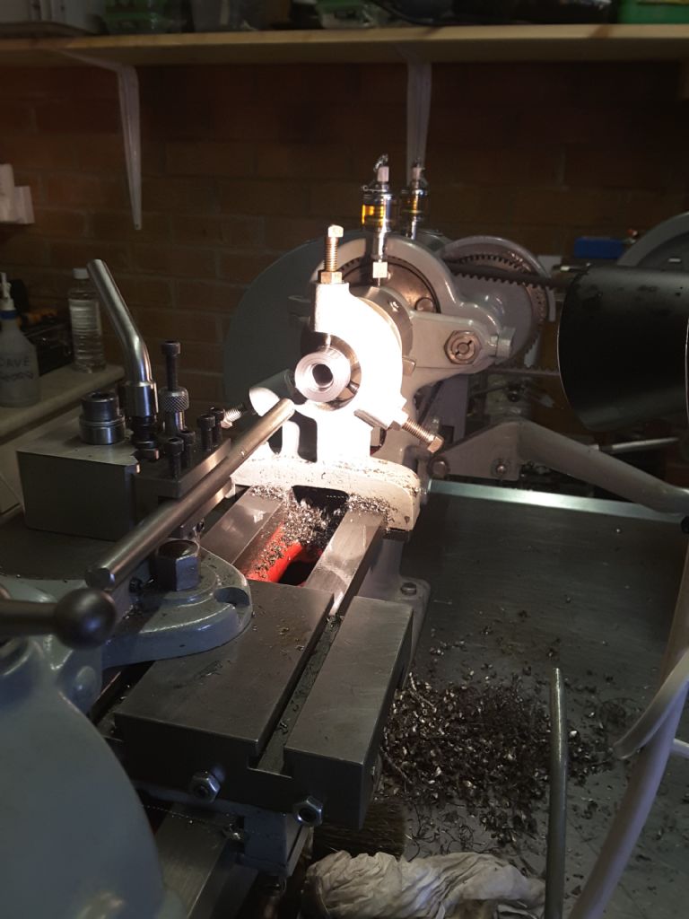

        Posted by Speedy Builder5 on 31/03/2017 06:45:27:
        I am curious. Does everyone mill steel dry these days? I always use coolant, so my mill always looks oily in photos!
        BobH
        Depends on the milling machine. I rarely use coolant on the vertical mill as it gets flung everywhere. While I often use carbide cutters this item was hogged out using a HSS endmill:
        No coolant used and a tooth load of 6 thou. The chips came off blue but the cutter seemed happy.
        On the CNC mill I always use flood coolant on steel, if only to help wash away the swarf.
        On the horizontal mill I also always use coolant on steel as it is easy to set up and I use secondhand large HSS cutters which are a faff to resharpen.
        So not much logic really, other than I tend not to use coolant where it is going to get flung around the workshop. Personally I can't see the point of dabbing coolant, it's not doing anything in terms of cooling. I get reasonable finishes straight off the mill without coolant – see above. The only caveat is that the odd squirt of WD40 can help on aluminium to stop it sticking to the tool and jamming everything up, although it makes no difference to the finish.
        Andrew

            Being untrained and inexperienced, and believing some of the stuff I read, I use a dropper to apply neat cutting oil with both my HSS and insert tools. I use this on all metals as it seems to produce a better result. Am I right or wrong?
            I don't use inserts but I use neat cutting oil with HSS when machining steel or bronze. I don't think I am doing wrong, my cutting tools last, don't need frequent regrinding and the finish is usually good. I am not worried about production times and a little oil on the floor can be soaked up by an absorbent.
            If it works, is safe and not too expensive why change?
            JA
            Edit:    Brass and cast iron are machined dry unless the brass squeaks too much. Then I apply a little white spirit. It probably does not do anything other than keep me happy.

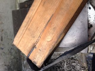

                      'Made' Low Tech. 'tool' today. Having failed the 'keep your knuckles away from the chuck test' at least three times I decided to 'do something. So I got a chunk of wood, cut a slot in it and apply my emery strips, when polishing, from a safe distance.
                      Can't believe it took me so long to pick up on this one! Dur!

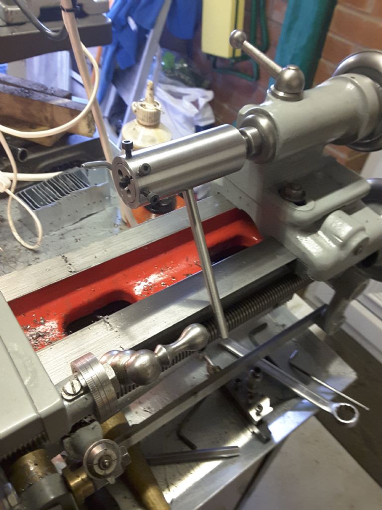

                            In order to make my miniature lathe (stuart Kit) I needed a tailstock die holder and to keep the other half on my side as I am planning to buy a small mill MC I thought I would make one. Here is the start pictures. Ps I use cutting oil on most steel and aluminium jobs.
                            David
                            Edited By David George 1 on 01/04/2017 07:01:06
                            #291646
                            David George 1
                              @davidgeorge1
                              Finished the Tailstock die holder. Now to continue with model lathe.

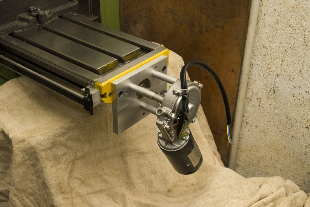

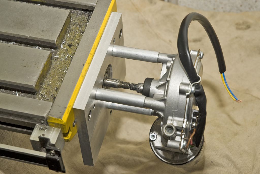

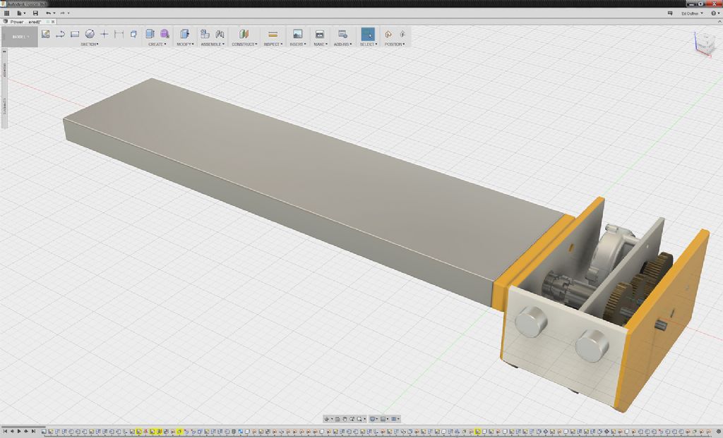

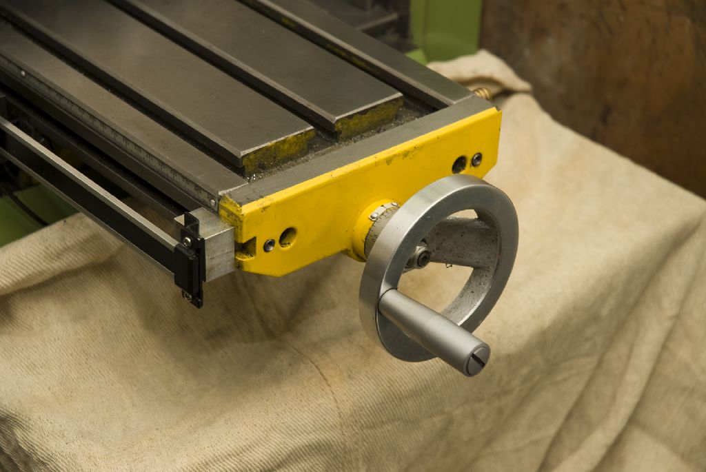

                                    Have been spending a bit of time in Fusion 360 over the past couple of weeks trying some different ideas for a power feed.
                                    Today I started making a temporary mock-up to mount the motor. This will be just to see what the 24V-DC motor is capable of through a PWM controller. I'm hoping to include a high/low gear change inside the final design as well.
                                    Here are some photos of the mock up (I still need to finish making the drive-dog to go between the motor shaft and lead screw end) and also a screen shot of the progress on the Fusion idea. There will be a third lever on the front panel which I mentioned in an earlier post, for the direction and motor speed control. The original winding handle will be re-attached to an extended shaft.
                                    Ed.
                                    Edit: Sorry for the poor quality of pictures but the originals are fine before uploading to ME. I'm not sure why they appear blurry on the web site.

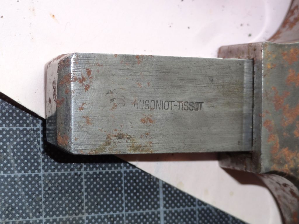

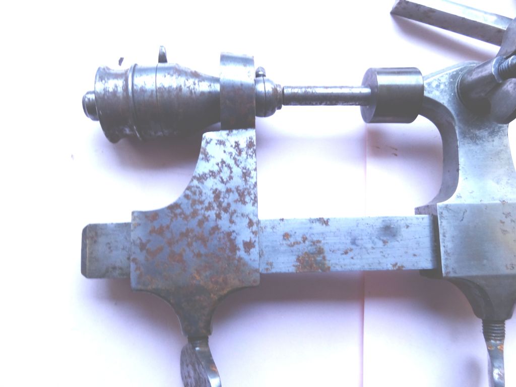

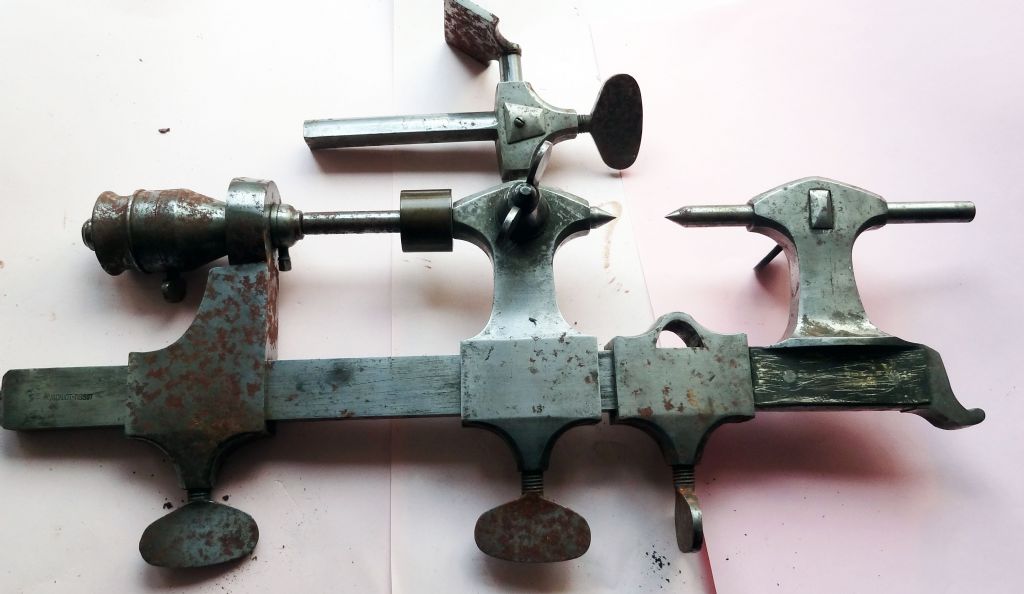

                                      Picked this up at a local Brocante this morning (20 euro) I woulsd like to find out a little more about its use and the strange "Blob" at the LH end.
                                      #291811
                                        Watchmaker's turns, a cord loops round the pulley, and is worked back and forth with a foot pedal and you cut using a graver.

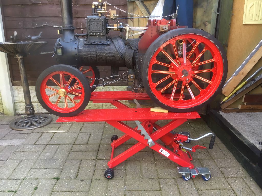

                                              Adapted motorcycle lift to lift my 3" Burrell help save the old knee's and back wink
                                              #292062
                                              Bob Rodgerson
                                                @bobrodgerson97362
                                                I took a bike life to my last club auction night (exactly like yours Harry) but i couldn'even give it away. It is slowly rusting away but I bet if some of the traction engine builders had seen your use of the bike life they would have snapped it up.
                                                #292064
                                                Harry Wilkes
                                                  @harrywilkes58467
                                                  Posted by Bob Rodgerson on 04/04/2017 14:43:12:
                                                  Sounds like your members are a bit like some it my club 'tight' If you still have it stick it on ebay !
                                                  H

                                                      Does it fold up to stand vertically on the 4 castors? One of the problems with my lifting table is the space it takes up and temptation to dump things on it making it unavailable when needed. Plus it's rather heavy.
