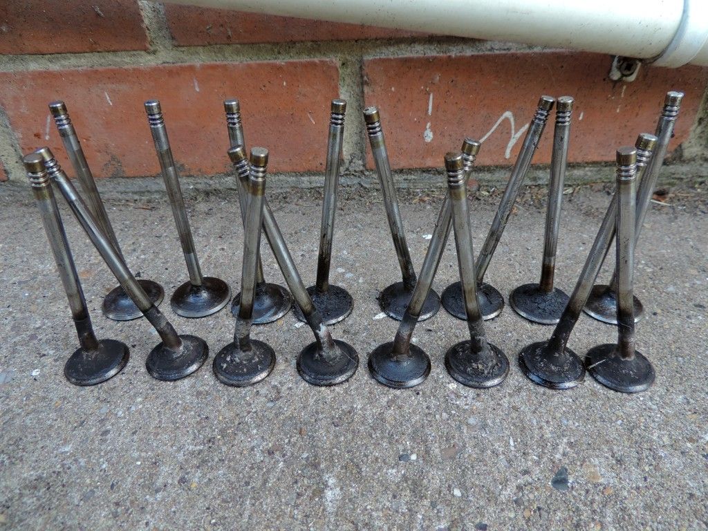

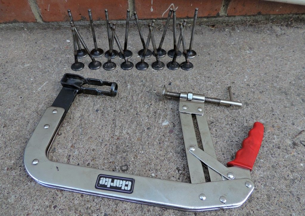

                              I changed 14 out of 16 valves on an Astra.
                              It's been sitting waiting for a few weeks, and I finished stripping it down yesterday. This morning I got a new valve spring remover, which turned out not to be able to reach the middle four valves so I put in some extensions. if I had known I'd need to do this I could have just made a suitable ring, longer arms and welded that to my existing valve spring compressor. Still, it looks like my stick welding is almost getting respectable…
                              As for the valves… I thought 14 out of 16 were bent. With the head off it looked like 4 were OK, but after pulling them out I wasn't so sure and a test with the valve paste showed all 16 gone. Some VERY gone!
                              I may be able to skim the two best valves in the lathe – the four least bent don't have any detectable distortion in the stem. I did this some 15 years ago when I found myself one valve short, and it was a success.
                              I was very pleased with myself for discovering a neodyminium magnet makes a great 'handle' for valve grinding, much better than a sucker on a stick. Unfortunately the exhaust valves aren't magnetic, although the inlet ones are (same manufacturer).

                                Neil,
                                If this is the result of a broken cam belt then check the piston heights as there is a very good chance there is at least one bent con rod, been there, engine lasted a couple of thousand miles before it decided to drop a rod through the crank case. By eye they may all look the same but needs a clock gauge to be sure, built a few Vauxhall engines including a trick 2 litre 16v rally engine producing 270hp non turbo.

                                  Good grief Neil, that is a real horror, these valves should be on display in every garage to warn people to change their cam belt at the right time. I am amazed the engine survived at all.

                                    Neil the valve I use in my steamer came from similar disasters on Rover K series engines the local engine repairers used to give me the damaged valves and could find some not too bent to machine to required size.
