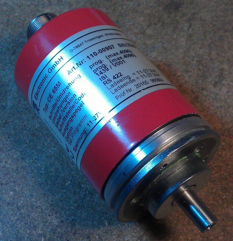

      I have had this lying around for a five years now and have yet to find a use for it!
      Its a programmable absolute encoder which gives 4096 pulses per revolution, and, counts to 4096 rotations. If I fitted a rubber tired wheel with a circumference of 1m I could accurately measure distances up to 4km. Thing is, I don't think I will ever need to do that!
      Anybody got any suggestions as to what practical purpose I could put it to in the workshop

        Has 0.25mm resolution over 4km (with 300mm wheel)

          A GREAT manual pulse generator for your CNC mill or lathe!

              Very high-resolution Indexing for a Rotary Table or Dividing Head ?

                You could connect it to a leadscrew on a machine to give a position readout. (I used this method for my first attempt at fitting a DRO to my milling machine.) You could also use it coupled to s DC motor together with the "UHU Servo" design. This would make it behave like a stepper motor but with closed loop feedback.

                  I think the encoder I have would be wrong for MPG, and incremental type would be more appropriate.

                    I have some of the documentation for the encoder but had not seen the one you linked to, so thanks. As you suggest it would make a very high resolution indexer, coupling it to a rotary table is the tricky bit though and any gearing is likely to degrade the potential accuracy. The fact that it is an absolute device would not really be any advantage and because its output signals is serial (RS422) it needs a PC or microcontroller so starts getting a bit involved (for me anyway).

                      I think that rather than coupling it to the leadscrew it would be better to fit a small drum to the shaft and convert it to a 'wire encoder'. Keeping it free of swarf is the main problem.

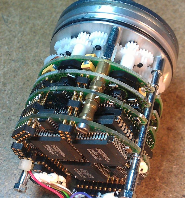

                                encoder internals.jpgNeil
                                Directly coupling the encoder to the axis would give the results you showed but I would not think that is how its normally done. Unless you are on top of a mountain you wont use anywhere near even half of one revolution of the encoder. Presumably encoders when used would be on the shaft of a highly geared drive motor, Correctly geared the encoder I have would resolve to 2-1/2 hundredths of a second.
                                Photographs would still be blurred as I assume long exposures are the norm.
                                If you are taking pictures whilst a telescope is tracking under power is the speed constant (once calibrated) or is it servo controlled in some way from the object being imaged?
