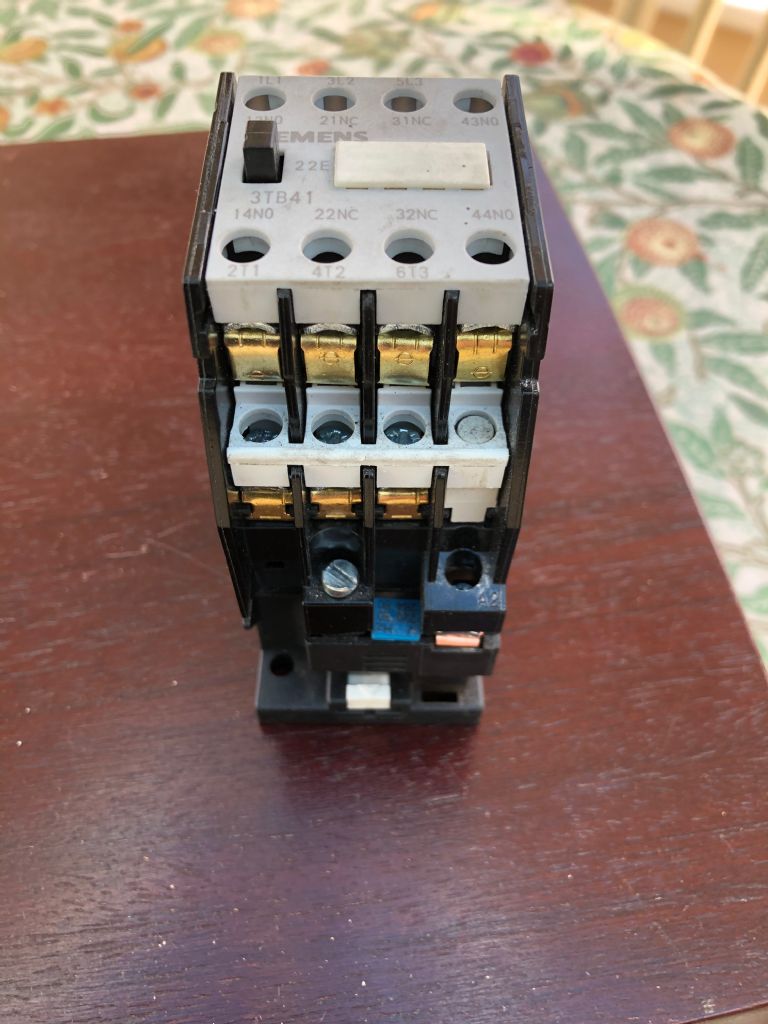

                    #558421
                    Paul M
                      @paulm98238
                      I have a 250V and had a problem with intermittent starting, juddering and suddenly stopping. It turned out to be the contactor block. If you do take a look at it, make sure you photo the wiring and label the wires before removing the block.
                      I got a replacement from Warco under warranty. To purchase they are about £40+.
