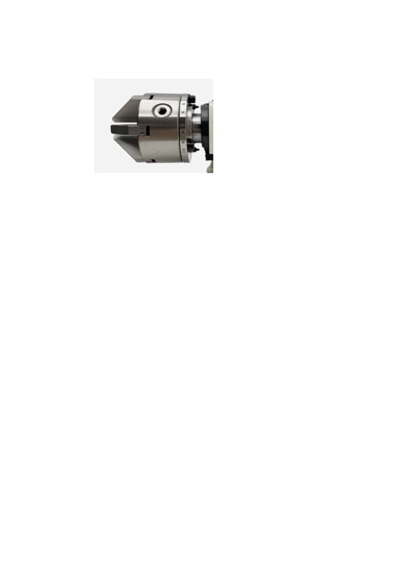

      What do you call this type of chuck please

        Extended jaw chuck/ Grinding chuck???
        #862577
        old mart
          @oldmart
          Looks like six jaws, the normal use is for holding twist drills for grinding. The very long jaws support the drill far better than normal length ones.
            Yes, that’s what it looks like? The full image.
                Please cite or give a link to the source of the image.
                Anyone care to speculate concerning the numbers on the backplate?
                There is an indexing pin, numbers and holes at the handwheel end of the item, but I cannot see the purpose of the ones at the chuck end.
                Sanou make six jaw chucks supplied with long jaws if a chuck alone is required. I have only ever seen that style of jaws on a six jaw chuck.

                    Sorry,  the image was a screen grab from Alixxxxxx.  Jason’s image/supplier is what I was thinking about, but not at that price.

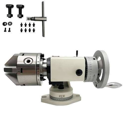

                    On a previous post,
                    GRAVOGRAPH AF3
                    I said that I had acquired what appears to be a ‘D’ bit grinder, and am looking into the possibility of turning it into a Drill bit grinder.  I could use an ER collet chuck perhaps, or look out for a set of collets, but there would be limitations on max/min drill diameters hence search for a small chuck with long nosed jaws.  Perhaps ordinary jaws would give sufficient clearance between wheel and jaws.
                    The Gravograph machine does not allow for putting a rake angle onto a drill bit, but I have a cunning plan whereby the whole head can be advanced by use of a home made cam. I will see what can be done here first.

                    Howard Lewis
                      @howardlewis46836
                      If the base could be mounted on a 31 degree wedge, it could be used to grind drills, by passing across the face of the wheel.
                      My Worden does this in a similar manner, as do other cutter grinders.
                      (Would need careful setting up to the initial Zero clearance angle)
                      Properly ground four facet drills cut well and accurately, so it might be worth the effort to make the fittings for this.

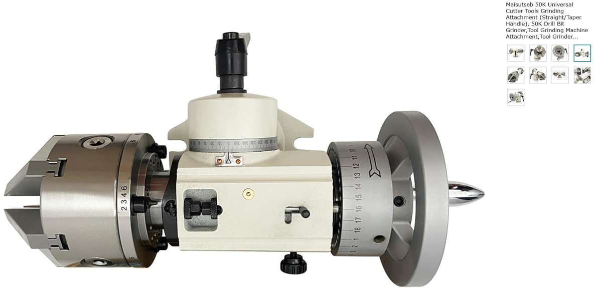

                          A few extra photos on this advert from Amazon, where you can see the cam ring better
                          image_2026-08-29_125304421
                          The description specifically refers to drill grinding; I assume the pegs slide up and down the cam/ramps, and are positioned according to the number of flutes. (I have 3 & 4 flute core drills.)
                          I have a similar, but much simpler item, where there are only two ramps, which are internal.
                          I’ve been looking for something similar, with instructions.
                          No brand name on mine, so it may have been made on a toolroom as a one-off.
                          When I bought it as a speculative purchase, I wondered if it might be designed for making two flute countersink bits.
                          It came without any means to hold a drill/mill, but I’ve temporarily used an adapted ER25 chuck I had spare.
                          I was eventually going to get on of the Sanou K13 II chucks with extended jaws, once I’d perfected how to use the gizmo on ER25.

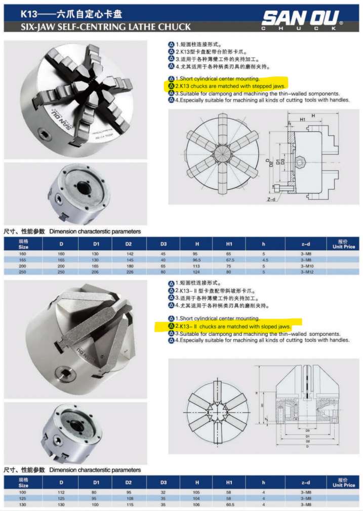

                          DC31k
                            @dc31k
                            On JasonB Said:
                            Have you got an image?
                            Maybe what I wrote was open to misinterpretation. Perhaps it would be more accurate to say that I have not seen a three or four jaw chuck with that style of jaws (because they do not need that style), only six jaw chucks that are used for grinding as you say.
                            The OP was seeking a name for the chuck – I was trying to highlight that whatever the name, it would only be available in a jaw count of 6.
                            As above, the Sanou one is K13, often seen with a -100 suffix, the 100 being the diameter.
                            #862701
                            peak4
                              @peak4
                              As far as Sanou are concerned, I can’t speak for other makers, it seems that they only make a sloping jaw chuck in 6 jaw SC format.
                              K10~2jaw Self Centring; K11~3 jaw SC; K12~4Jaw Self Centring; K13~6 Jaw SC
                              Hence in my previous post I mentioned K13 II, where the II refers to the sloping jaw variant, which looks like it’s only available in 6 jaw SC
                              The lathe chuck catalogue is HERE, N.B. that’s a direct link to a PDF download, see P32
