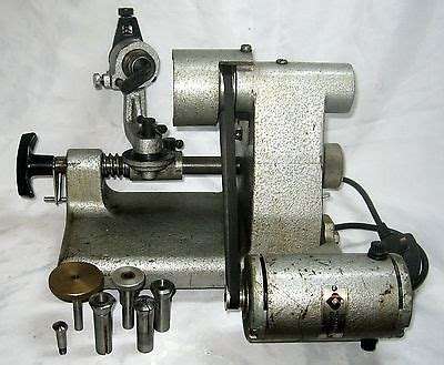

      A bit of an impulse buy at 20€ at local car boot sale.  It looked like a high end drill sharpener, but turns out to be an engraving tool bit sharpener. I only have a single 4mm collet for it, but max diameter through the head may be 9mm.
      Engraving bits don’t seem to have helixes, so perhaps not possible to grind drills on it.
      Any one have knowledge of this machine (Gravograph FRANCE model AF3)  company still in existence and making similar models under a slightly different name. Gravotech.com.

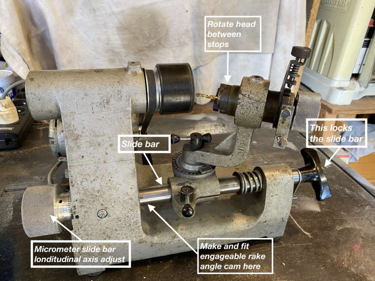

              They say a picture explains all. So my thinking is that the drill bit is brought up to the face of the grinding wheel, and the initial point angle is cut by setting the point angle 118/2 degree and rotating the head, first one flank and then the second.
              Once this is done, the cam would be engaged on the slide bar (Cam not shown in photo as I haven’t made it yet), the handle on the RHS released and the rake angle ground. Note the slide bar is spring loaded and the longitudinal adjustment made via the knob on LH end of slide bar.
              Howard Lewis mentioned a wedge of 31 degrees – would this be the slope of the face of the cam ??
              Open to questions, ideas
              Further explanations
              Bob

                      Bob,
                      You have PMs.
                      On your machine, you would set the drill with the lip horizontal, and then swivel the holder by 59 degrees to the wheel, to produce the 118 degree point angle.
                      The problem is going to be to raise the drill by 30 degrees for the secondary clearance, and then for the 10 primary clearance angle.
                      To do this the collet holding the drill needs to be set at those angles.  Maybe, by setting the rotational stops  some form of clearance can be set..
                      This will produce clearance angles, but I am not sure that they would be parallel to the cutting edge of the lip. So possibly not a four facet grind as we normally know it.
                      To produce equal length lips the in feed will need to set carefully each time, to the same micrometer setting, to ensure that the drill will give a hole that is accurately sized.
                      I can only suggest a “suck it and see” approach.
                      You may end up with a drill which has clearance, and cuts, but not a four facet ground one.

                      Howard Lewis
                        @howardlewis46836
                        Got that wrong!
                        Set at 31 degrees to the wheel, for a 118 degree point angle. 59 is the angle of metal left to grind.

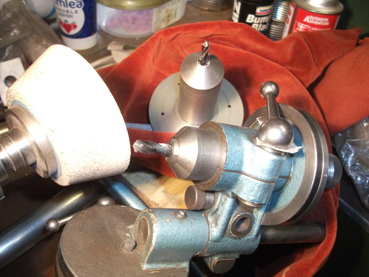

                        John P
                          @johnp77052
                          cone relief
                          Looking at the picture diagram of your intended drill grinding, the
                          drill is set up relative to the grinding wheel the cam that you
                          propose on the slide bar would just advance
                          the drill towards the grinding wheel and just make it shorter.
                          There is some provision made on the Quorn to regrind
                          broken centre drills and is refered to in his book on the Quorn
                          on page 117 ,the photo seen here is almost identical the the
                          photo in the book in fig 92 and only works because the grinding
                          is not all the way to the centre of the work.The new tip is not
                          ground but emerges as the larger cone is ground back to form
                          a new cutting edge ,the new tip needs to be re ground i use a
                          4 facet form. As you can see in the photo the cam is on the
                          work shaft as the drill rotates it moves forward into the grinding
                          wheel

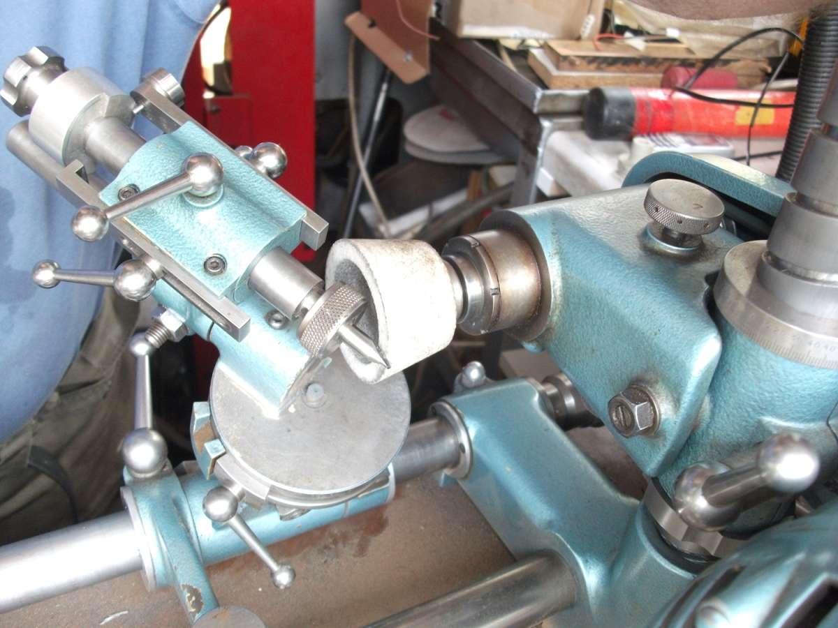

                          D H Chaddock in his book on the Quorn states the normal
                          drill grinding can not be done and recommends using the
                          4 facet method .Seen here in the photo the base is set to
                          31 deg ,the drill is pointing up at 10 deg for the initial grind
                          and set at 25 deg up and ground until the lines intersect
                          at the point.
                          I think you would have to make similar type of work holding
                          base to the Quorn to be able to do what you want.
