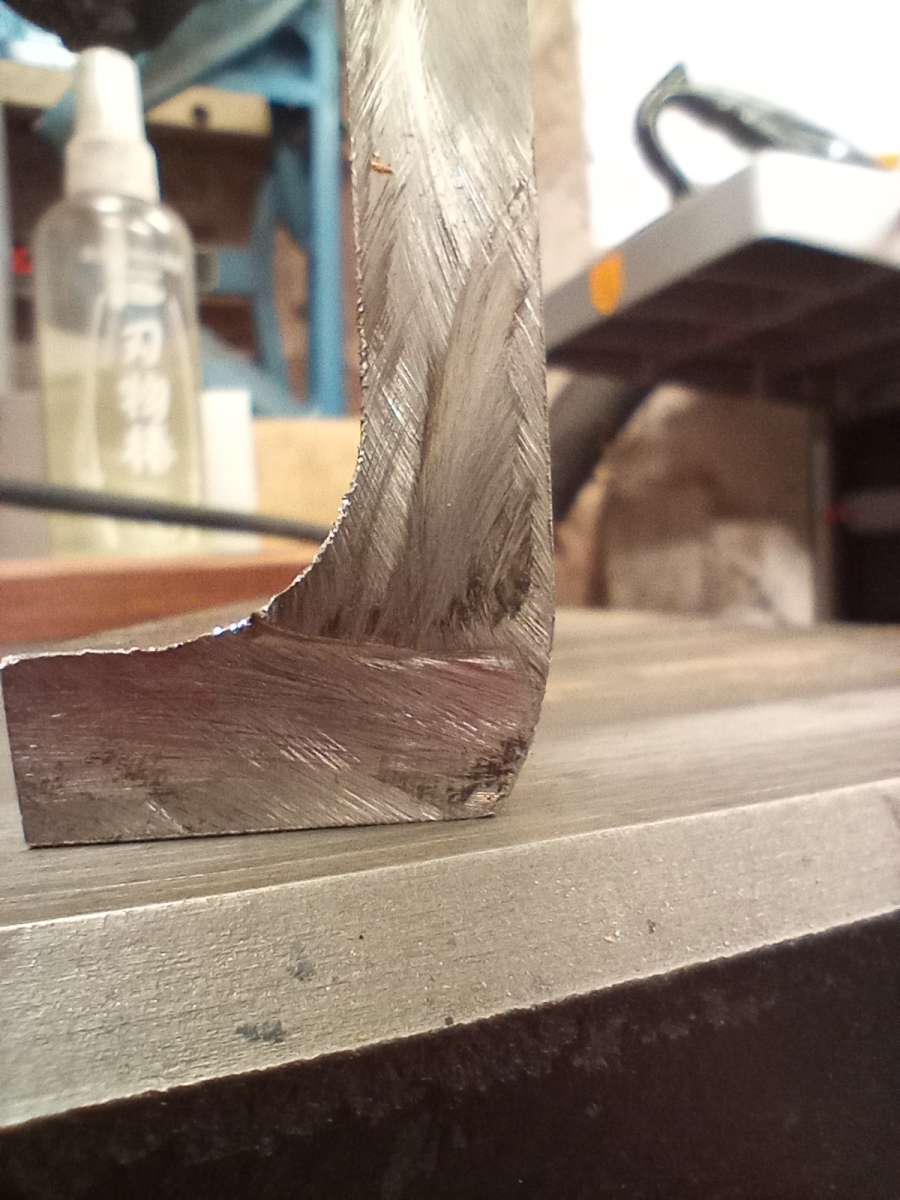

      I started a Duclos Odds ‘n Ends engine but quickly ran into problems with the steel angle. I went to collect a length of 75x75x10 and didn’t look to closely but when I got it back theres an unequal heavy radius on the corner. I cut the pieces anyhow, but when I checked, the cylinder block screws break out of the edge of the radius. I suppose a heavy fillet of JB weld would disguise this, but it isn’t an entirely satisfactory solution.
      Also, the angle isn’t flat across the face – its quite convex which I wasn’t expecting.
      Today’s mission is to locate some angle with a square corner. The problem is that when calling the stockholders you get through to the office and they don’t know what the stock looks like – it’s a measurement and a price. I saw Andrew Whale’ s build and he has some decent material – is there something specific I need to be asking for?

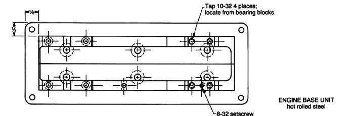

        Not sure why the cylinder block screws should be breaking out they should be well away from the internal fillet. The ones that hold the side plates to the base do break through the fillet on the Duclos drawings but I would be tempted to drill those blind.

        How concave are the sides, The original was 3/8″ material so you have 0.5mm to skim off to flatten them down. Personally I would leave it with the mill finish as the texture will make it look more like a casting. Once the basic 3 parts are joined together you can treat it a sa casting anyway and there is nothing critical that mounts to the sides so just set out from the ctr line.
        You won’t find black bar without an internal fillet and bright angle will be hard to locate if it is even made.
        I have seen others  build it with just flat sides screwed to the base or you could make the “U” from 3 pieces

          Be aware that the two sides of the angle are unlikely to be dead square to each other, either. That might need to be taken into account when machining the top surfaces of those two legs. It might need assembling first and then machining.

            What plans are you working to? Just had a look and the book and he shows how the base screws breaking into the fillet are dealt with so it is not a problem if they do as it does not show on the finished engine.
            And to answer Hoppers point the top and bottom faces both get machined by clamping back to back and milling as a pair. The rest of the feature sare machined once assembled into the basic frame.

              The radius is on the outside corner, hence the screws breaking out. The vertical face measures 9.5mm and will be below 3/8″ when skimmed. The angle measures 10.1mm on one leg and 9.5mm the other. Maybe a quality issue?
              Ideally I’d want to start with 10mm on both legs with a square or lightly radiussed outside corner. I see that some places list square edge or radiussed angle, but they’re out of the area. I’ll go up to the workshop and photograph what I have for furthe opinions.
              #758150
                In that case use the angle with the 9.5mm along the bottom and the 10mm vertical. The bottom face gets skimmed thinner anyway and you will loose some of that external radius.
                At 8-32 or M4 you could probably move the holes in 1mm
                Even if there is an external radius the whole thing gets hidden so nothing to worry about.

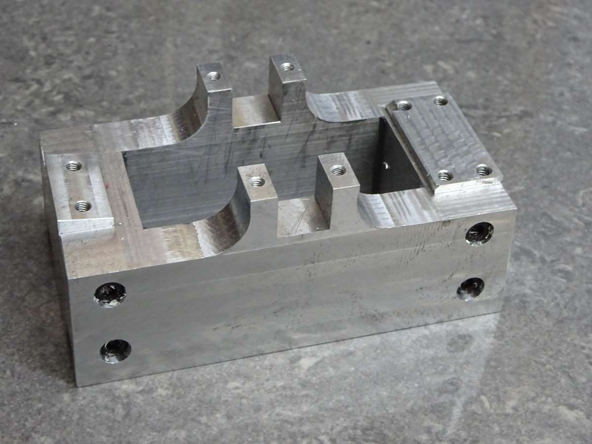

                  This is how it looks;

                    Hot rolled material of any shape is unlikely to be dimensionaly accurate or sometimes even true. Cold rolled may be better but then when you machine it things may change. Good Luck. Noel.

                      Looks like poor quality rolling. Most good quality angle is “sharper” than that. You might try a different supplier, but really you need to look at the material before purchase in today’s world. Bit of JB weld if the area is at all visible might be easier.

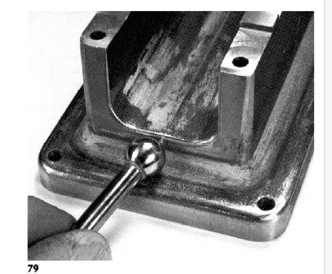

                          It’s a bit of a poor one, maybe end of the roll?
                          But at the end of the day it won’t show once it is all filleted in with Bondo (body filler)

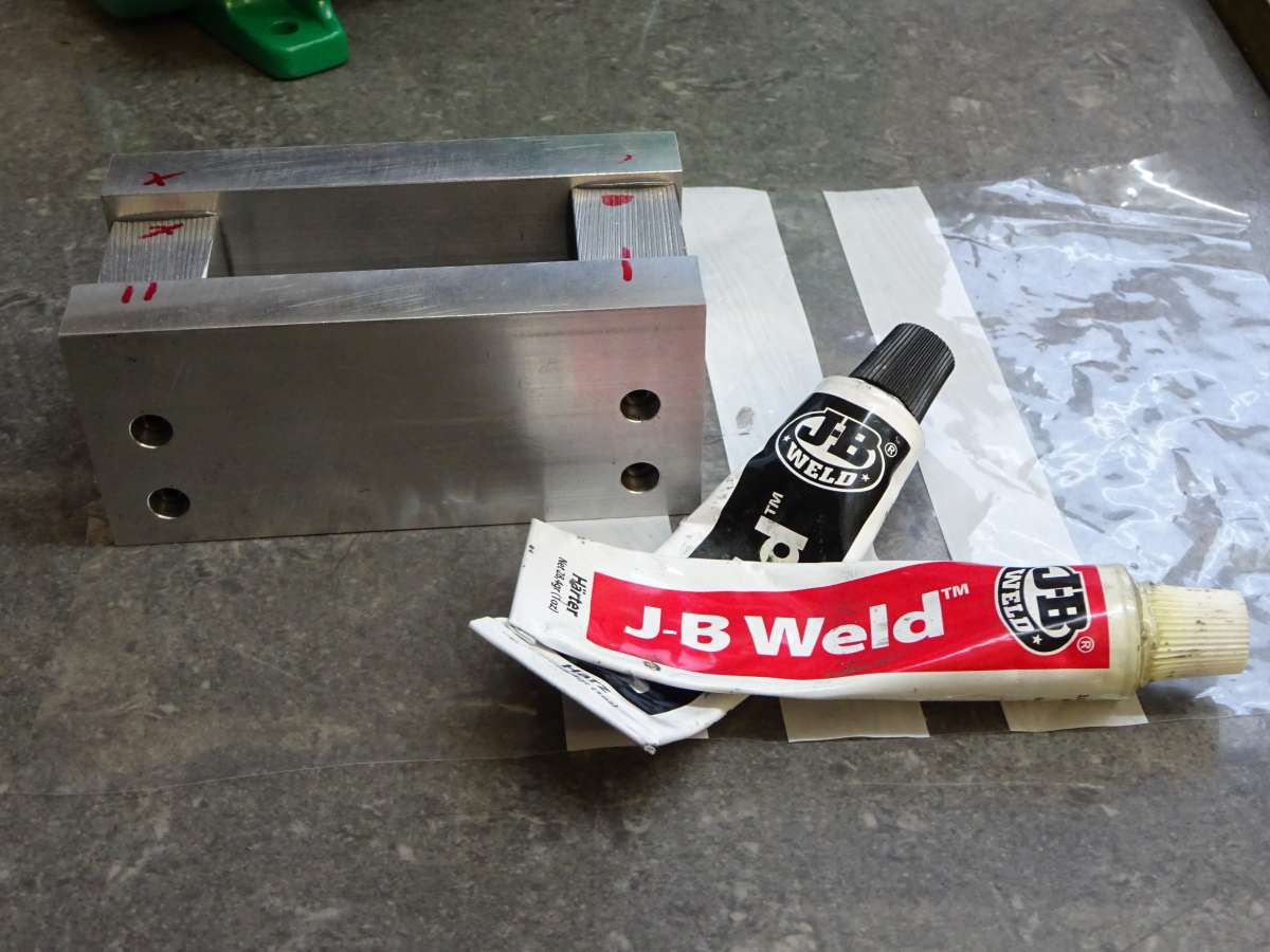

                                It looks like I’ll need to work with what I have, or fabricate my own angle by welding. I rang around and nobody has anything close to 75mm – I’d have to order a 6m length. I never used to have a problem with steel quality or dimensions but about 20 years ago noticed a big shift towards lower standards with hot rolled sections as well as box section.

                                    I’ve tried running three heavy beads of weld along the radius then ground and filed back to give a sharp corner, but just on one piece. It’s too much work and I don’t fancy doing another. It would have been quicker to have welded up the angle from flat.
                                    I cut another piece so that I still have a matching pair with the radius. At the moment I’m inclined to go with what I have then fill afterwards, as I already have the material. If I was starting afresh I would go down the route of a bolted assembly and use BDMS flat as you suggest.
