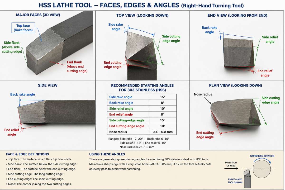

      I’m quite confident with the mechanical process of grinding HSS tools. What’s baffling me is the lack of consistency of naming the various facets of the tool faces, so knowing exactly what angles to grind starts to become a bit of a puzzle. I’ve several books, have looked on other web sites, and none of them use exactly the same terms for the faces.
      In an attempt to get a decent answer for angles for 303 stainless steel I asked ChatGPT. A long text answer and when I asked it to clarify with an illustration of which face was which I got the image below. To my novice eye that looks wrong, anyone care to offer an opinion.
      ChatGPT Image Aug 29, 2026, 09_32_25 AM

          paul1956
            @paul1956
            I was more interested in what people thought of the illustration.
            The bottom right layout looks wrong and the tool ‘back rake’ seems to go the wrong way ?
            More AI slop or am I reading it wrong ?

              Pete Rimmer
                @peterimmer30576
                I would not trust anything in that illustration that shows the direction of rotation as being away from the cutting edge. Go on archive.org and download some old text books and take your info from those.

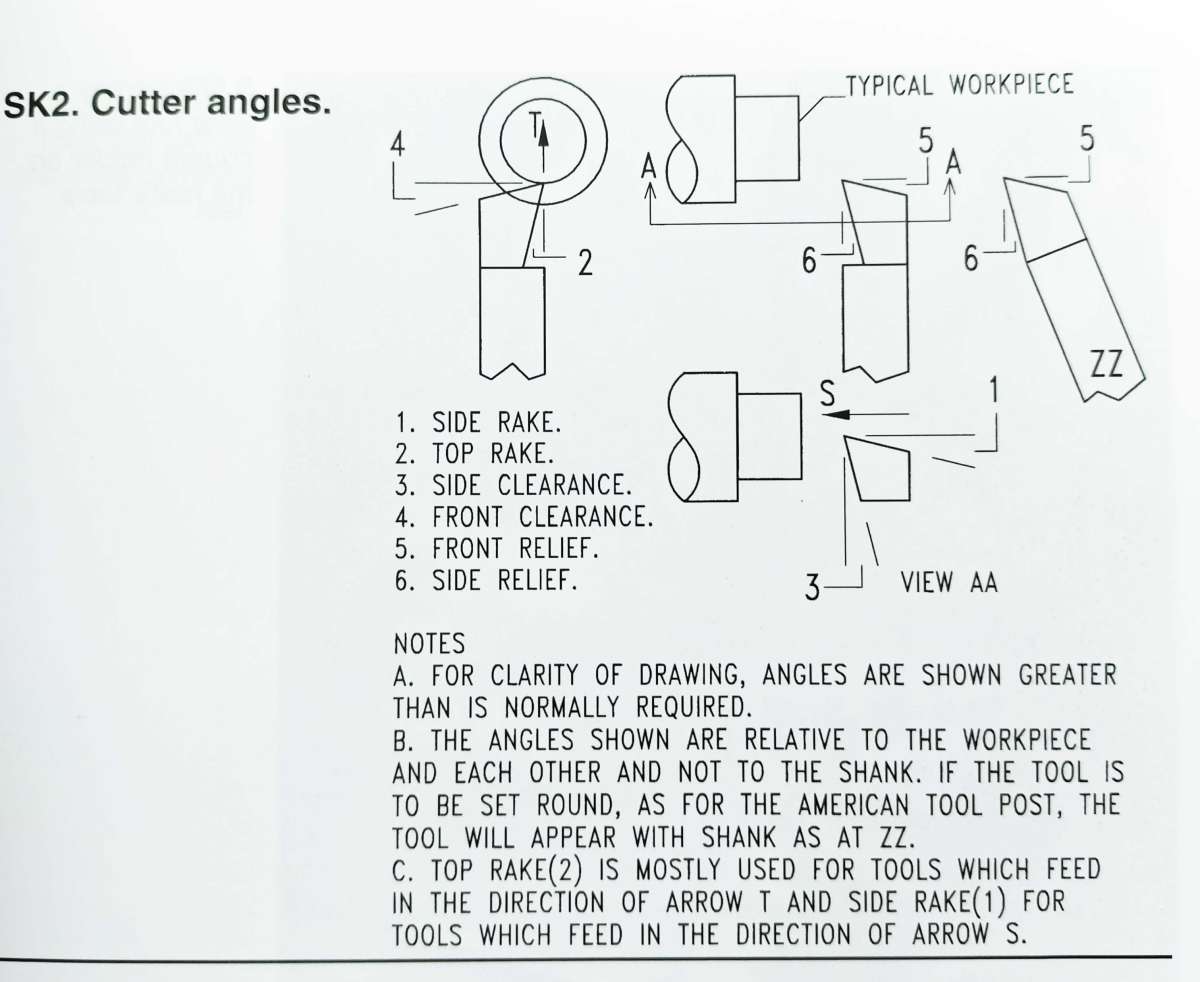

                    AI seems to have tied itself into a knot, it clearly hasn’t read Harold Hall’s “Tool and Cutter Grinding” as part of its Large Language Model.
                    hall angles
                    Rod

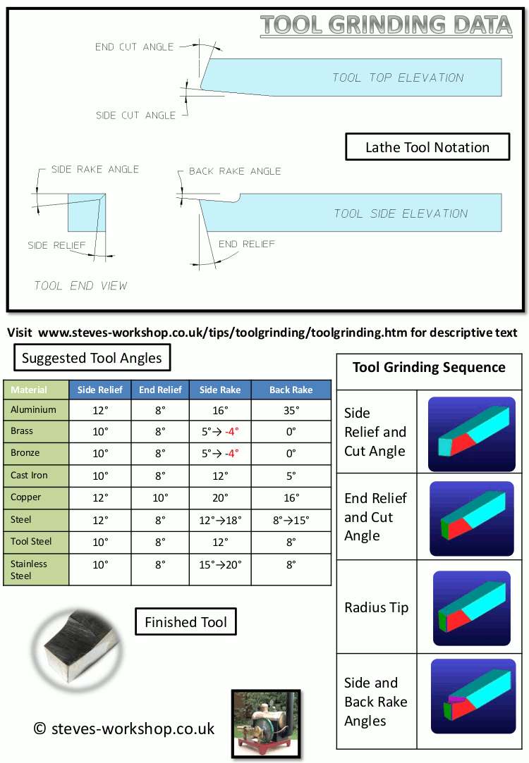

                      Journeyman
                        @journeyman
                        Steve’s Workshop has some useful info on this topic. Including the poster below.
                        toolgrind

                                  jaCK Hobson
                                    @jackhobson50760
                                    Those chat GPT images… some have me confused! I think it gets some right but then starts hallucinating.

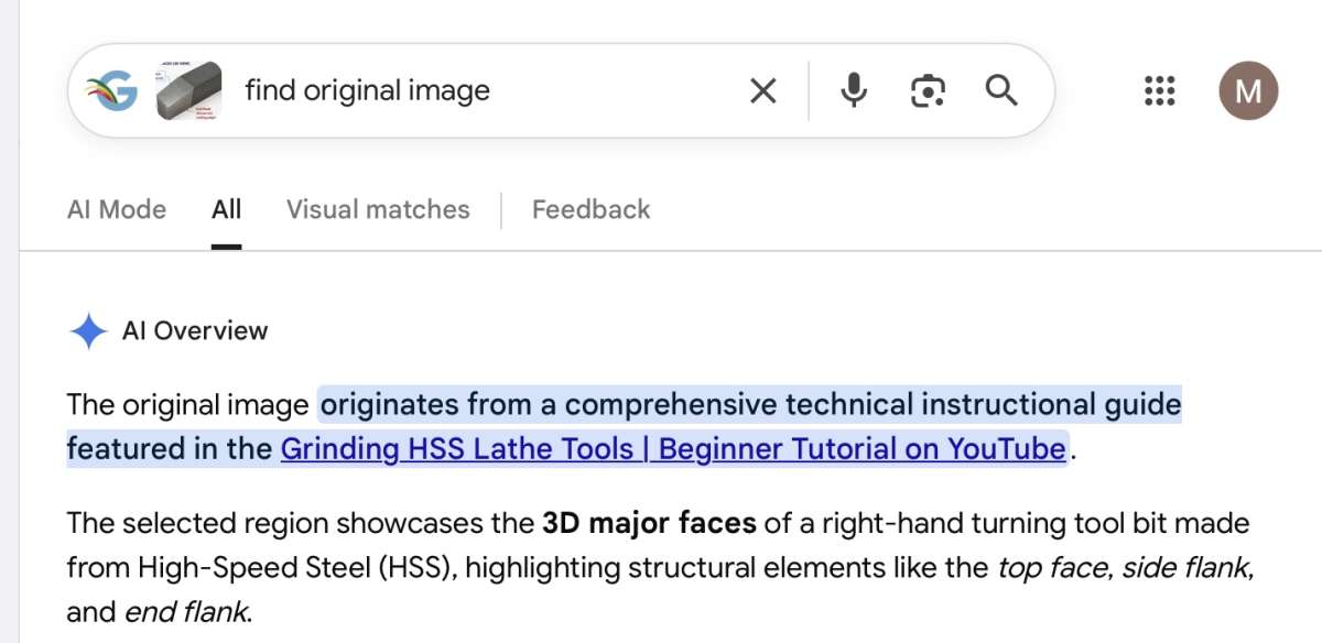

                                      According to Google’s image-search …. That ChatGPT illustration originates in this video:
                                      Can we judge an AI by the company it keeps ? …
                                      IMG_1940.
                                      Presumably linked from the comments …
                                      I watched the whole video, but couldn’t take any more
