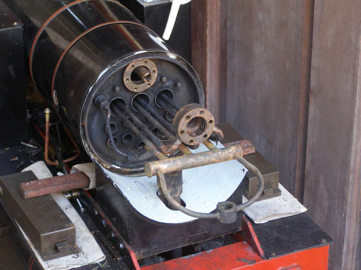

                        1) This used plentiful daylight in the early-evening a few weeks ago, part of recording repairs to that superheater. I waited until the early-evening sun was shining as much into the North-facing door as it would that day. The white primer on the saddle is mainly to aid marking-out for a new slot cover but also gives useful photography contrast. Obviously that cannot be used everywhere!  Late-19C – early-20C engineering manufacturers commonly photographed their wares for publicity, in grey primer as that gave good contrast for the monochrome images.
                        The sunlight illuminates the important area without the glinting on the gloss-black being intrusive.
                        The peculiar white thing is an old soap-dispenser pump I’d used for draining the side-tank, and I failed to spot it so remove it for the photograph.

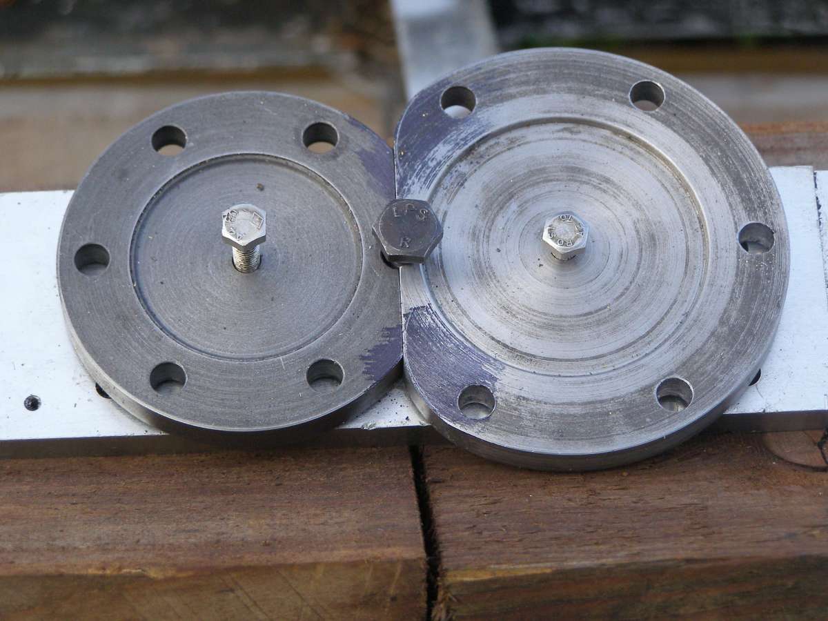

                        2) This also uses daylight outdoors but suffers from bad posing. The cylinder covers are the subject, not the stand, and I should have placed them on a white board or something. ( Oh – they are of different materials, cast-iron and mild-steel!)
                        Cyl covers -Top - 18 Jun 25 B

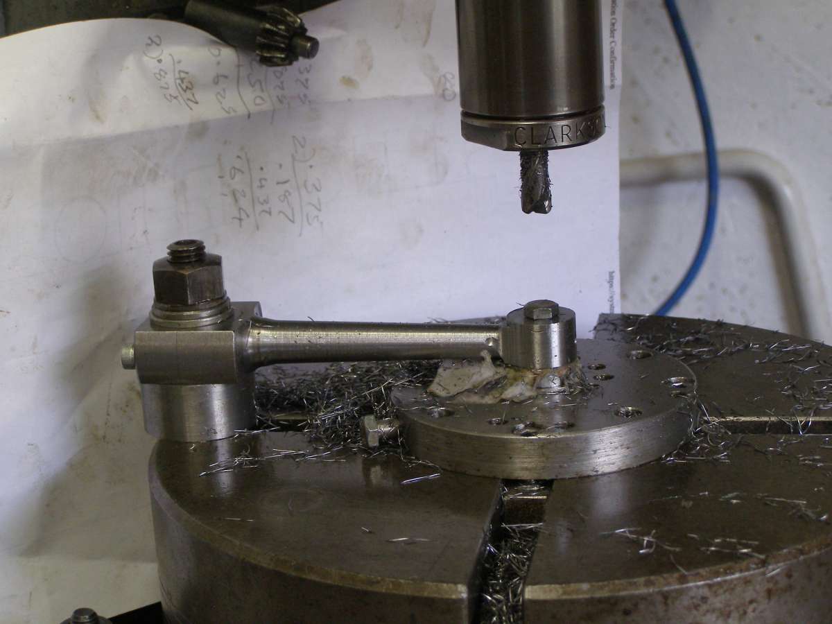

                        3) While indoors: The sheet of paper helps contrast and reduces clutter, as the background would otherwise be the wrinkly black rubber sheet covering the mill’s vertical slideways. No flash, just ambient light and let the camera set itself. I forget if this was in daylight as well as the l.e.d. flourescent strip-light on the low ceiling, or the strip-light only. The window is behind us as we view that scene.
                        I should have moved that chuck key, hooked into a little tool-shelf. And found paper not splattered with arithmetic. (At least it shows I still know my two-times table and sharing sums.)
                        Oops! Spot the over-run mark on the work!
