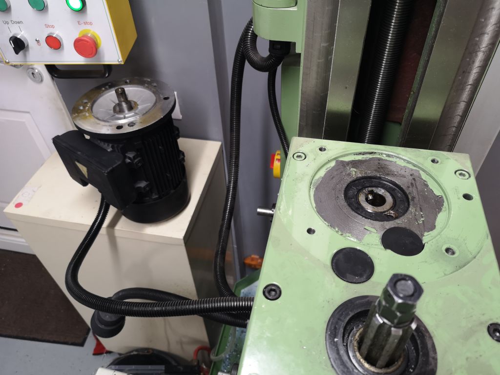

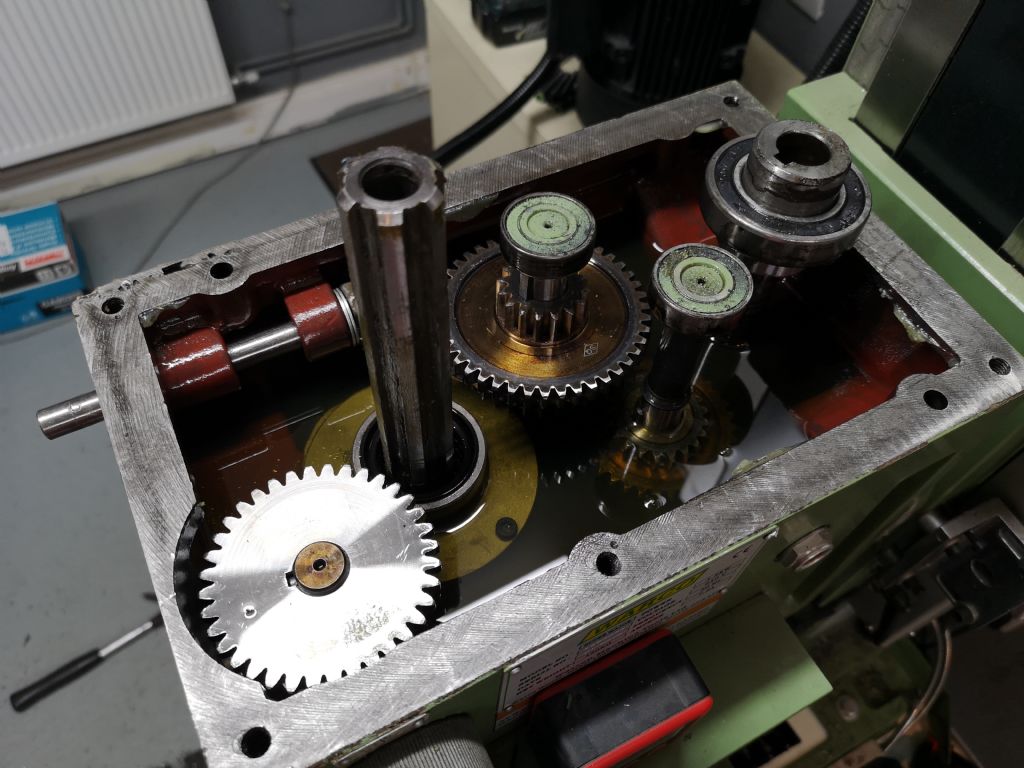

        You know those jobs you wish you had never started!!
        So when pushing the mill, the gears can make a tremendous knocking sound.
        Being the inquisitive type I really wanted to find out what's going on. With a view to identifying any potential issue early and thus prevent any further, potentially irrecoverable, damage.
        On my Harrison M300 lathe, viewing the gearbox is a simple matter of loosening a few cap-head screws and lifting off the top plate.
        The Mill looked a little more involved, but not a lot more (spoiler: I was wrong)!
        Remove face plate and dials:
        Remove the motor:

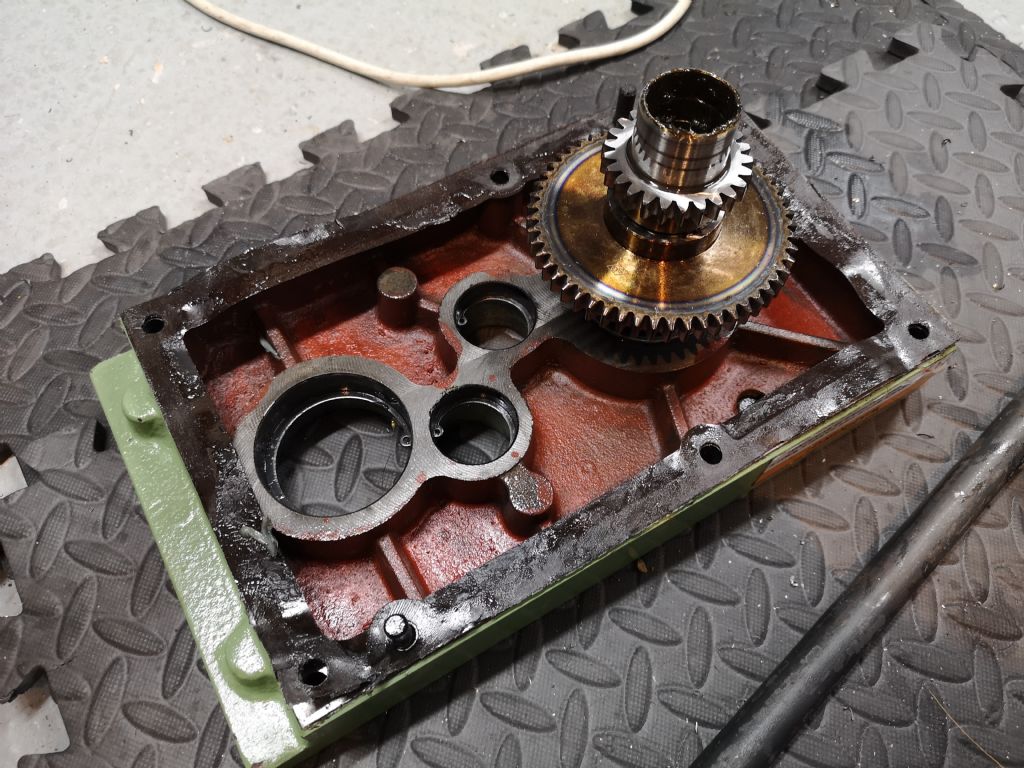

        Remove the 6 cap-heads and simply lift the top plate.
        Ah, balls! Looks like the gears get lifted out with the top plate.
        Have a quick peek inside, then put the plate back on.
        After much; pushing, pulling, bashing (rubber mallet) and screwing (using them as a press, it went back on.
        Put everything back together and forget the the whole thing.

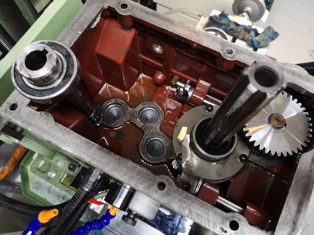

        Ah balls! The 1, 2, 3 gear selector has disengaged !!!
        Re-strip – this time we need to go big. In for a penny …
        Taking another look at the exploded view parts list to locate all of the curclips and bearings.
        Now we play a little game of 'jimmy up the plate and bash down the gear shafts' using pin followers (so as to avoid lifting all the gears out before I've had a good look at them).
        Success:

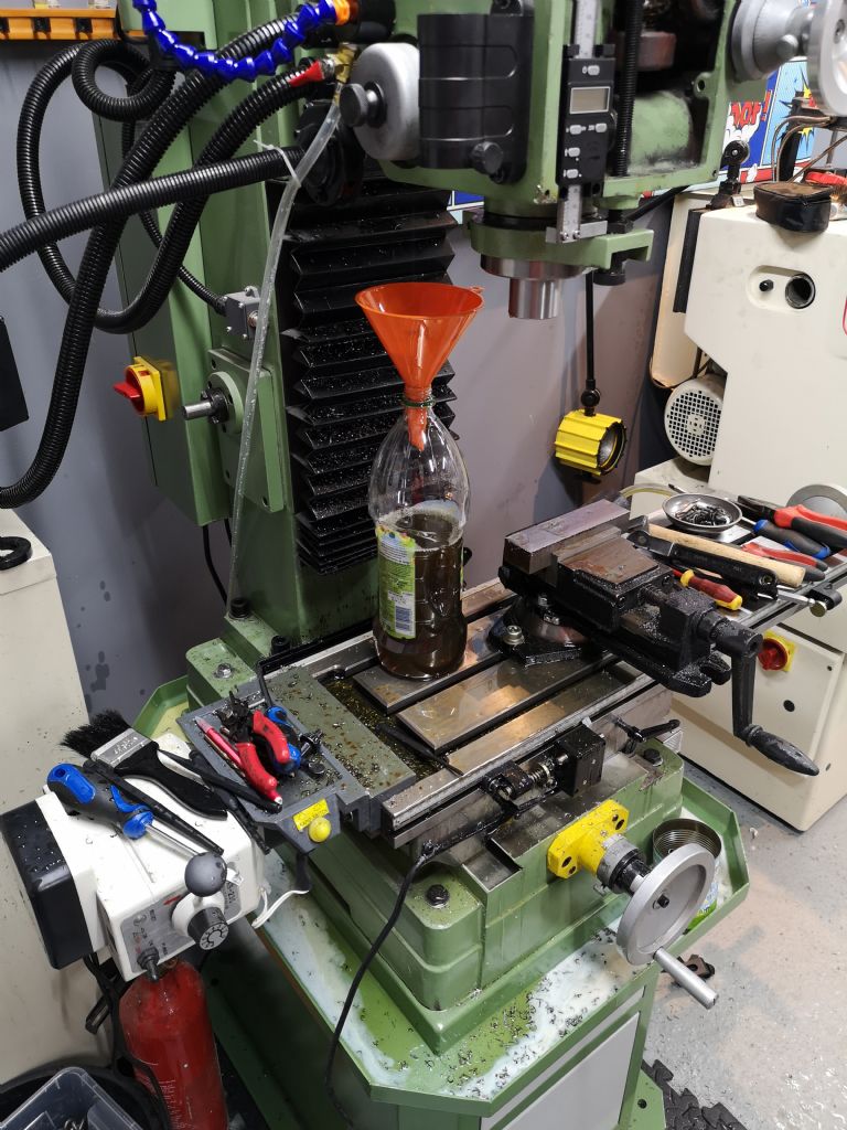

        Now time to drop the oil.
        Ah balls! Dropped the plug and overwhelmed the funnel.
        Oil everywhere. All over the floor and contaminated the cutting fluid system:
        Gears out:
        Nothing appears out of sorts. No worn teeth. Everything looks tight and in good order.

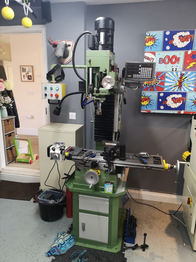

        Time to put it all back together again.
        Also think I found the source of the clattering. There's a plate at the back of the mill head which protects the screw. A little grub screw keeps it in place which was pretty loose:
        Once we're all back together, I'll give it a test by removing it during a heavy cut.
        Fingers crossed!

          That duplex gear just behind the spindle that is moved by the selector arm on yours is the one that was plastic on mine, the one that I replace with a steel one.

            Ah yes, good idea. Steel for the win!

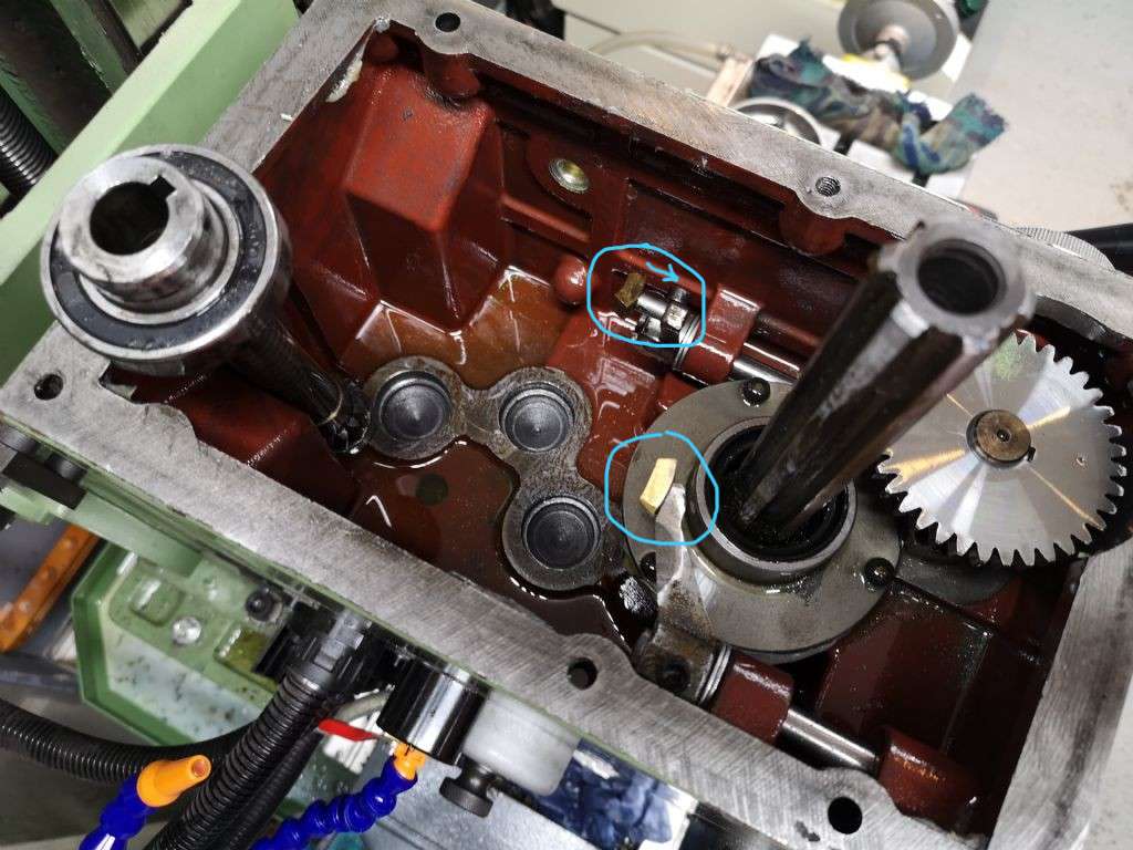

                        Apologies for resurrecting this but do you have any photos of how the speed control levers should be oriented or engage? I lifted my gear set out and drained the oil as one of the brass stops on the levers had come loose but when I replaced the gears and top plate I have no speed controls. Mines a major GH but I suspect theyre all the same
                        Thank you
                        #814312
                        Diogenes
                          @diogenes
                          With reference to the photo, each selector arm has a pin with a loose bronze quadrant on it – these need to be engaged in their dedicated ‘groove’ on the ‘sliding’ element/cluster of each shaft.
                          Holding or ‘fiddling’ them in position whilst you replace the shafts may require some dexterity.
                          Once engaged, the lever spindles should fall into the position they were in before you stripped it.
                          If stripping an unfamiliar gearbox one must explore, record, and reach a full understanding of the relationship of the working parts before each is removed.

                            Thanks, I worked it out in the endacrually but hopefully this works to help someone else in the future.
