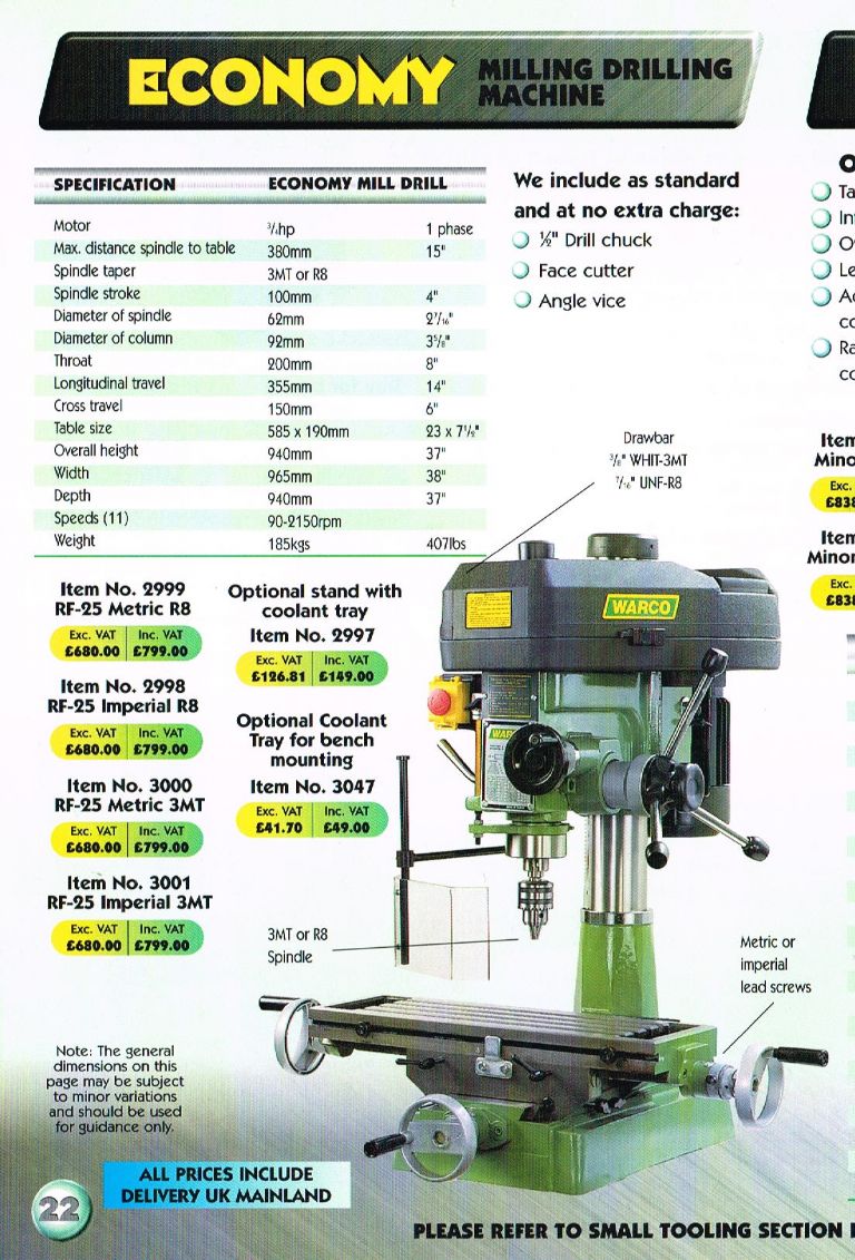

                        #493169
                        Nicholas Farr
                          @nicholasfarr14254
                          Hi Matthew, the prices shown are from a 2002 catalogue, the Major of similar design by comparison at the same time was £1150.00.
                          Regards Nick.

                                  #493242
                                  Matthew Dynes
                                    @matthewdynes73479
                                    Another question.
                                    So the thread on my drawbar is m10. Per the manual my mill is mt3.
                                    Every collet set I look at is mt2 m10 or mt3 m12.
                                    Am I right in thinking that I have some weird combo of mt3 m10 thread drawbar??? So confused.

                                      #493260
                                      DiogenesII
                                        @diogenesii
                                        Posted by Matthew Dynes on 28/08/2020 19:26:02:
                                        Another question.
                                        Matthew, I do beg your pardon, but I have to ask whether you are absolutely sure it is M10 and couldn't possibly be the 3/8 Whitworth as indicated in the specification (from Nicholas) given above? The dimensions are, superficially at least, similar.
                                        3/8 Whit is a common "Imperial" option for 3MT spindle tooling, so finding stuff that fits might become a little easier.
                                        Sincere apologies if there is no doubt..

                                          I am wrong, I tried an M10 nut to no avail. I read the spec again myself and it could be 7/16

                                            DiogenesII
                                              @diogenesii
                                              If you can count the threads-per-inch, 3/8 Whit should be 16, 7/16 Unf will have 20..
                                              The 7/16 Unf will look noticeably "fine" compared with M10, whilst Whit will look to be about the same pitch.
                                              Might be worth seeing if your spindle bore will accept a piece of 12mm bar, and use treaded rod & a nut to make one – it'll be fine, strength-wise – and perhaps offer a greater range of tooling/suppliers.
                                              #493272
                                              Nicholas Farr
                                                @nicholasfarr14254
                                                Hi Matthew, if it's 3MT it will more likely to be 3/8 whit, 7/16 UNF is for an R8 spindle. DiogenesII is correct, threaded rod will be fine if it will fit down. Don't throw the 3/8 one away as there are many arbores that you may want to use that have 3/8 threads.
                                                Regards Nick.
